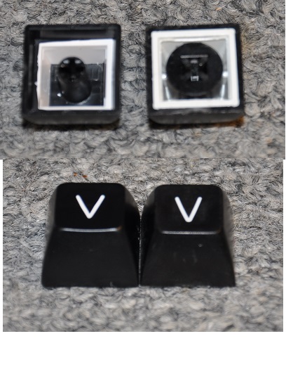

From the bare board, it looks like your replica takes modern Cherry keys, which is wonderful. I'm interested in the details of the keycaps you had made. Were they custom made by Cherry, or elsewhere
The keys were custom made buy signature plastics for me , they are doubleshot keys the same as originals so the legends will not wear cherry does not do doubleshot anymore, it should fit in the case cutout but they sit lower to the board
i looked into the keys from WASD like on the superboard III but thats the best they could do, mind you these are not cheap
original on right
