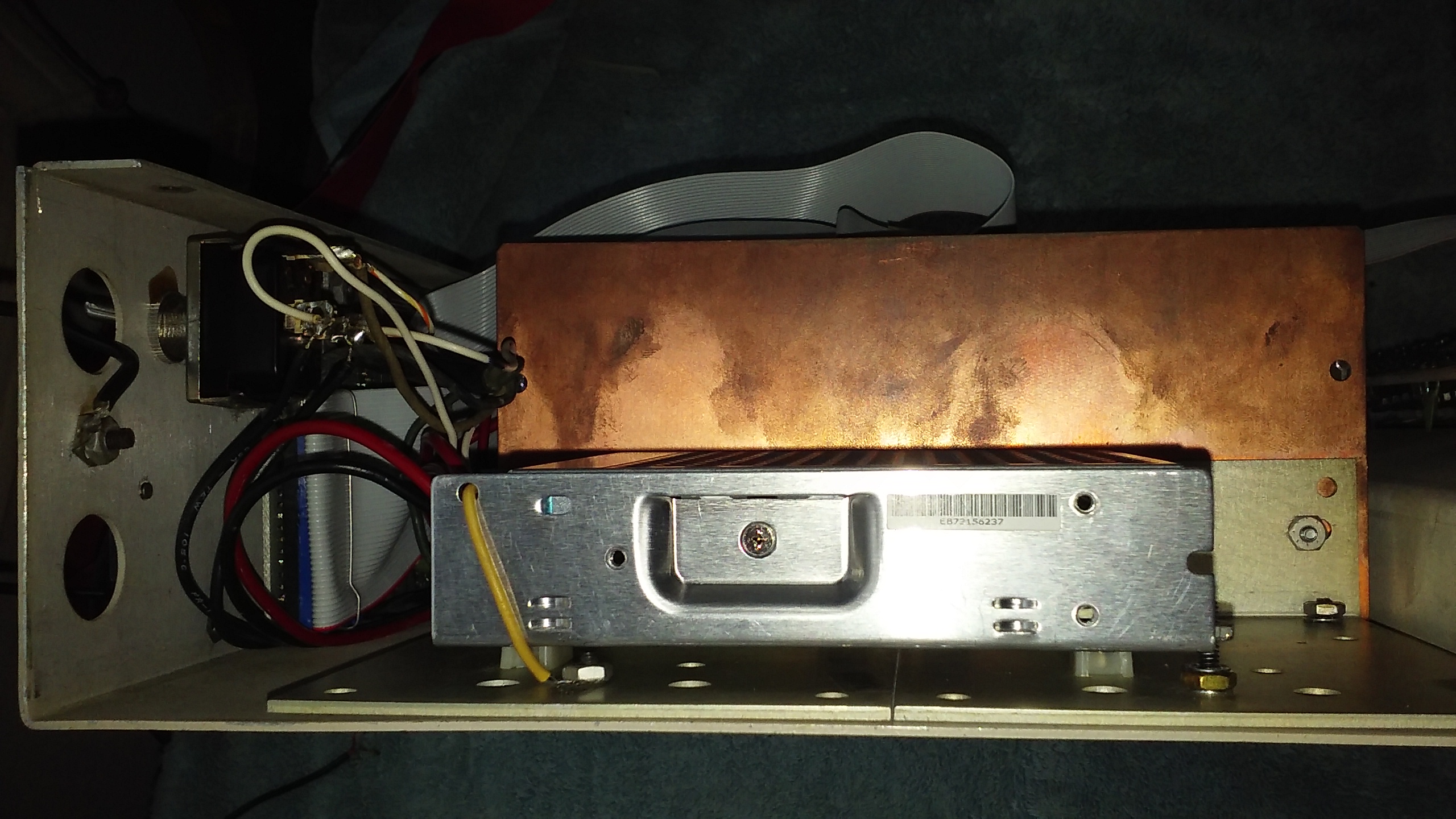

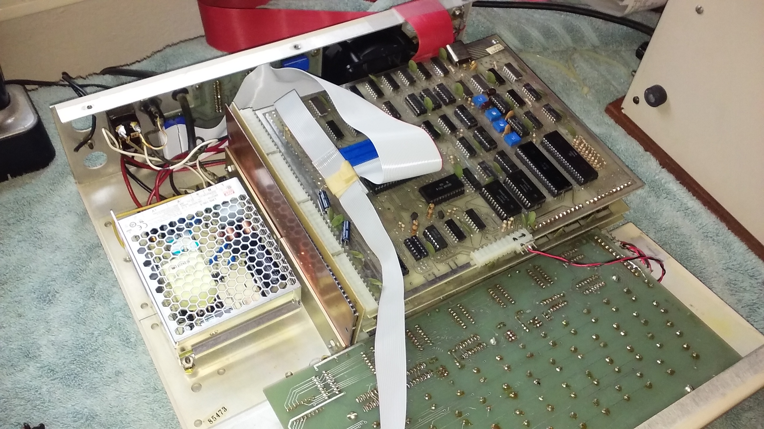

The good news is I finally got some time and I dropped in the 100 watt switched PSU and fired up the machine. It runs sweet and cool, and I think the graphics look better with the new PSU.
The bad news is that when my original PSU blew, Track0 on my 'daily use disk' got corrupted. I tried to get it fixed by using the TRACK0 copy program but didn't have much hope. Looking further into that issue (on my 'Backup, write-protected disk'), I realized that my Track 13 has 8 pages. The program is supposed to be only 5 pages long. So now I'm going to have to figure out how to get Track13 onto a disk. Does anybody have the Assembly Code for what resides on Track 13? I'd be more than willing to type the whole thing in and save it off.

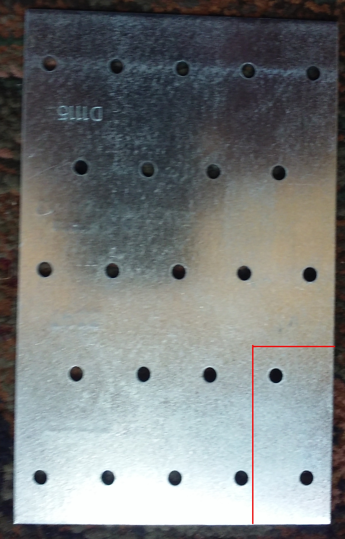

The ugly. I did hook up the new PSU using a longer hex head screw to connect to one tiny piece of the PSU, and even re-arranged the Zip-Lock blocks so the PSU sits tight against them. So there is some air circulation all around the PSU. However, I had to stabilize the PSU with a wire across the connector end of the PSU. I do plan on fixing this with some real 'metal something' to connect from old PSU base to the screw holes in the new PSU.

Hey thanks for all the great photos Andy. Great your finally up and running.

Well, I finally got around to firmly attaching the new PSU. It turns out the Meanwell PSU is a pretty good 'drop in' replacement for the old C4P PSUs. One end of the PSU has a notch in it, to which you can attach one of the existing C4P hex screws to (need to buy a longer hex screw though and an extra nut). Then you can buy a 'post to beam' deck strap, cut it with tin snips (on the red line in a photo below), put a 90 degree bend in it and the holes in the new bracket mount line up perfectly with another existing C4P hex screw and a PSU screw hole . Didn't have to drill any new holes or do any unusual attachment.
Thanks for all the help guys. Now comes the spooky part, I'm slowly going to get up to letting everything go through a 24 hour burn in. I have already used it for 3 hours straight and the top the of C4 is only slightly warm. The floppy disk actually runs warmer.
