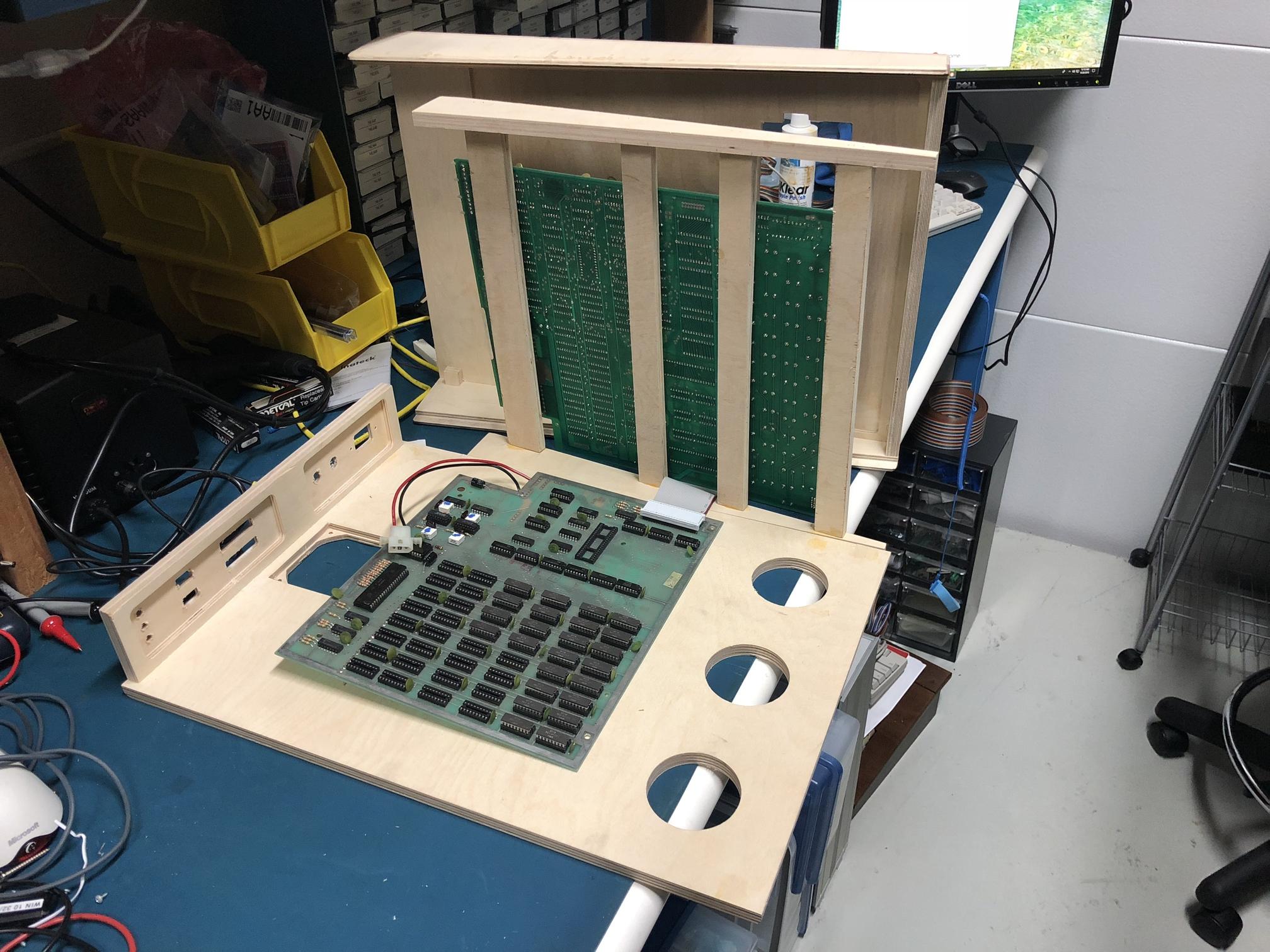

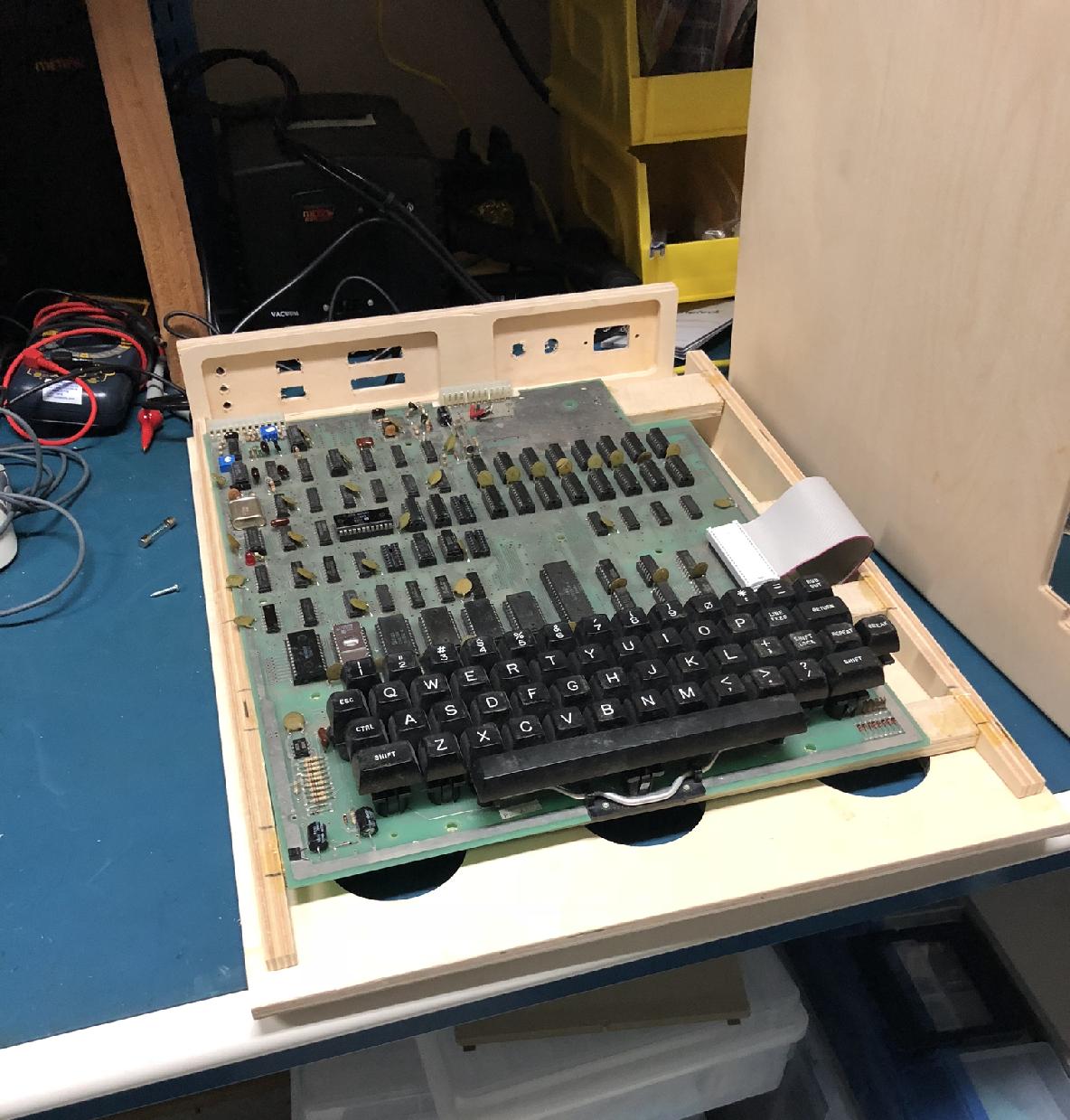

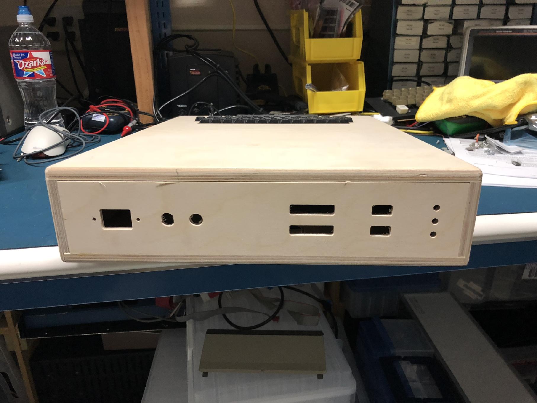

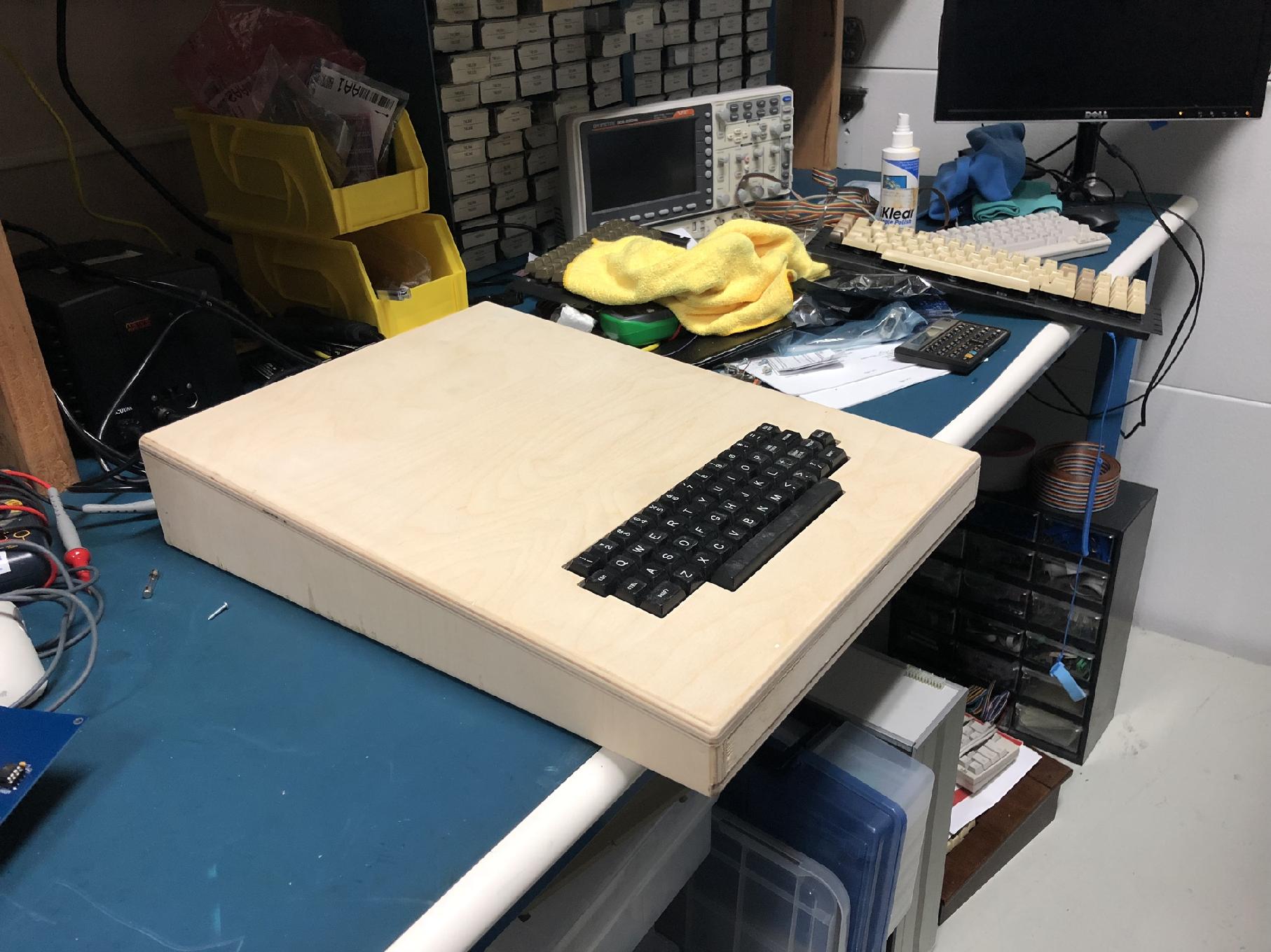

I've been working on some plywood case designs, hoping to come up with some reproducible cases that can be reconfigured for various computers. This is a Superboard 2 prototype. It's still rough and unfinished. The idea is to be able to open up the case by lifting off the top, and be able to access everything, without having to turn the case upside down, etc.
This is a work in progress, almost ready to sand, prime and paint (Gloss Sail Blue).

Right now I'm designing directly in vCarve, which can export to DXF. I'd like to port it all to SolidWorks, or another 3D design program.
The goal is to have a series of reproducible case designs than can be easily adapted to a variety of computers by making simple changes to the design files. All of the cases will aim to present the computer beautifully when the lid is removed, and allow working on the computer boards without much disassembly or flipping the case upside down. (i.e., nothing screwed to the top).
This one is the "wedge". It can be adapted for the Apple 1, Superboard 2, and other single board machines. The height and slope are a compromise between keeping the keyboard low, with small angle, and fitting power supply components in the back. The width can be varied (for example, 15" for OSI, 18" for apple 1), and different keyboard cutouts can be dropped in place.
The wedge requires some of the pieces be cut a little bit larger than the final size, in order to make everything fit once the front once the front and back pieces have been hand-finished to the correct angles. The more square slab-like designs can be cut more precisely, and require less manual woodwork, aside from gluing and finishing.

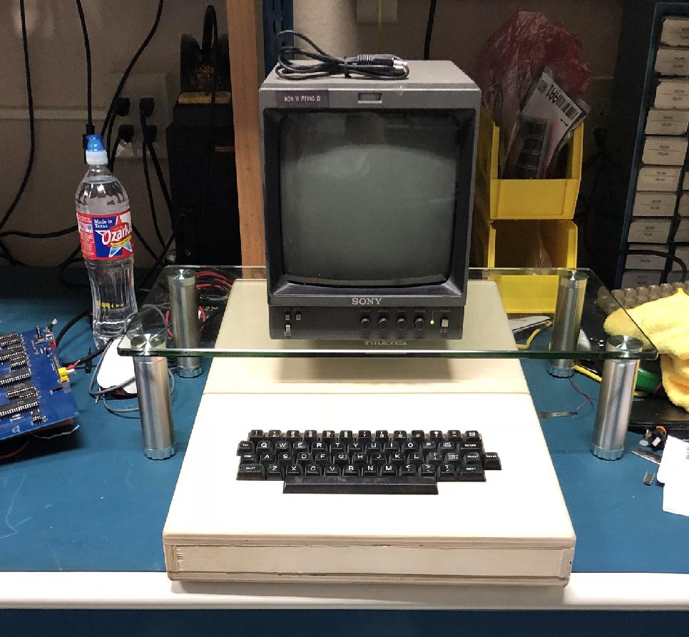

The wedge also requires some way to stack the monitor over the keyboard, since the top is sloped. Personally, I'd rather not place a monitor on the finished surface. But, the options are to use a riser (like in the picture) or to create a "reverse wedge" monitor stand.
