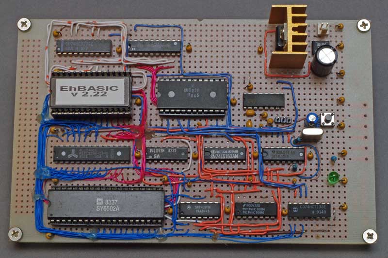

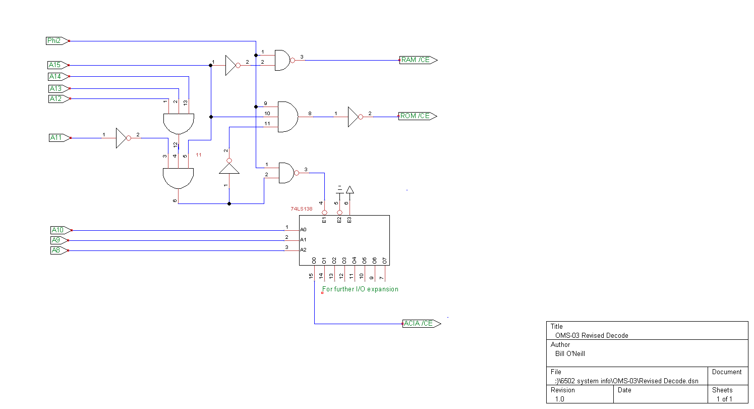

I hand built one of these using point to point wiring back in 2010 or so. I modified the chip select logic to fill in the two gaps in the memory map with ROM. I was able to get it working with Tom Pitman's TINY BASIC, Lee Davidson's EhBASIC and. of course, the UK-101 version of MS BASIC.
Revised Decode.png (12.25 KiB) Viewed 4128 times
The two 20-pin chips on the top of the board are a parallel I/O port I added on.
