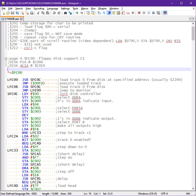

I've made progress getting my S-100 system up and running but not quite there yet. The big news is I found the listings I made for Dos/65, including
the Loader version that I wrote to ROM. This particular listing is for a ROM in my S-100 system but I believe it is the same as what I wrote to the Monitor ROM except of the load address. Attached is the scan of the listing.
DOS-65LoaderInROM.pdf
(405.92 KiB) Downloaded 341 times
Re: Upgrade 610 from 2114 RAM to 6264 8K x 8
I was able to run the pdf through an OCR program and generate text from it.
Besides the starting address, it matches the ROM dump you had earlier except the version number is 2.1 instead of 2.0, and the screen clear was corrected (starts at $D000 instead of $D300).
The attached file can be assembled by A65 or the DOS/65 assembler.
I'll included it below too...
At some point it would be great if you could dump the data from your DOS/65 floppy. I don't think there are any DOS/65 C1P disk dumps floating around out there yet.
Cheers!

Hey, just saw this...
So to decode random 6502 binary I found an interactive 6502 disassembler called WFDIS at https://www.white-flame.com/wfdis/
Basically I load up a binary blob and set WFDis at it at the appropriate starting address. It halts on areas it doesn't execute, but I find the next starting point, highlight the byte and hit SHIFT-A to continue disassembly (or undo if it's garbage). Once I've gone through the main points of the code, I copy it into Notepad++.
I have a custom language definition for 6502 which does syntax coloring which I find makes it easier to read.
In notepad++ I reformat the code, fix the indents, remove spaces before and after "=" as A65 doesn't like those, highlight areas of hex data and insert , and $ and turn them into .BYTE directives. I also change labels into more meaningful words, comment the code etc. Later I check the work with the A65 assembler & compare generated to original ROM.
WFDis doesn't know about OSI, it is more of a PET/CBM disassembler, but it works well enough.
Some of the disassembly comments have built upon previous works by Ed, as he did most of the OSI ROMs years ago. Others come from other OSI users or myself. Rectangular/column cut & paste works well for moving comments between files.
Some of the binary to disassemble gets exported from WinOSI from the debugger, say if I want to disassemble a machine language file stored with a custom loader, or if I want to include system ROMs in the image from a particular configuration.
Notepad++
Notepad++
Attached is the language definition file for 6502 syntax highlighting in Notepad++. Save the XML & Import to user-defined language dialog in np++
Save your file with .asm extension to have it enabled automatically. It can be customized as needed.
