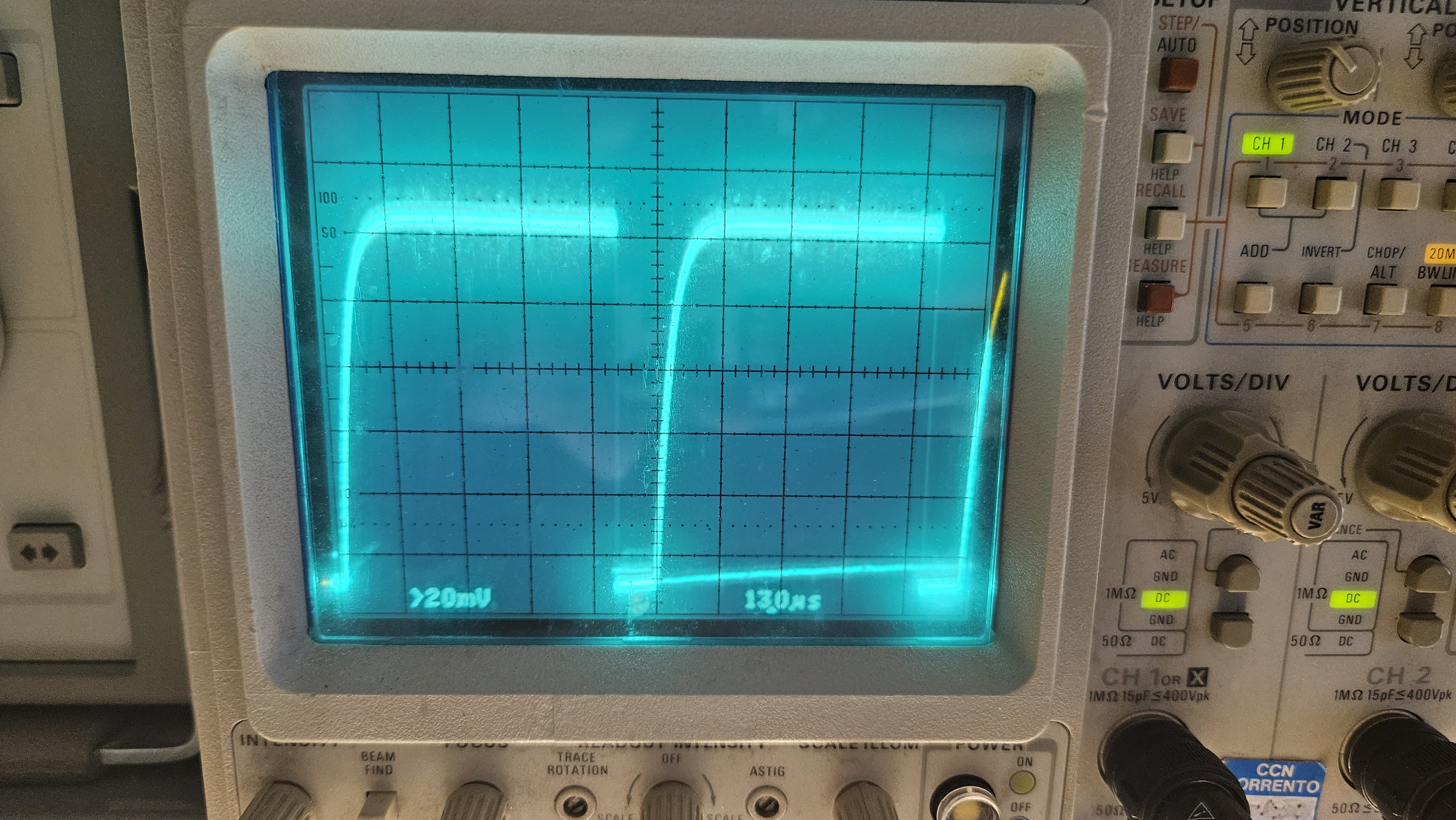

My replica 540B has been gathering dust for too long now. For the past few days when I have had time, I've been examining the signals with my oscilloscope to figure out what's wrong with it.

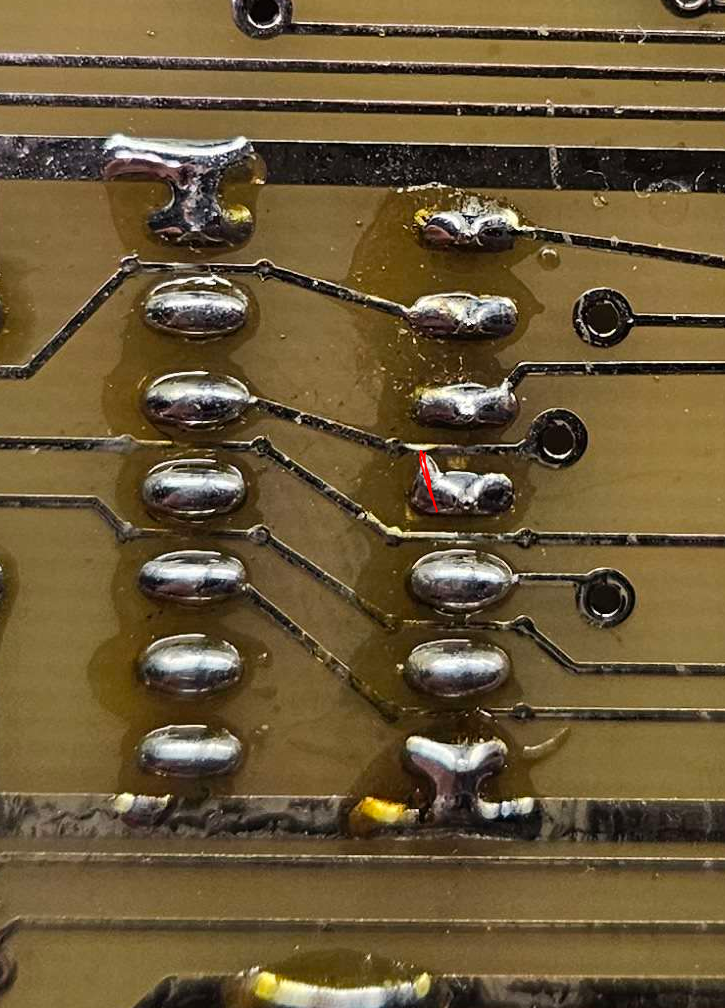

I spotted a solder bridge attaching pin 11 of U4E (the signal known as /COL_CLR) to some other signal that was chronically low. The result was that the output of the NAND gate on pin 11 would never go above 1V, and thus never trigger the master reset on three of the 74LS163s. This cascaded into the END_BLANK signal never triggering, so the signal would be stuck blanking the video forever. The solder bridge is marked in red.
After that was fixed, I started to see more sane signals in a few places, which is promising! I've also noted that adjusting the color phase trimcap is very difficult, it requires alot of force, and just the right screwdriver, and I usually end up capacitively coupling the screwdriver to the trimcap which throws the timing off. I feel like I'm right on the verge of acceptable color, but I can see something on screen finally. It's yellow! However, I'd like to replace that trimcap if possible with something higher quality, and I'm open to suggestions for reputable parts.
The Sam's C4P manual that I should be seeing horizontal sync pulse of 4.7microseconds from U4B pin 12, per NTSC spec. I'm seeing closer to 8microseconds. I'm also seeing a vertical sync pulse on U4A pin 12 of close to 360microseconds rather than the suggested 300. I know it says "approximately" in the manual but my inner broadcast engineer is mad at me. Would you say these values are common for 540B build?
In looking at the video signal output by my board on my oscilloscope, I'd say it's getting closer to sane. My monitor accepts it, but I can't see the color burst or anything approaching a front or back porch on the scope. Sadly I'm not yet seeing anything on screen but a solid color.

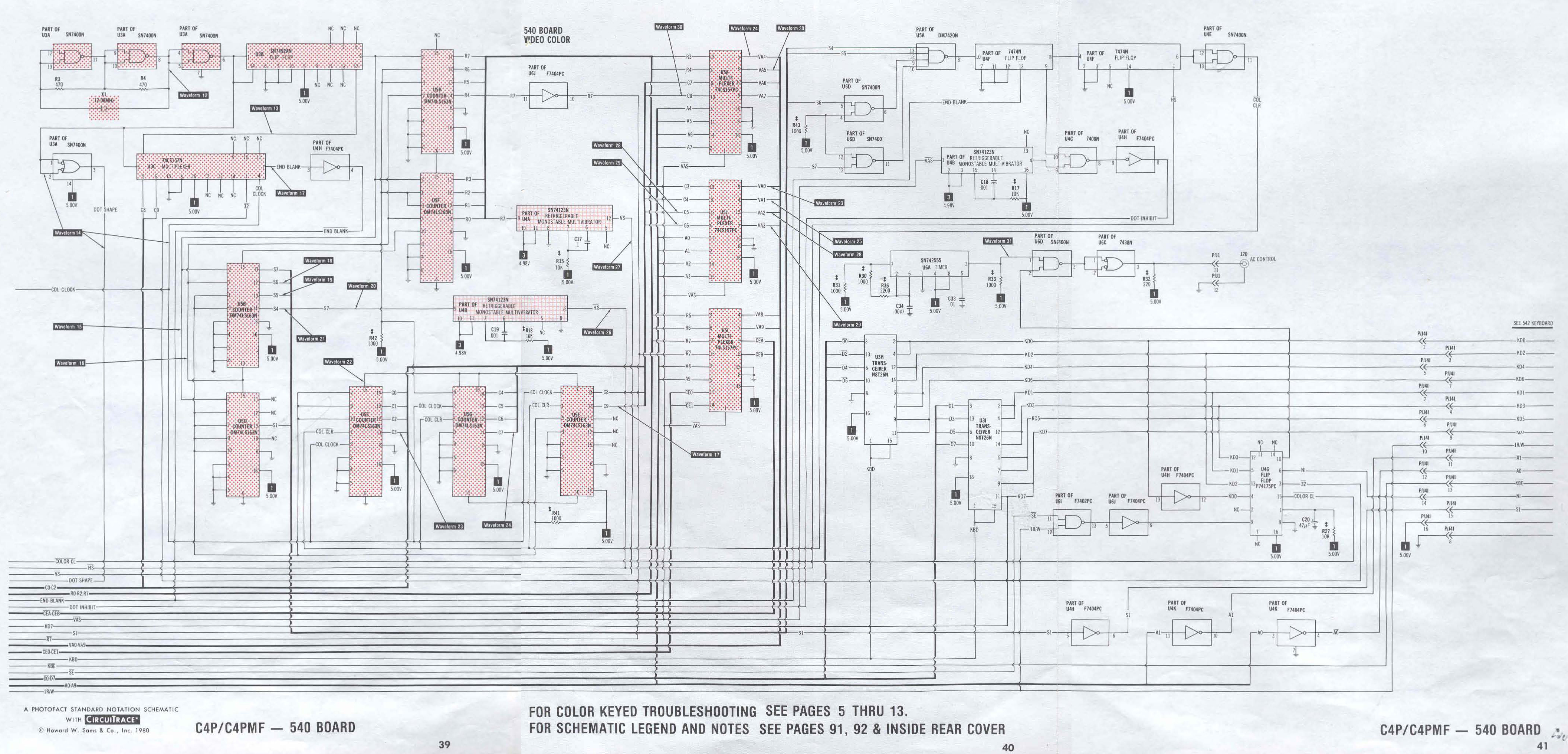

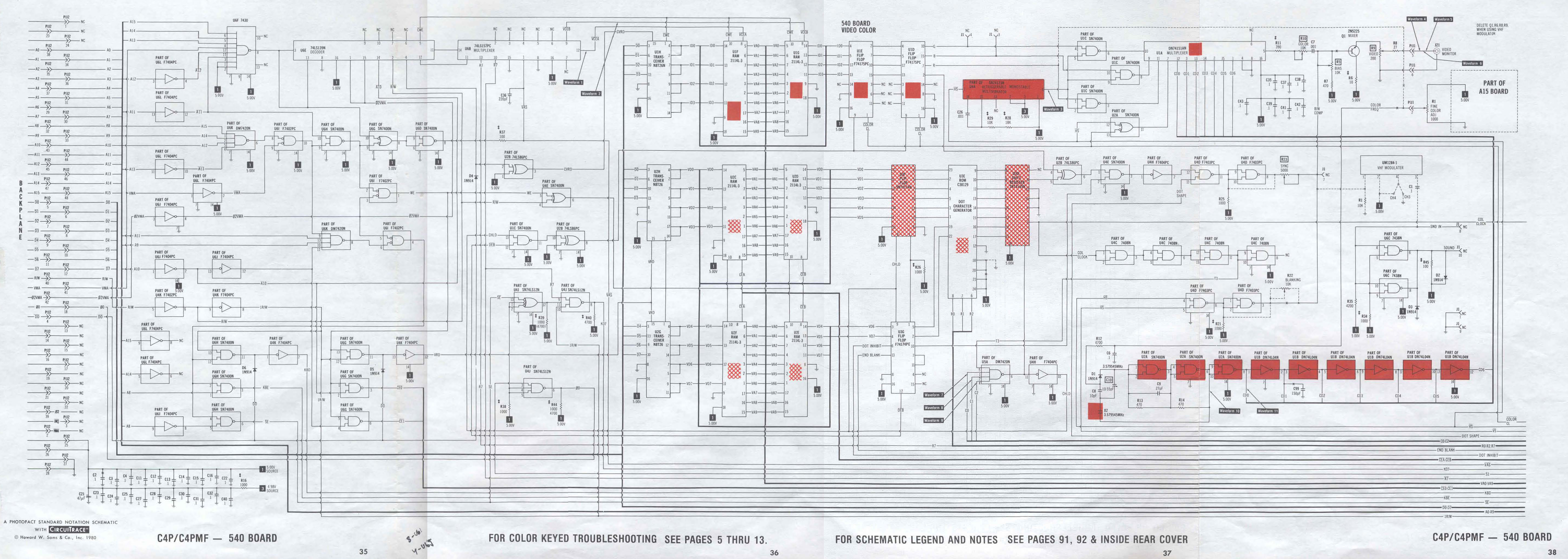

I've also gotten frustrated trying to read the schematics within the Sam's C4P document floating around, as they're split between pages within the PDF. Solution? A little photoshop and the 540B schematics are now glued together into two contiguous pages, making it easier for me to follow signals. I imagine the original physical copy was one bit foldout. Maybe they'll help someone else.
- Sam's 540 Schematic 2.jpg (3.68 MiB) Viewed 13013 times
- Sam's 540 Schematic 1.jpg (4.28 MiB) Viewed 13013 times

I don't know which C4p Sam's manual is floating around, but the 300 dpi and 600 dpi versions on osiweb.org, scanned by Jeff Ferguson, keep each schematic fold-out complete, one per page:
300 DPI Sam's C4P manual
600 DPI Sam's C4P manual

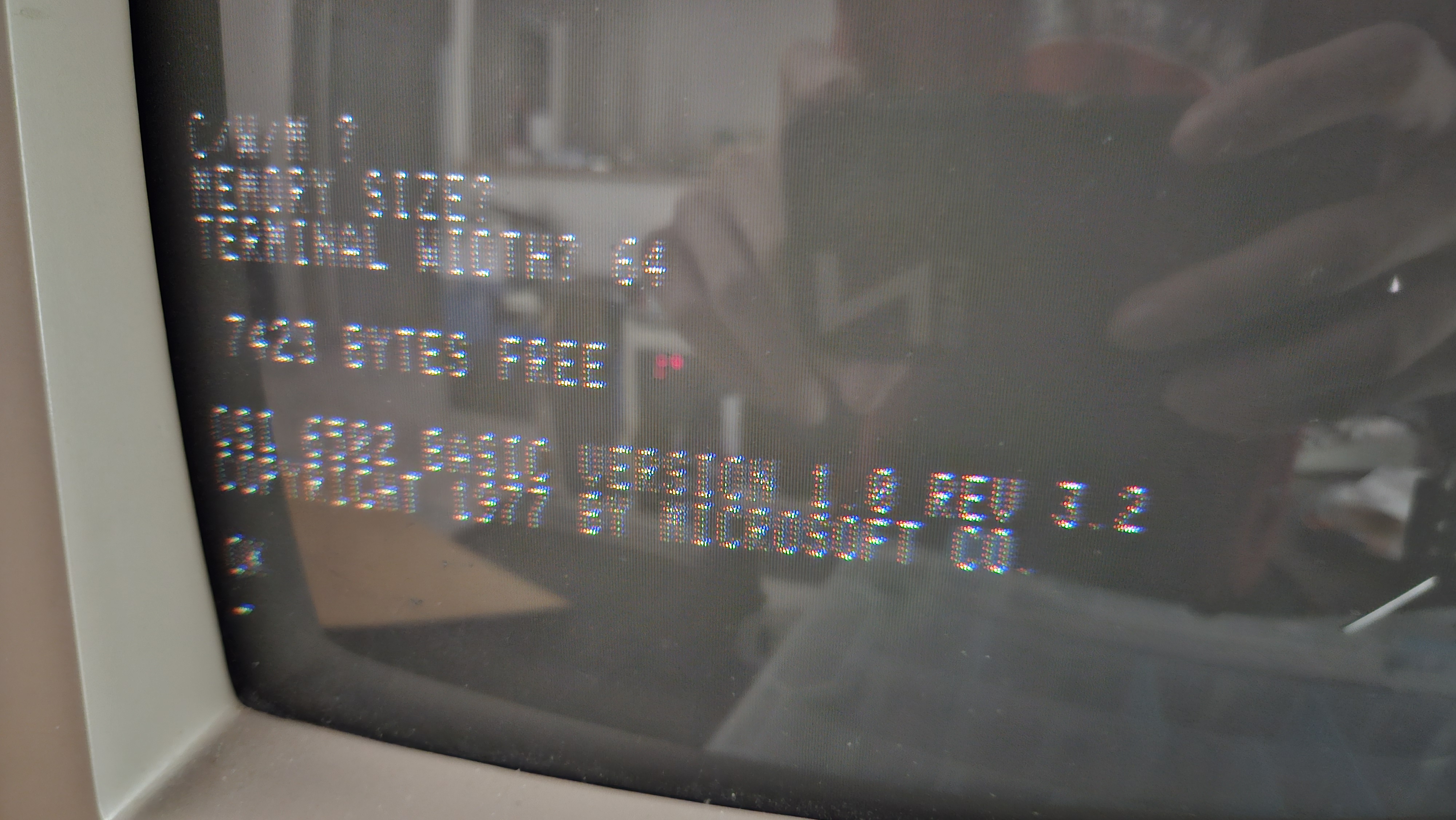

Finally back on this project after... forever. Needed a break from the 400 + 440 stuff.
I was running through signals, trying to debug the 540B replica, and noticed that the video signal lacked any pixel data. Just sync data was present. I was seeing something coming out of the video shift register, getting past XOR gate U2B, but not getting past a NAND gate U4E. The Dot Inhibit signal wasn't leaving U3G, a bank of flip flops, and I couldn't see why. I checked for shorts to ground on pins 10, 7, and 11, no dice. Then I noticed that noting was leaving U3G at all, no flip flop was flipping or flopping, despite having data input and a clock. Master reset was stuck low, but it only goes between two IC's and a pull-up resistor. And then I spotted it: Solder bridge. It was coming from another signal, rather than ground itself, which explained the lack of continuity. That's the second solder bridge I've had on this thing which has tripped up the logic.
I wasn't getting any video initially, until I started tweaking the trimpots and suddenly... GARBAGE ON SCREEN! Then one reset later, the C/W/M? prompt! Sure enough, there was video! Success! I've run a test or two, but so far I haven't been able to get video levels bright enough. I'm going to have to do some scope comparisons to known-good signals and dial things in from there, possibly adjust some resistor values.
So now I get to try programming some color video to see if I got that's working right, and I have no idea how best to test it yet.

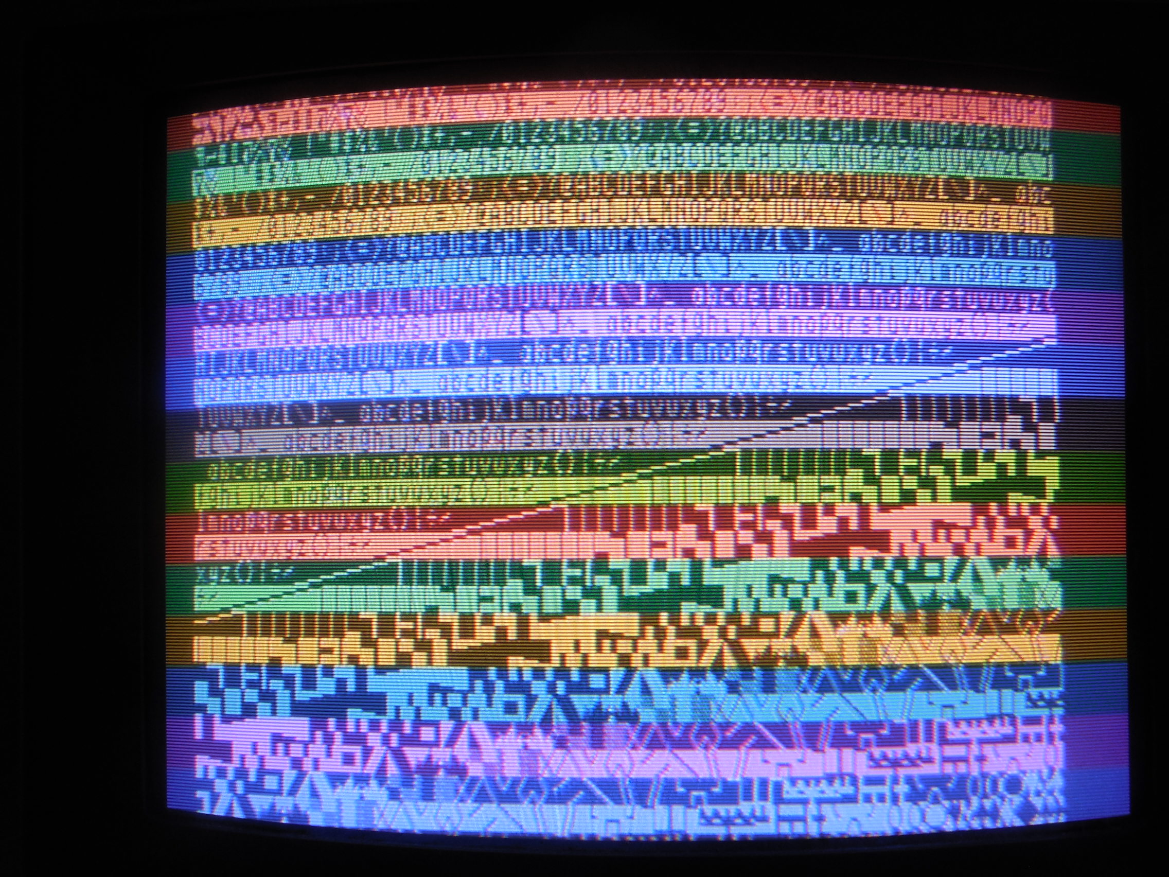

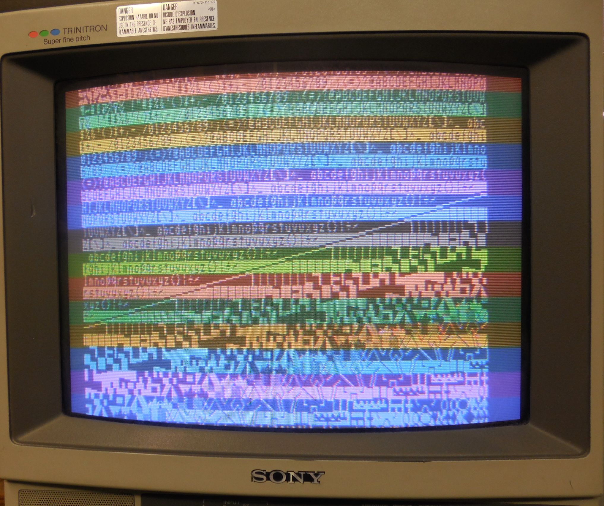

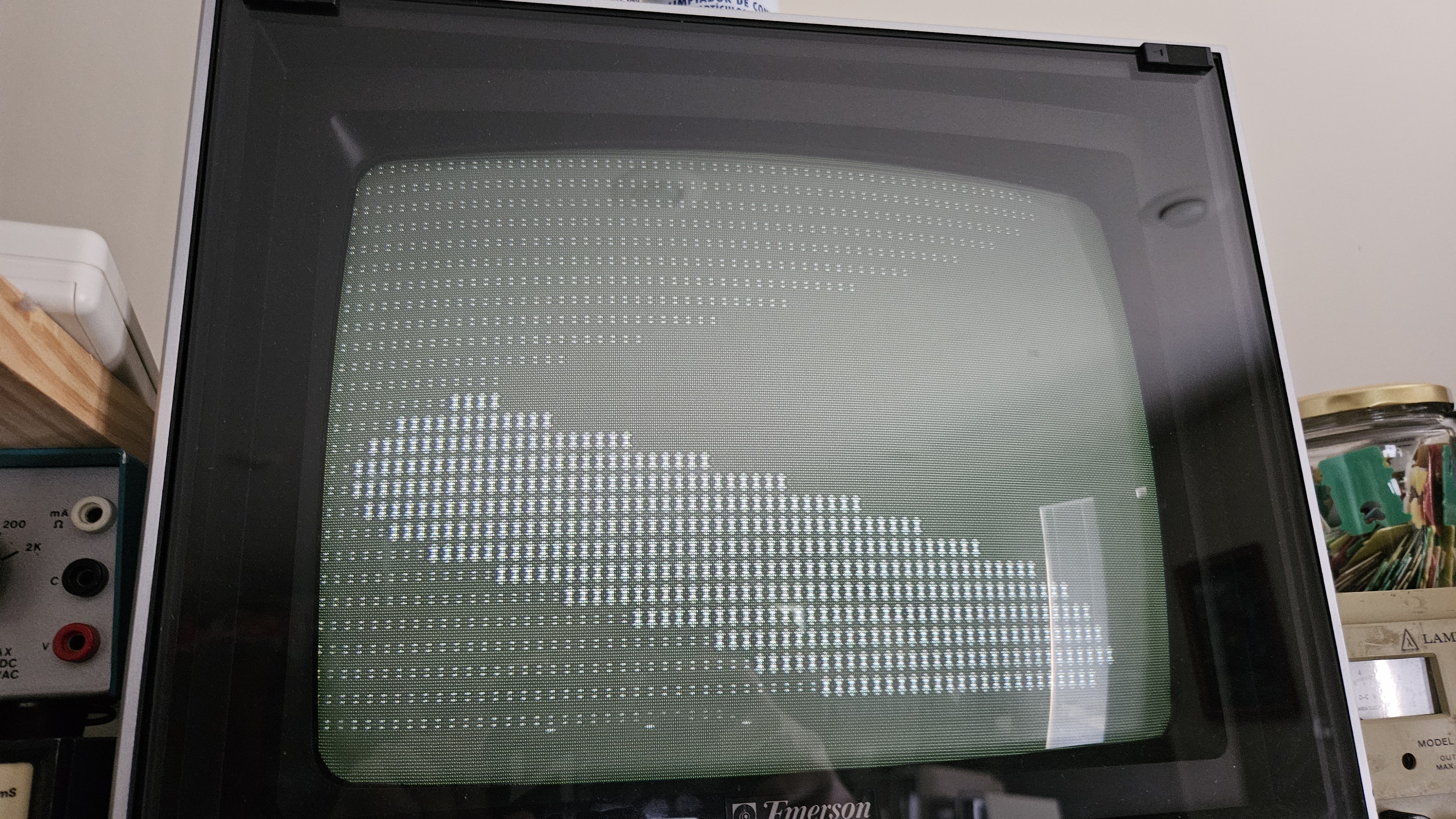

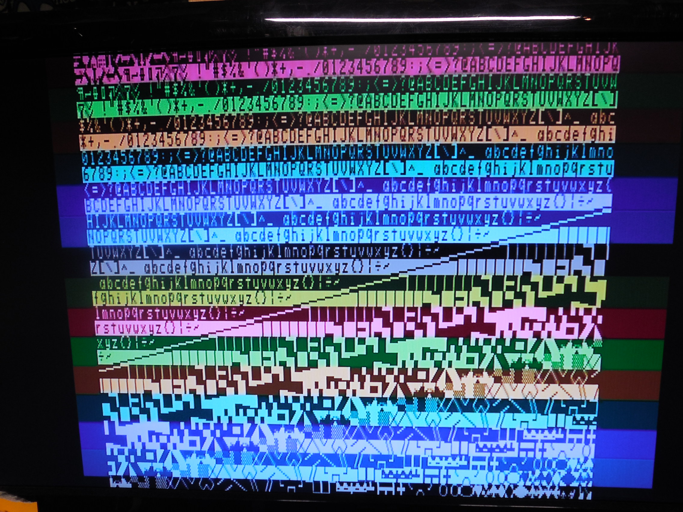

I have some photos from my OSI built C4P on a CRT and the program used to generate a test pattern in case you are interested.
One thing that may not be included on the schematics -- on the RCA connector on the back of the OSI there is a .01uf cap soldered across the terminals. The fine color adjust pot on back of the C4P generally needs to be adjusted to reduce the chroma noise or phase distortion.
Nothing special, just a test program I whipped up to test video one time...
"Never Twice the Same Color"
Same image on LCD TV
1 POKE 56900,5
5 J=13*4096
10 I=14*4096
20 FOR R=0TO31
30 FOR C=0TO63
40 POKE I+R*64+C,R
50 POKE J+R*64+C,R*6+C
60 NEXT C,R
70 GOTO 70
- fillcolor.txt
- BASIC program used to generate test pattern
- (155 Bytes) Downloaded 233 times
