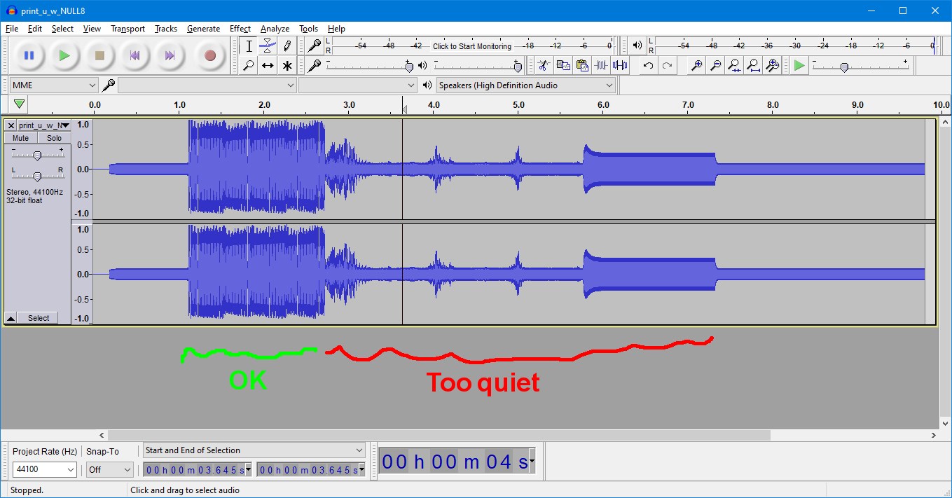

When using the cassette I/O with the OSI, the volume level for playback on the tape recorder needed to be at 80-90% or "very loud". Not sure what this level was in volts, but it was enough to drive an 8 Ohm speaker directly with pretty decent volume.
I listened to your recordings, and I think they started out OK, but after 2 seconds or so maybe an AGC kicked in, limiting recording levels?
If you look at the waveform for print_u_w_NULLS it starts out OK, but after 2 seconds the amplitude decreases by maybe 50%? OSIKCS decoder is rather simple and needs high amplitude waveforms without too much noise. If you run it through Audacity, use the lowpass filter function set to 2400hz with 48dB/octave roll-off. I need to add this to OSIKCS internally someday.

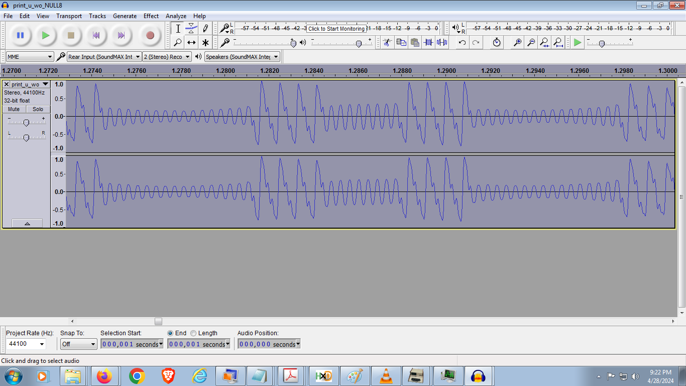

I' agree with what Mark said, but I'd also note that there is a big difference in levels between the "0" bits (1200 Hz tones) and the "1" bits (2400 Hz tones) in the files that you posted, and I'm wondering about that. Look at this example: When there are two one-bits in a row, the amplitude of the 2400 Hz tones becomes even smaller. I think the amplitudes of the two tones should be about equal. I also see a strong harmonic [Edit: I think 3600 Hz, not 2400 as I originally said] creeping into the 1200-Hz zero-bit tones. I'm not sure if that is a problem, or if it is normal.
Anyway, even with those problems, the print_u_wo_NULL8 file was decoded partially correctly by OSIKCS. It got the GOxx10 right (where the xx should have been TO, or 54 4F hex, but instead came out as B5 28 hex). [Well, if you really included a space between GOTO and 10, then it missed a character, but still not too far off.] It also got the next 26 characters right: carriage return, 10 nulls, linefeed, OK, carriage return, 10 nulls, linefeed. [There is certainly no need to add nulls, since 10 nulls are automatically added after each carriage return by the output-to-tape routine in ROM. When you added more with the NULL 8 command, you were actually creating a total of 18 nulls after each line: the built-in 10 between the carriage return and linefeed, plus 8 more after the linefeed.]

As far as the drop in volume, I'd noticed that too, it was a bit odd. I did pick up the save from AUX rather than MIC, so I wondered if it was too loud and that caused the laptop to kick in protection, however the same happens when I save using MIC.
Playback was at about 80-90% volume, but again that may vary depending on the playback device.
I'll try some of the suggestions you've both made as soon as I can and will update here.
EDIT: I have a small digital recorder and it doesn't suffer the same volume drop as when recording with Audacity, so it's doing something to limit it, either that or the sound card driver is. Also, I just re-read and noted the NULL8 part you mentioned @bxdanny so I will avoid in future.
I also tried recording from the digital recorder to Audacity and it bails at the same point, despite the audio playback from the recorder not having a drop. I will try reducing the recording level on audacity and see if it helps. (It didn't BTW)

OK, so the volume drop is definitely the laptop and not the OSI.
I plugged into a set of speakers and there is no drop at all, just like with the digital recorder. I need to figure that out next.

P.S. I still think the saving problem is likely due to the level of the 1-bits (2400 Hz tones) being much lower than that of the 0-bits (1200 Hz tones). Check that the value of C13 is correct (0.01 uF). I know you have had incorrect capacitor values in other places.
