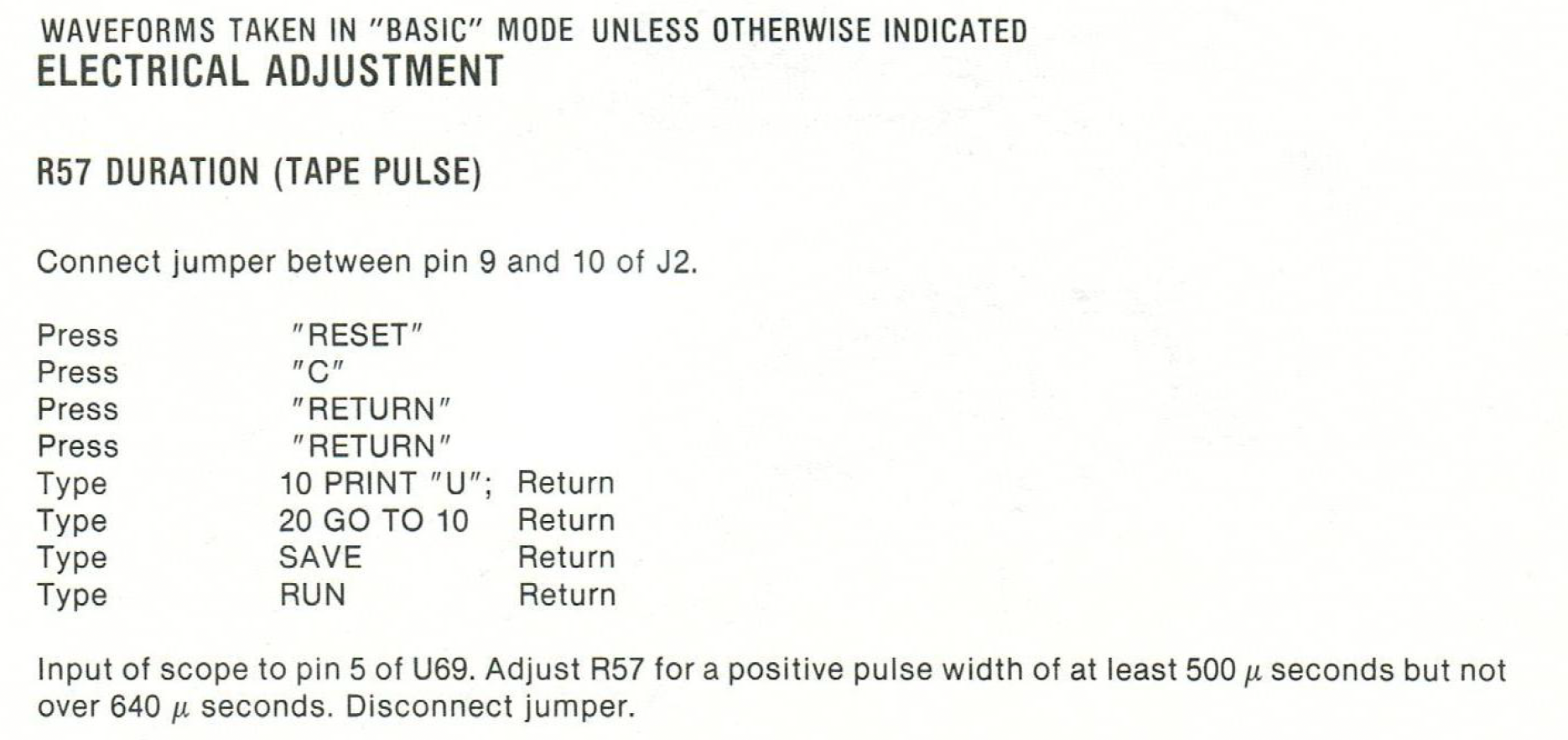

The service manual gives this as the way to adjust R57:
Screenshot 2024-05-13 at 09.03.23.png (1.52 MiB) Viewed 6140 times
It's what I've done for mine, getting it somewhere in the middle of the range, though I haven't yet confirmed my cassette in/out is working properly.

ronin47 wrote: Mon May 13, 2024 8:05 am The service manual gives this as the way to adjust R57:
Ahh interesting I have not seen that. I will give it a try. Not quite sure how to accurately check the pulse width on the digital scope I have but I’m sure I’ll figure it out.
Posts: 299
Re: OSI Portable Project
Sideburn wrote: Mon May 13, 2024 11:58 am
I must admit I was fighting with mine to read the pulse width until I realised it was up there all along at the top of the screen :)
