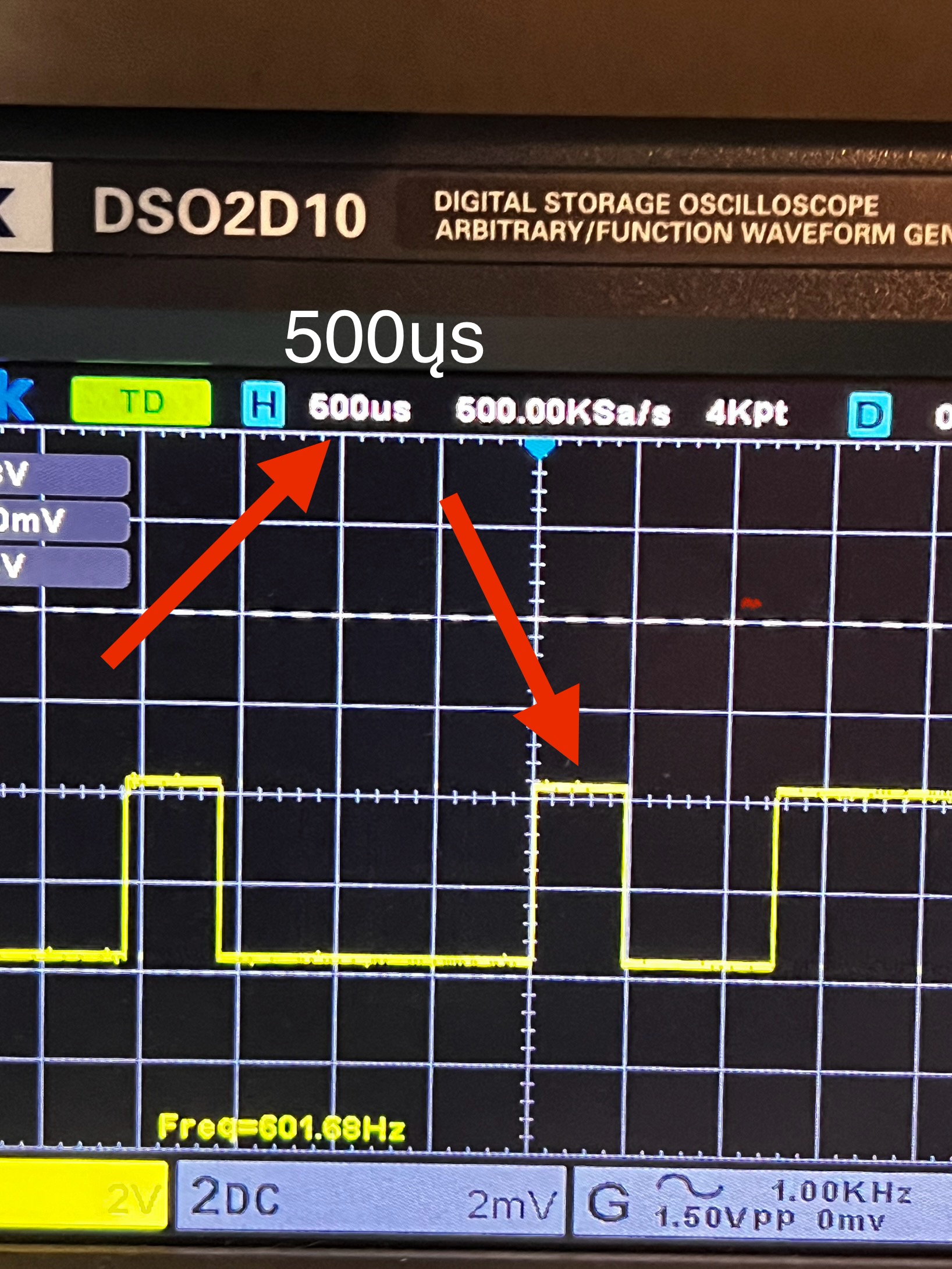

Post by Sideburn »
ronin47 wrote: Mon May 13, 2024 8:05 am
The service manual gives this as the way to adjust R57:
It's what I've done for mine, getting it somewhere in the middle of the range, though I haven't yet confirmed my cassette in/out is working properly.
Just did the pulse calibration.
Didn’t get this right?
Posts: 299
Re: OSI Portable Project
Sideburn wrote: Tue May 14, 2024 6:16 pm
Looks very like mine, so I think so :)
Sideburn
Posts: 140
Joined: Sat Feb 03, 2024 10:59 pm
Post by Sideburn »
Thats with the pot pretty much maxxed out. If I turn it all the way up then it gets just a tiny bit wider. So 500us is about as good as I can get.
Posts: 299
Sideburn wrote: Tue May 14, 2024 8:41 pm Thats with the pot pretty much maxxed out. If I turn it all the way up then it gets just a tiny bit wider. So 500us is about as good as I can get.
Interesting, I can easily get up to near 600uS with mine.

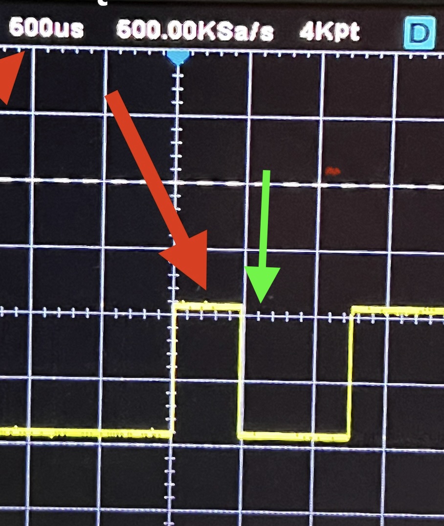

Sideburn
Posts: 140
Post by Sideburn »
ronin47 wrote: Tue May 14, 2024 10:13 pm
And you are measuring the top of the waveform like I am?
If I max the POT out then i can get it goes to where the green arrow is (actually about half that far):
OH wait is that 600? :oops:
If you want to increase that pulse width beyond 500 microseconds, would it not make sense to increase R53 from 10k to 12 or 15k?
I'm thinking 12k would give a maximum pulse width of 550 us, and 15k would give 625 us, since the series resistance of R57+R53 would be increased by 10 or 25 percent.
