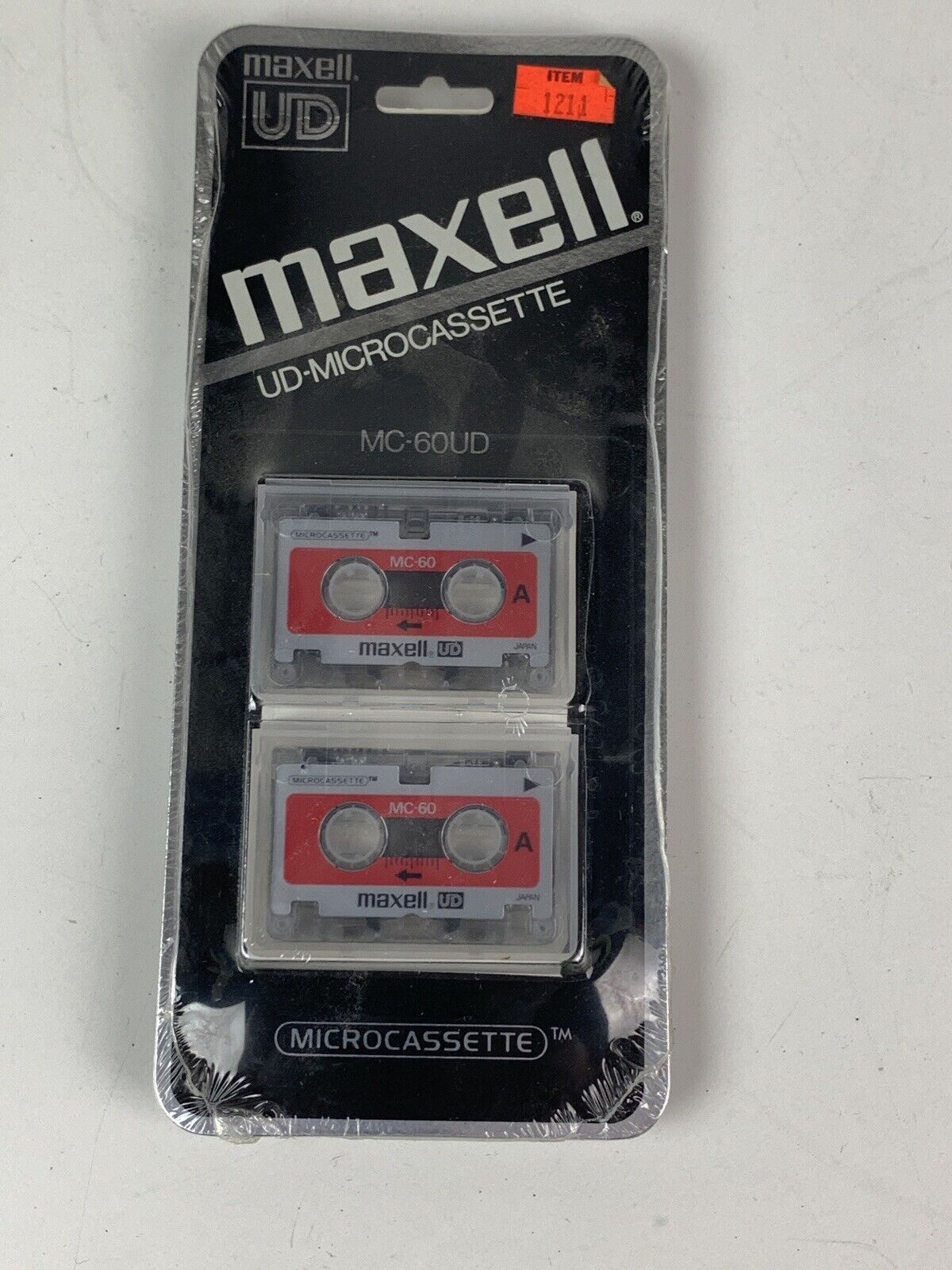

I found the perfect Microcassette tapes. The Maxell Ultra Dynamic's They are read and writing flawlessly. They must have been made for saving data! :lol:
Re: OSI Portable Project
Sideburn wrote: Wed May 22, 2024 11:14 pm I found the perfect Microcassette tapes. The Maxell Ultra Dynamic's They are read and writing flawlessly. They must have been made for saving data! :lol:
Nice find!!!
