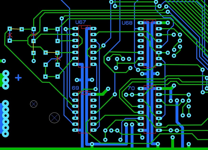

Bill good eye , from the pin out above it show drive pin 10 and 12 joined so my image is wrong not pin 8 and 12.I can't see this a a good idea for newer drive maybe ok for jumper selectable older drives I would leave it out
I will correct the drawing
check the 610 schematic it has the jumper settings for 2 sided drives
Between all the old drives and new drives there is no clear conception scheme ,that's why I left lots of pads for experimenting

I can confirm the 2 sided drive mod for the 610 with the d-13
also the white jumper on the d-13 could be placed on the 50 pin header pin 26/28 instead of soldering it to the 34 pin header , I believe this would only be for using 2 double sided drives otherwise can be left off.
tested and working
MPI-51 with D-13 no modifications
Toshiba nd-354A 720KB 3.5 with D-13 1 side only no modifications
Toshiba nd-354A 720KB 3.5 with D-13 2 side 80 track/per side 610 mod/d-13 mod
next up using a 1.44 drive as a 8 inch replacement
