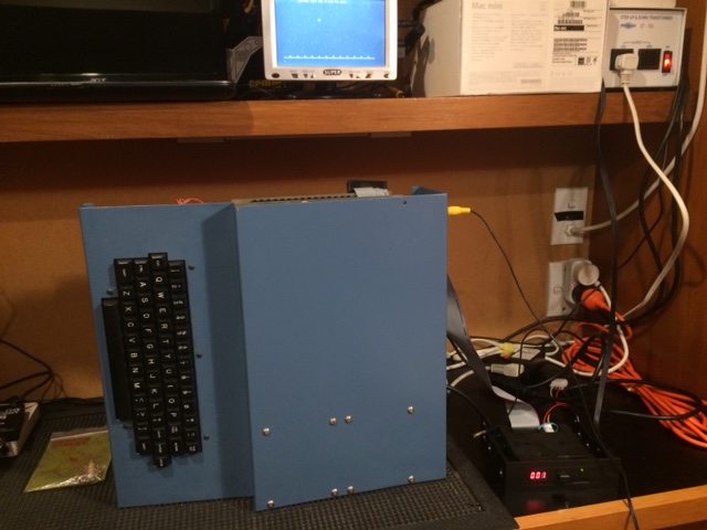

Hi Mike, Thanks for the info. I'll give it a go.
Posts: 375
Re: Help with C2 + D&N MEM_CM9 board + D13
Post by nama »
OMG...it works!
That took a while...
Don't ask me how I exactly did it. I tried soooooo may combinations, and suddenly it started working.
Very nice!
