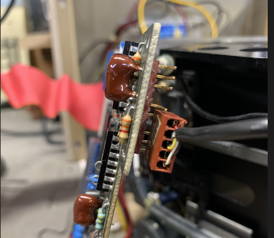

floppy drive.

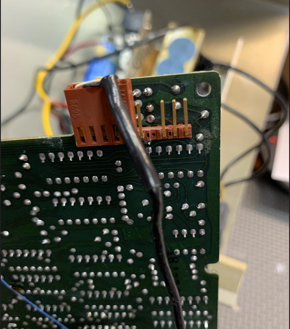

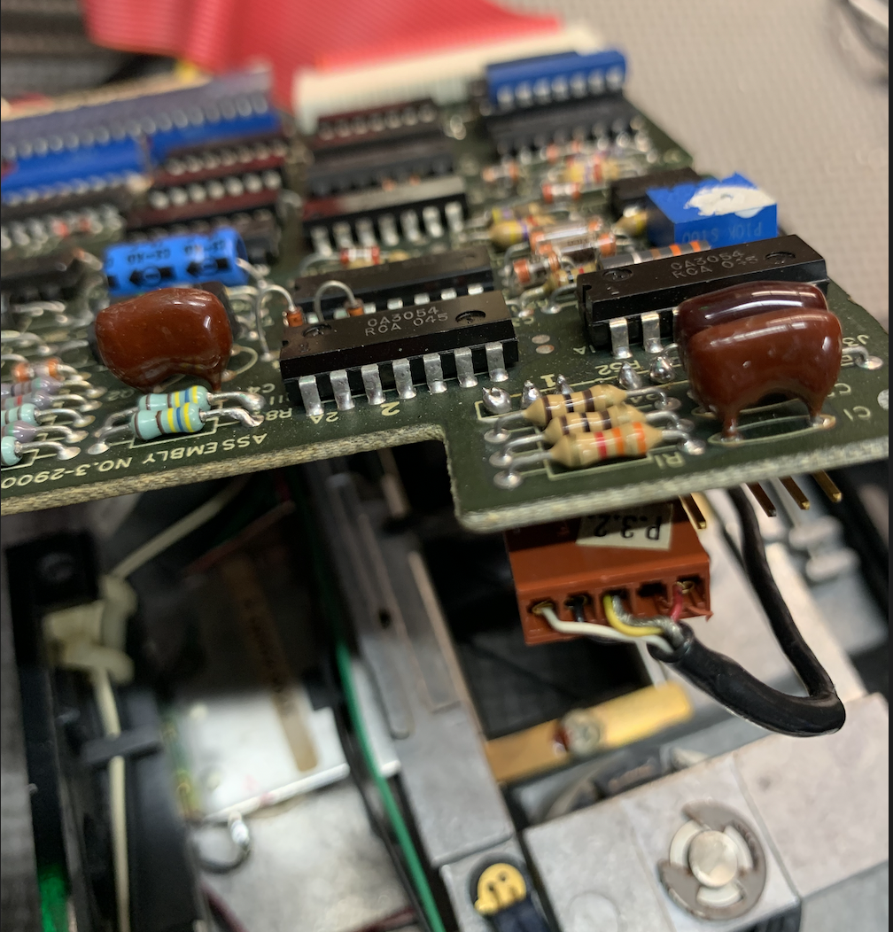

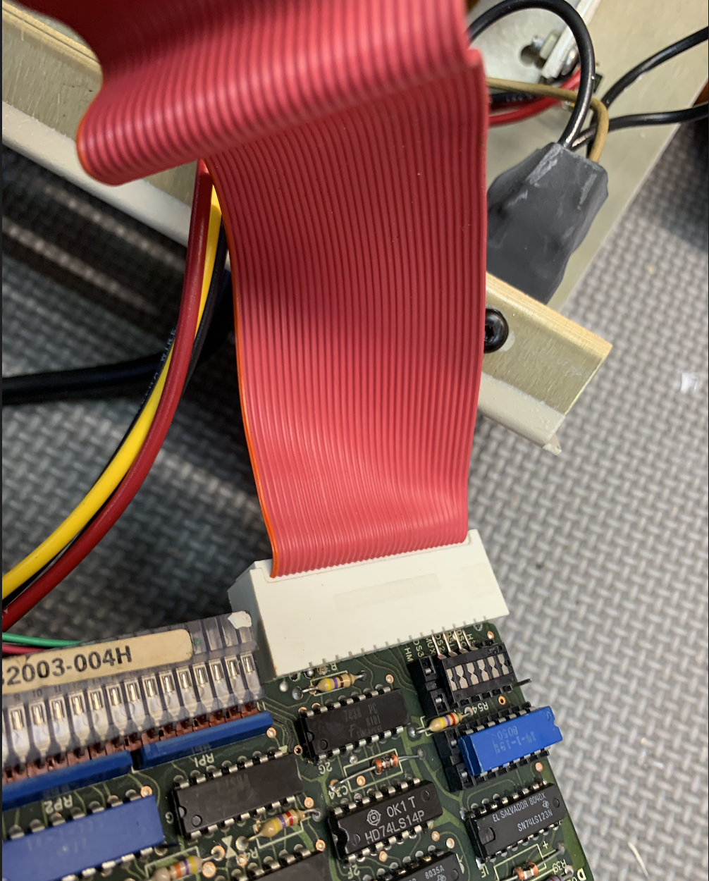

pressing D does not clear the screen. drive led comes on and says on when powered. if I slide the head in, power the drive, it will step back to home/outer track and spin with the led on. no further stepping or activity. I'm testing with the CUSTOMER DEMO disk that came with it.
can you verify this this is/was connected correctly?
head connector is keyed to 123x5 with white wire to the left (from front) and on the left most pin of the connector. it looks like this is the correct location, but there are other connector pins. just want to verify.
34 pin ribbon orientation is the way it was mounted with the cable crimped in the back of the case. connector is not keyed, and no marking for pin 1 (which I believe would be the right-most contact when looking from the front). on the PC side, the red IDE cable is attached to a DIP-type header mounted to a pcb that connects to the top side (when upright) of the processor board. no other components inline. where's the floppy controller?
and can I test with a standard PC IDE drive? On my TRS-80s with similar Tandon drives, I can easily substitute a PC IDE floppy or a gotek.
I have a variety of old full height and modern IDE drives along with goteks if they can be used.

Re: Challenger C4P estate sale find project
I no longer have original OSI MPI drives, so I can't verify connection orientation.
However according to the product manual I think it looks correct (Head 0 is J3 pin 6-10? )
The OSI floppy drive is similar to a standard PC 360K floppy except the OSI uses a simple FM encoding scheme that requires disk Read Data be converted into separate clock and data streams. The MPI-51 drives have a small daughter board on the front left(?) that does this. The OSI disk controller consists of a 6821 PIA, some interface buffers, and a 6850 ACIA. Very basic. Long ago I modified my OSI with an inline data separator, allowing me to use standard 1/2 height PC drives or Gotek etc.
The fact that the drive steps to Track 0 when pressing 'D' after reset indicates the interface connectors are oriented correctly and the OSI can send and receive control signals from the drive. (The OSI screen clears upon RESET but nothing visible happens until the floppy reads data & executes programs after pressing 'D' )
The first thing I would do is clean the disk head even if it doesn't look dirty. Most of my drive problems start there.
If that doesn't help, there is a great OSI disk diagnostics program that was created a couple years ago by David Gesswein that can help you diagnose problems. However you will need a serial connection to load it in your OSI.
David's disk test can be destructive, so don't use an original disk when testing! See David's full page here. There are alternate data separator projects you can find on OSIWEB if you search for them & want to go that route.

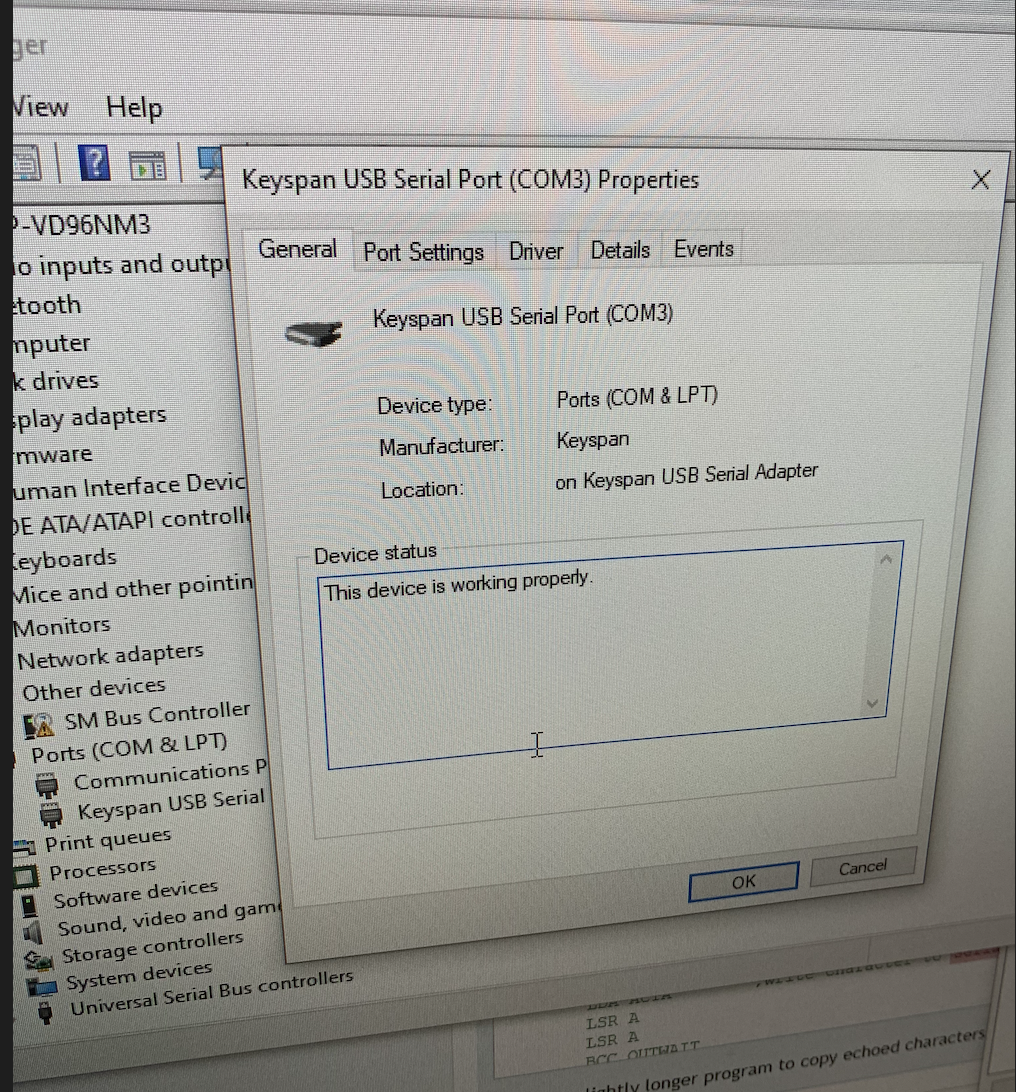

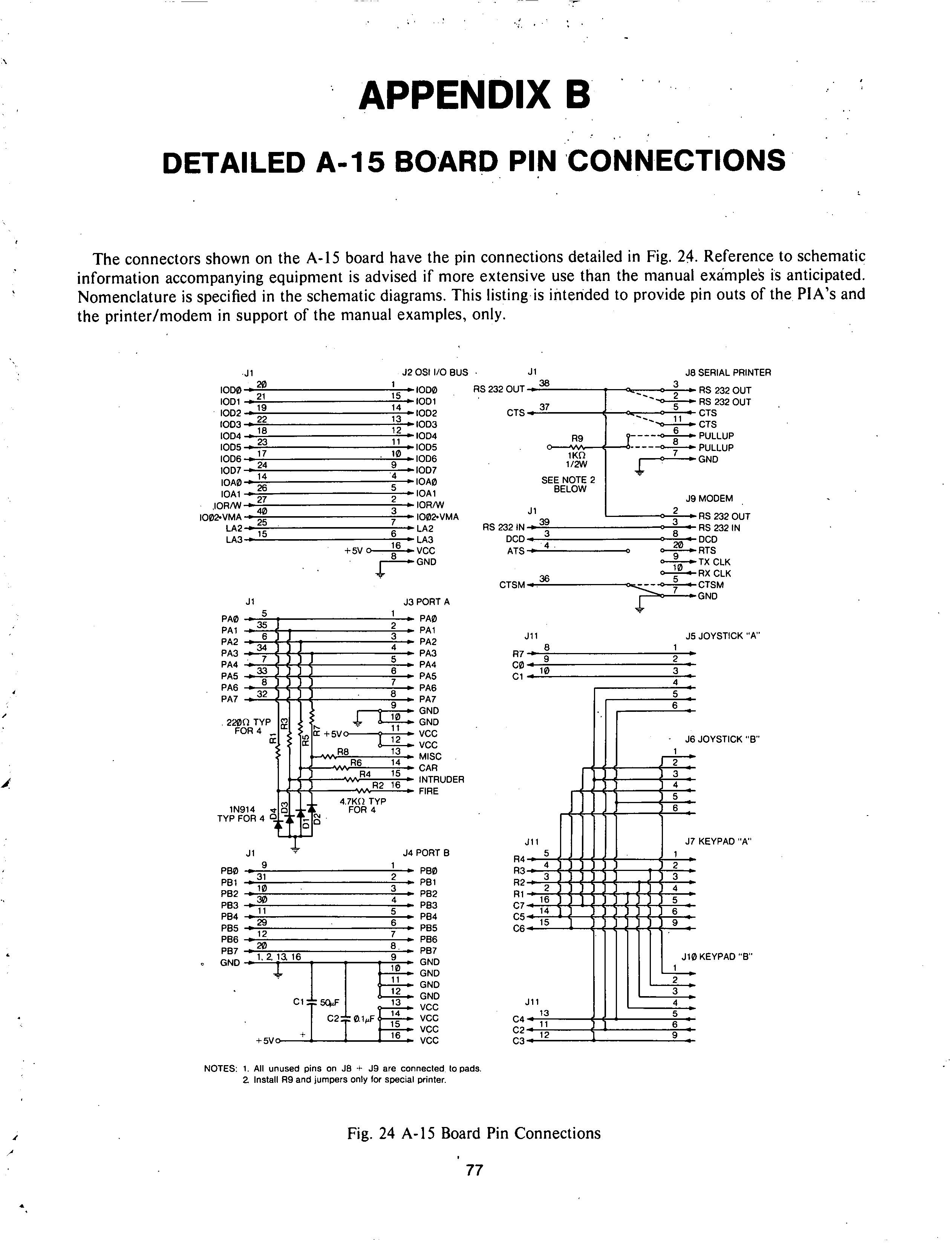

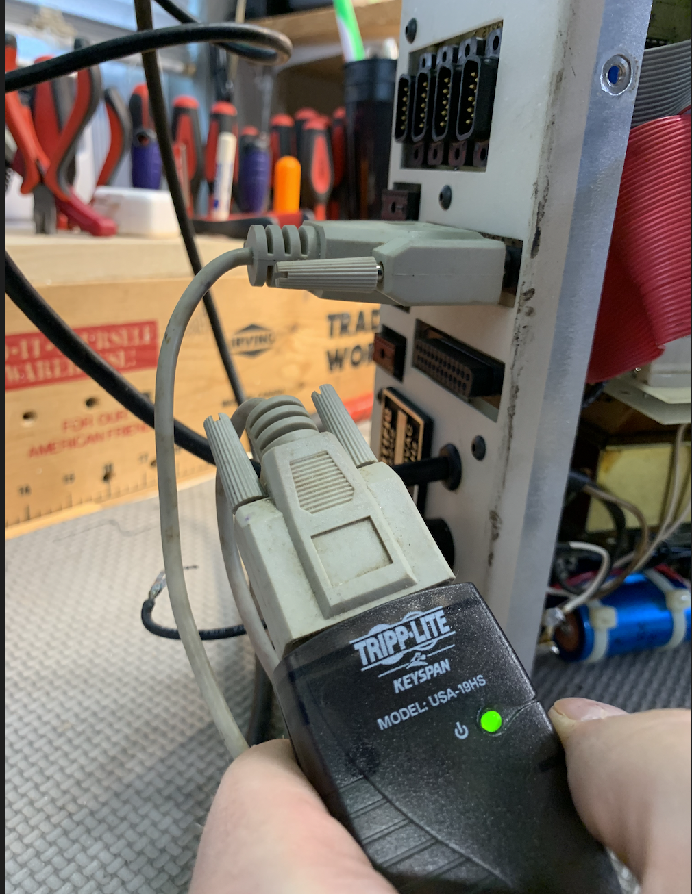

Serial connection:
I found a DB9 to DB25 (?) cable. Connections looks like this:

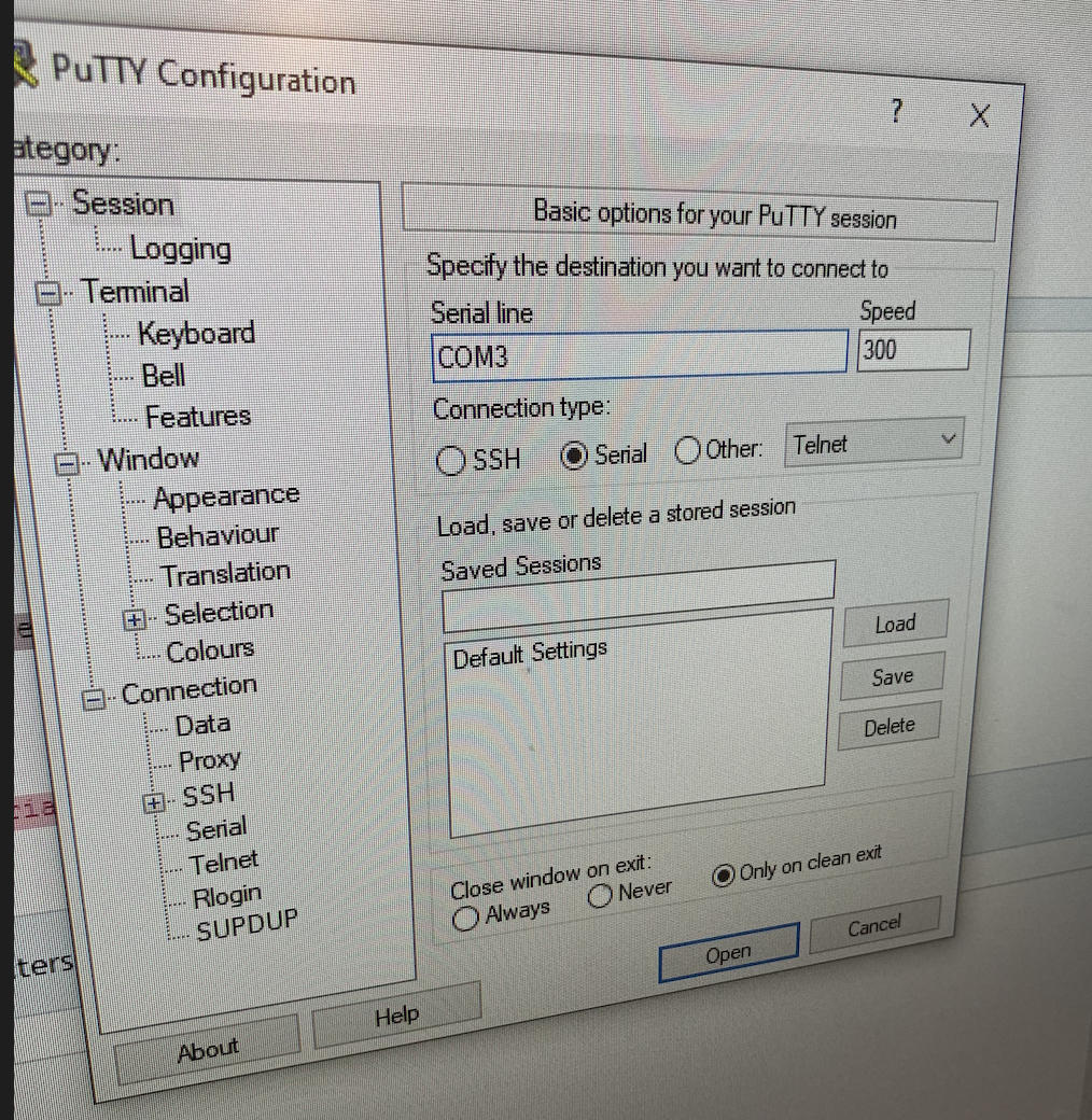

The Keyspan USB to serial adapter seems to be configured properly in windows 10 with drivers. I used this keyspan for a couple of years a while back and it worked fine. LED on keyspan blinks when I type into putty.
I configured putty as follows: Serial, COM3, 300 baud.
I typed in the serial test program Mark referenced.
You can test for proper serial I/O using a 21 byte program found here https://osiweb.org/osiforum/viewtopic.p ... rial#p4186 on a different thread.
here's what I see on the challenger screen:
the challenger screen continuously 'jiggles' like it is doing something. the keyspan led lights when I type into putty. but nothing else, no visible data.
am I doing something obviously wrong? suggestions? fat finger of the serial test?
thank you
Hi,
It's been so long since I've used an unmodified C4P, that I may have left out an important step. According to the A15 pinout guide from the manual (attached) , it looks like the "Printer" port may be active by default, which may only have serial out. The "modem" port is bidirectional, but requires a control bit to be set active in order to get it working. Entering .F703/34 should activate the modem port. (This confused me years ago and I hard wired the default port to be bidirectional) So before the program you entered, add A9 34 8D 03 F7
Also I think the 1st serial program you typed in had an extra character. The screen shake seems to be a side effect of an endless loop accessing video memory. Try the version below.
My system has been changed from the the way it was shipped from factory, but you may just need to swap pins 2 & 3 (NULL modem) to get it to talk. You only need pins 2,3 & 7 on the DB-25 end (I can't remember if you need to jumper hardware flow control signals 6=8=20 too.)

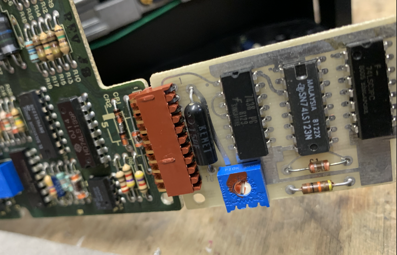

six months later and I pulled the OSI Challenger 4P out again. I feel like I'm starting over. I believe the computer is working fine and the floppy drive wants to work but does not.
Current status: shift lock pressed/down, powers on to garbage, drive spins up with red led on and CUSTOMER DEMO disk in. press break key screen displays H/D/M. pressing D will return drive head to outside track. at times, the H/D/M will clear from the screen and the disk acts like it is trying to load something but eventually just spins.
I'm wondering if there's possibly a physical connection or cable issue since this seems intermittent ?
is the head connector oriented properly and in the right place? this little doo-dad board seems very unstable with its pin connector. what is it's function? when I first pulled the drive apart, I notice the head stepper was working but the drive motor wasn't. I looked under at the belt, and there was a broken piece of plastic wedged in the belt. cleared that and motor works.
thought on getting the drive to work? I have a few similar Tandon SS drives from TRS-80 Model 1s if that would be of help to substitute. from brief reading it looks like a special interface is required to use most other drives, including gotek.
As I was recently reminded, OSI warned consistently about powering either the computer or drive on or off with a disk in the drive, since that can cause transients that can damage the information on a disk. OSI 5.25" drives were especially susceptible to that, since the head always remained loaded against the diskette. I hope your disk has not been damaged. You could try booting some of the others you say you have, taking care that they are only in the drive while the computer and drive are both powered on.
That "doo-dad board" is the FM data separator. It is definitely needed by OSI systems, although most other computers didn't need it. However, I understand that user Klyball on this forum sells an interface (replacing the standard "paddleboard" and cable) that includes a data separator external to the drive, eliminating the need for the internal one.
That the H/D/M? "sometimes" clears from the screen says that sometimes, enough of track 0 loads correctly enough for the screen-clear routine on it to be able to execute, so the cables are presumably connected correctly. Try cleaning the heads and, If you can, run the drive speed test (from Mark's site). Perhaps the belt being stretched by having that piece of plastic wedged under it is causing the speed to be off?
