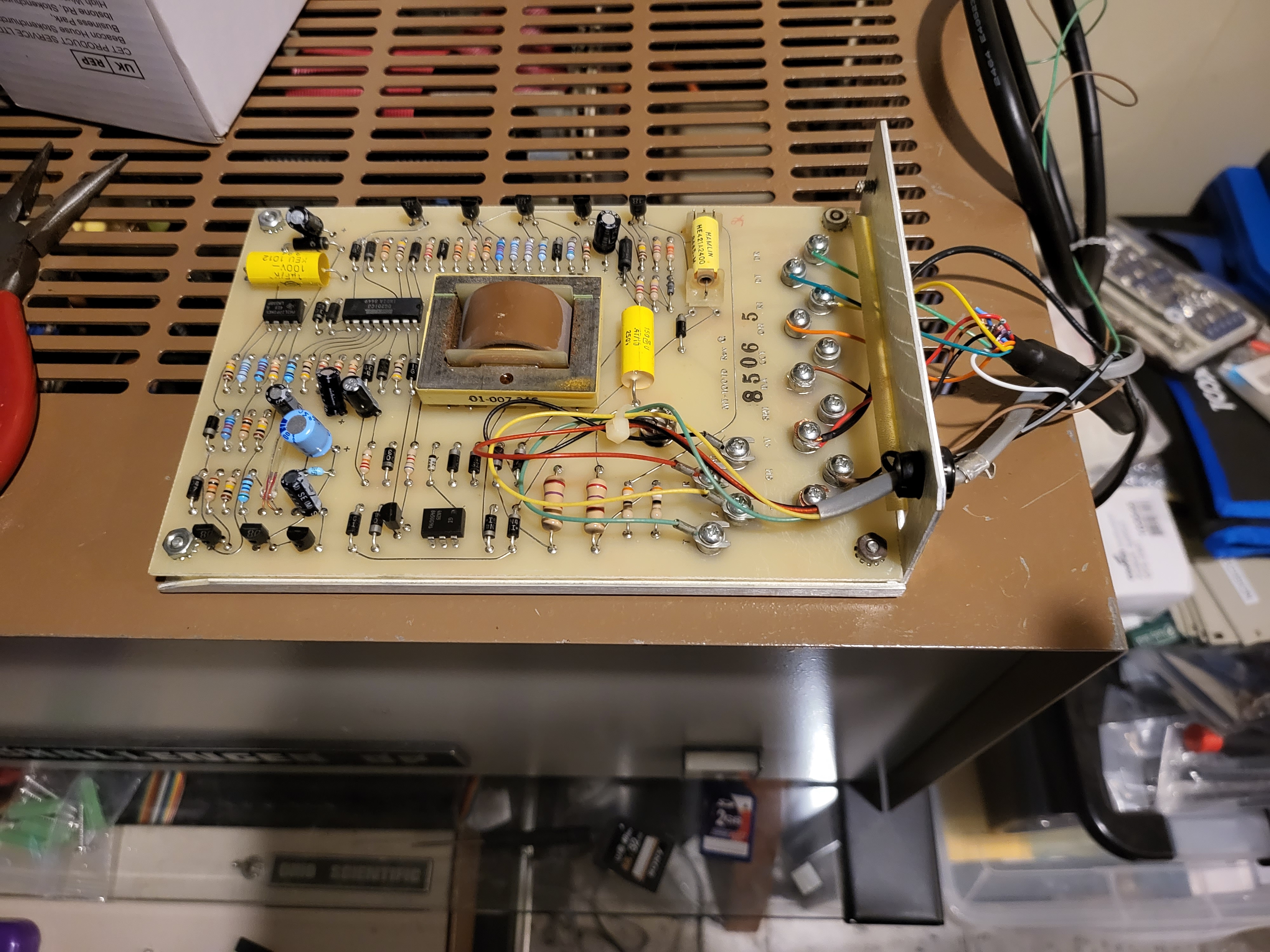

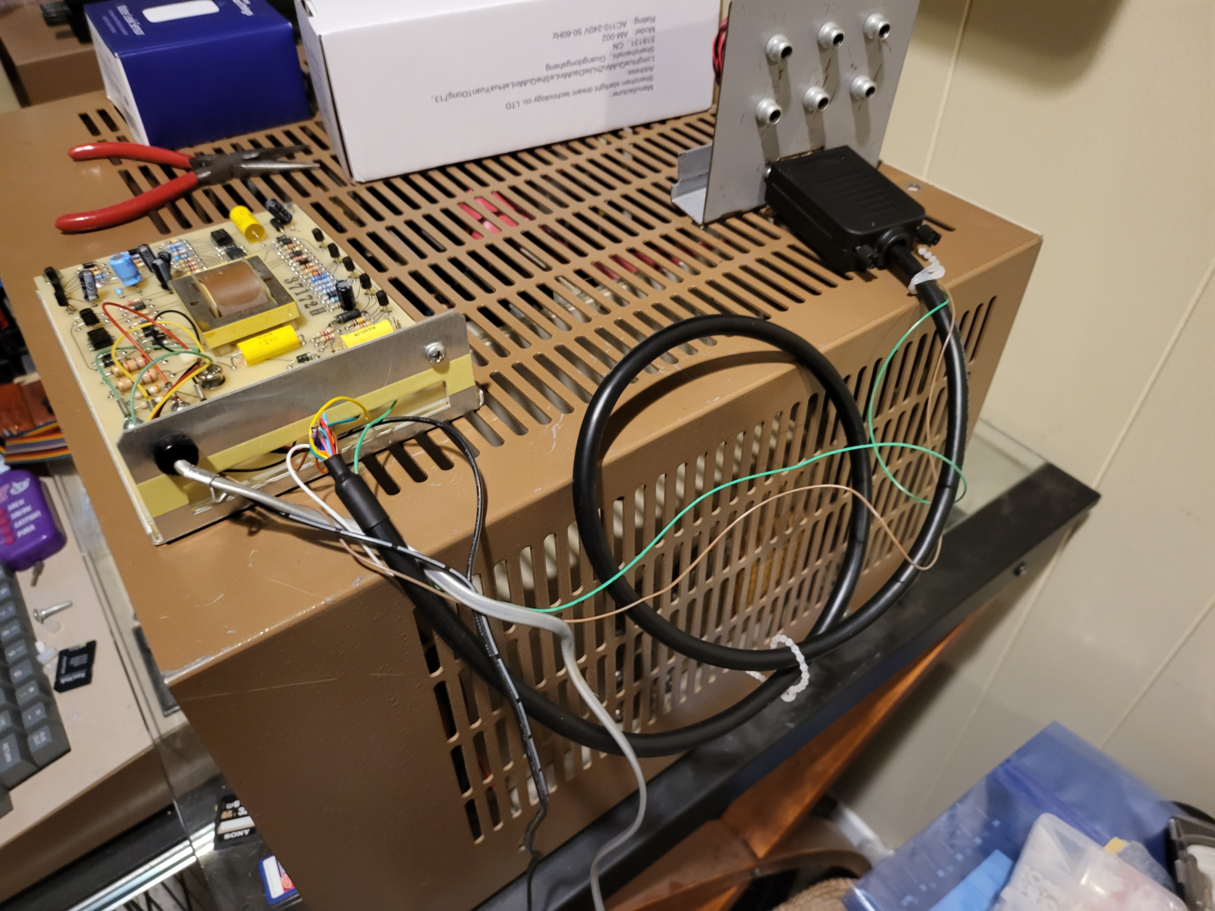

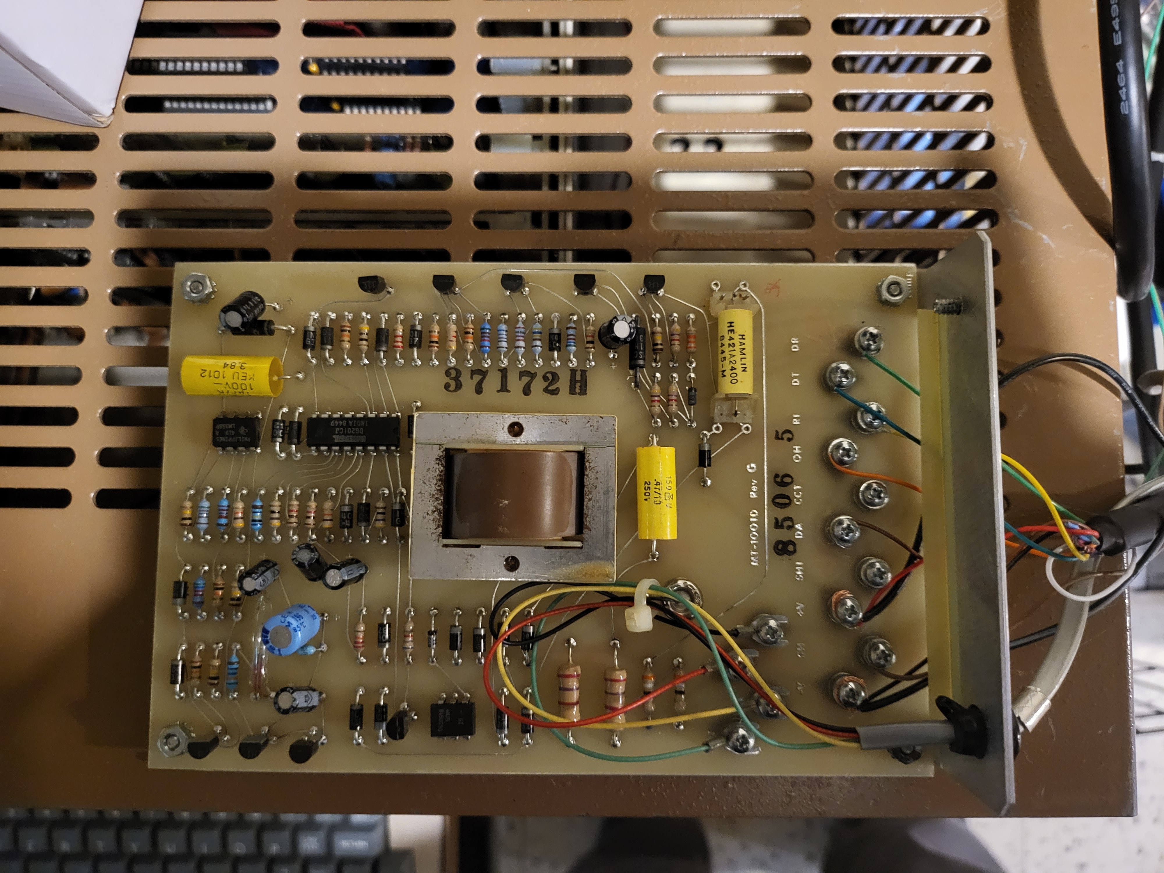

Danny and Mark, I've attached some photos of the Honeywell DAA I'm using. Got it on eBay for $40.

Nice pictures, thanks.
