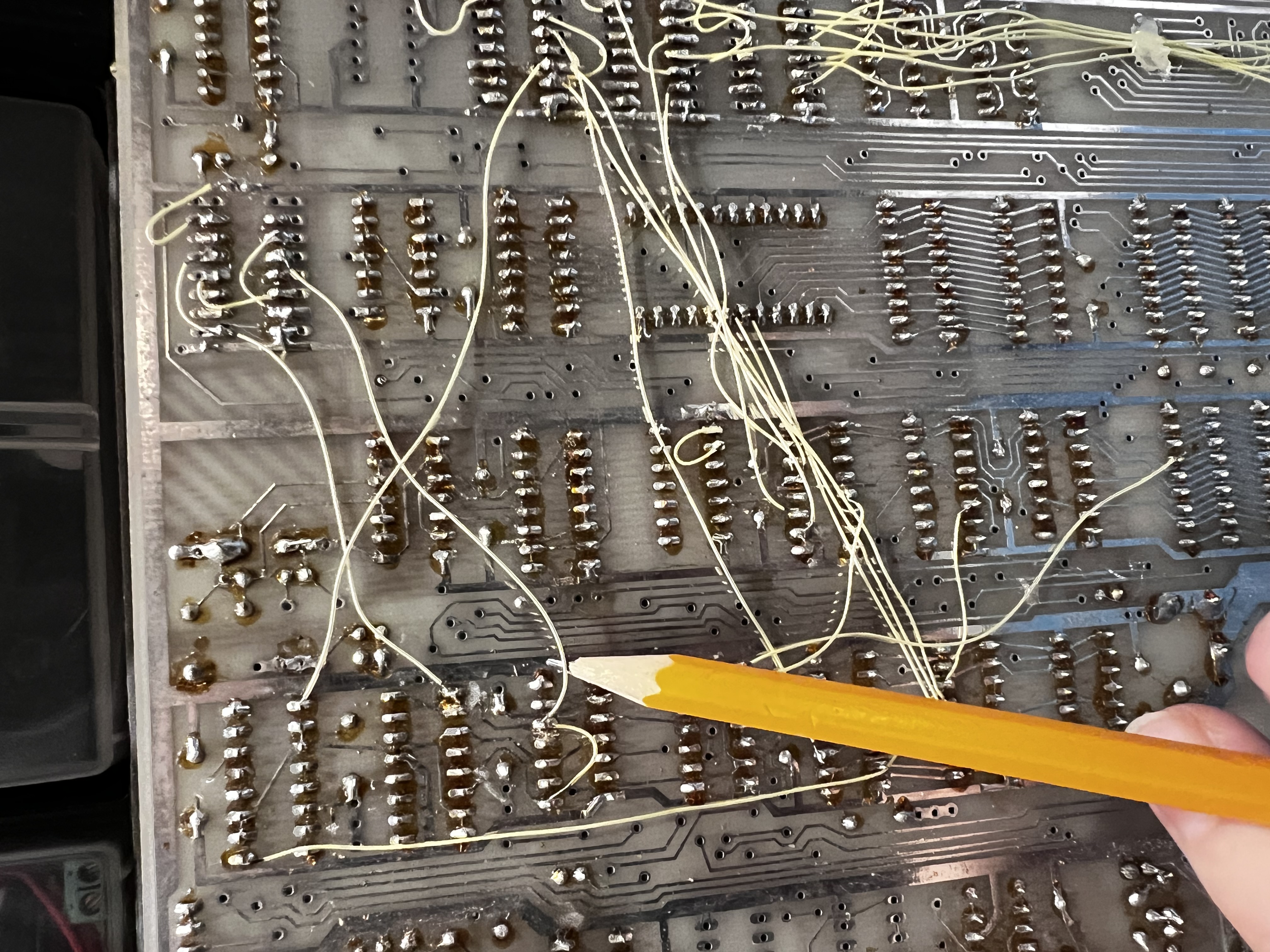

Re: BASIC audio files for testing
I think the cassette "mark" frequency is now half of what it should be. (1200Hz instead of 2400Hz)
Previously the clock for the cassette tone generator was correct, it was just that the clock for the 6850 (pins 3 & 4) was 600 baud (9600Hz) instead of 300baud (4800Hz). Not sure where the modification was made exactly, but you should be able to locate it by tracing the clock pins of the 6850 to its source. Someone with a C1P may be able to help.
I see a jumper on the 6850 from pin 5 to U18 pin 9.
The 6850 pin 3 & 4 are tied together and go to U63 pin 9. This seems normal.
But on the underside of the board U63 pin 8 and 12 are tied together and then jumped over to pin 3 of U44 which has a 74LS74 on it.
- IMG_7557.jpeg (2.94 MiB) Viewed 3459 times
- IMG_7558.jpeg (2.69 MiB) Viewed 3459 times
