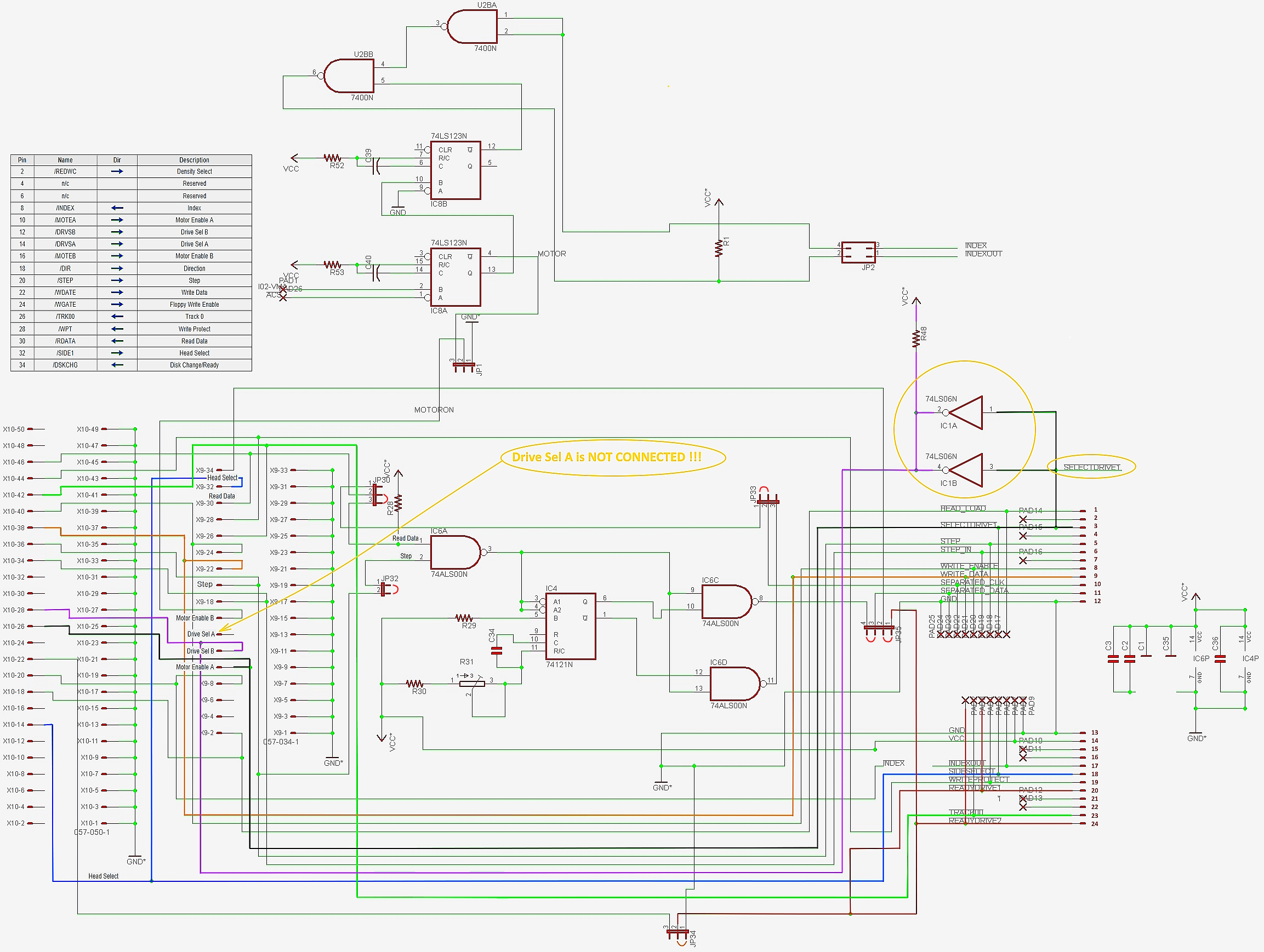

bxdanny wrote: Wed Jan 15, 2025 6:47 pm
I haven't figured out why, but when I copy from the Gotek "A" to an OSI 5¼ disk, I have to copy from "A" (Gotek) to "D" (OSI floppy disk) and not the expected ”C".
If I try to copy from "A" (sel0 active, head 0) to "C” (sel1 active) it will try to copy to the 2nd head on the floppy disk( h1), which will fail on a single sided disk drive, or, it will successfully copy to the 2nd head on a double sided disk drive, but obviously that disk can’t boot! .
This still sounds very strange. The normal meanings for A, B, C, and D are:
A: Drive 0, side 0
B: Drive 1, side 0
C: Drive 0, side 1
D: Drive 1, side 1
So the first side of the second drive should be B, not C or D. What happens if you try copying to B?
Danny, I believe I've found the reason for the odd "non standard" drive select behaviour...
(NOTE: I'm using a straight 34-way cable, no twist)
See below, the schematic of the Klyball D13-V2.
Klyball_D13_V2 - SIDE SELLECT.jpg (1.41 MiB) Viewed 2301 times
Ok, so I attached my 5¼" MPI. 51 drive, with Sel0 active, and the Gotek with Sel1 active and blank image sellected (on the same straight cable)
I booted Tutorial Disk 5, and using menu item 8. I copied the disk from "A" to "B" (Gotek) without error, BUT the display shows that head 1 on the Gotek is being written to.
I can subsequently use menu item 1. DIR(ectory) to read "B" without error, and the Gotek display shows head 1 being read.
I then attempted to read the DIR on drive "D"
I can see head 0 on the Gotek is sellected but it hangs...
