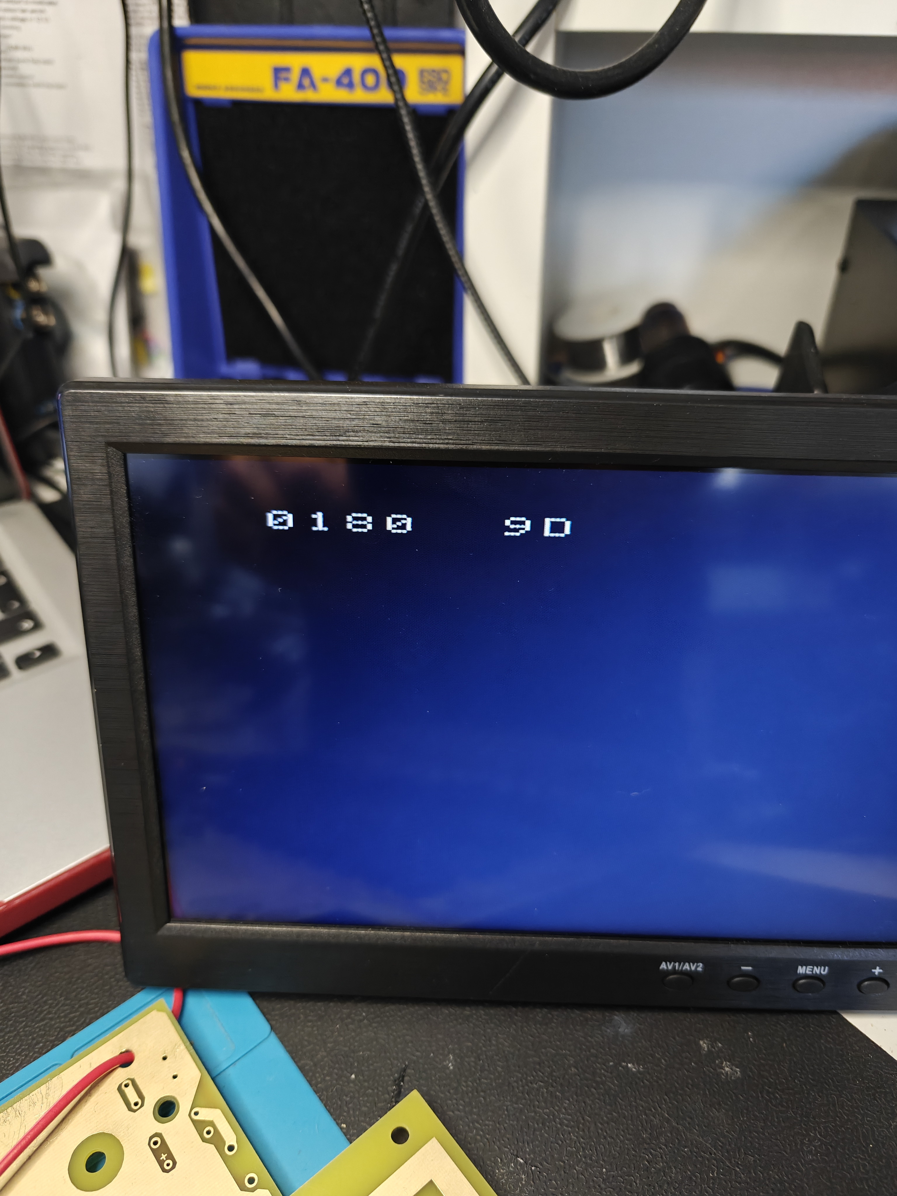

OK, so I have been trying to load MonMaze from the Monitor but seeing some stuff that doesn't 100% make sense so wanted to run it by the collective brains trust.
So I boot and drop to monitor and press 'L'
As playback (I'm playing back from a Windows 10 Laptop) commences, I see the 2 characters to the left of the memory location block change.
Sometimes there will be a flurry of changes, other times it will sit there for a few seconds before continuing.
The memory block of 4 characters does seem to increment too. I have also seen it flit between memory locations, or at least that's what it looks like.
Does this sound correct? Or should it be a constant stream of updates?
Just a reminder, I have run the tests and adjusted R57 and the pulse width is about 560uS as per the service manual.
BTW I am ignoring saving first as that is a simpler circuit, I want to get loading to work and return to saving later.

You should see the address field increment from 0700 to 07ED, then lines of text scrolling up the screen containing data in "checksum loader" format, containing code and data which load into the range $0DD2-$1FFF. These lines begin with a semicolon, then the number of bytes on the line (usually $18, i.e. 24), the data, and a four-character checksum.

I don't think it's the file, but I'm for sure not getting what you've put in that text file. It just sits and increments the memory counter as a hex number changes on the right.
I'm using your 48 column ROM BTW, but the results are the same in both 24/48 column mode.

You need to be in 24-character mode for the program to work. That''s once it's loaded, of course.
You could try converting the text file I posted this morning back to .wav format using OSIKCS and loading that. Probably the results will be the same, but I'd like to know.

OK, so all I see is this:
The 4 characters to the left increment, and the 2 characters to the left change.
I double checked the J3 settings for cassette operation and have the jumpers set as follows:

So 1 to 9, 4 to 5 and 8 to 10. That pic is from the copy of the assembly instructions I have.
