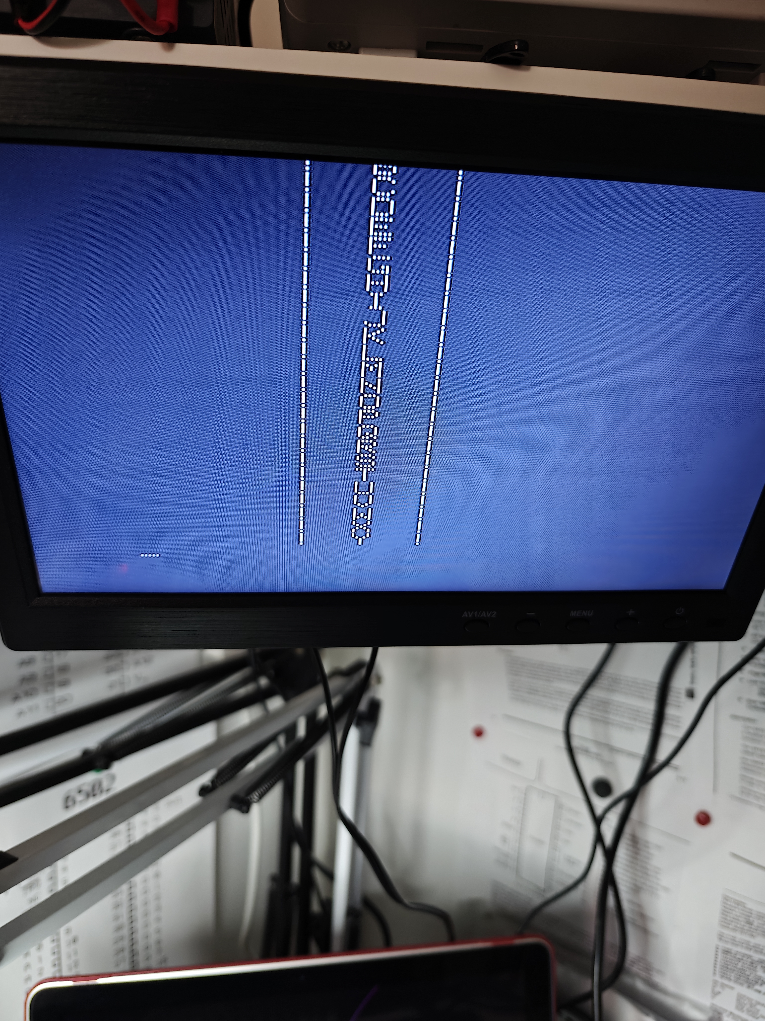

A quick glimpse of the cassette test program:
No, it's not working properly, but it is an improvement on not working at all.

Re: My Klyball 600D build
So, I typed in the following:
10 SAVE
20 NM$=CHR$(15)+CHR$(64)+CHR$(15)
30 FOR N=65 TO 96
40 PRINT TAB(8);"! ";
50 PRINT CHR$(N);" !";NM$
60 NEXT N
70 GOTO 30
And ran it, it seemed to be all good, but first time I didn't record it. I then did a list to save it to tape and it worked just fine, as after a reset I was able to load it back from tape :)
Then I ran it and let the tape record. This is the result when playing back :)
I call that a result. It isn't 100% perfect as occasionally it skips a line, but the fact I can save and load programs with reasonable reliability.
It's interesting the difference a better tape made too.
