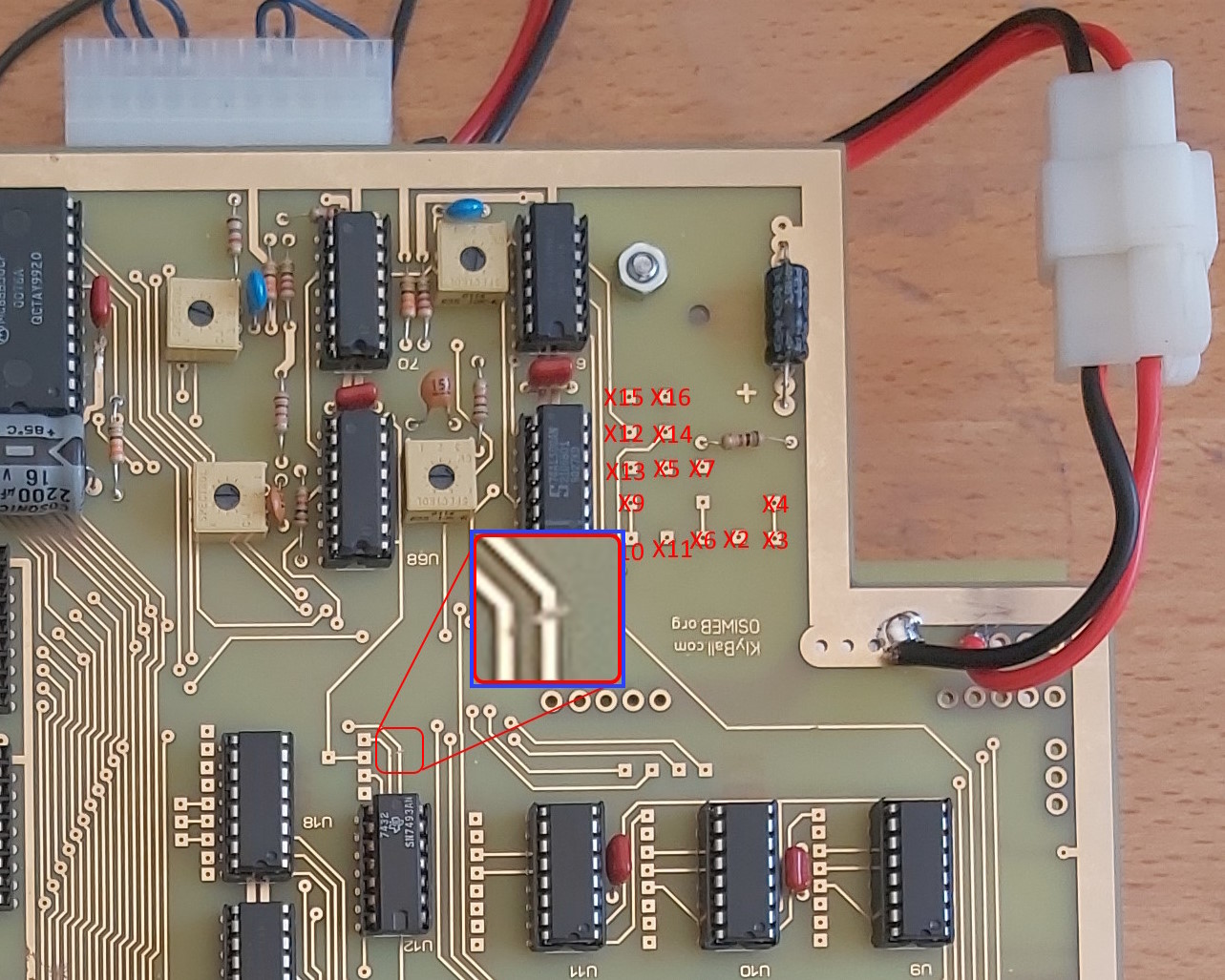

This is a very strange coincedence, or, it is not a coincedence at all:
With NO activity on the floppy data and control signsls, upon pressing "D" after a reset, I was hunting for the cause...
I found a cut track, a very specific cut. Not a manufacturing fault, clearly a CUT :o
It is the "buffered" 02 clock, B02 (U2 pin 3) without which no floppy control or data signals can be generated...
I bought this 610 PCB, un-populated, from a seller on Ebay....
B02 track CUT.jpg (333.73 KiB) Viewed 1965 times
Very strange indeed....
Anyhow, I repaired the cut, and now, upon pressing "D", I see the Track number (displayed on the Gotek) toggle briefly from 0 to 1, and back to 0. :)
But nothing further happens after that... Why, I as yet, don't know...

How in the heck did it get cut?
looking at the cut closely, it seems to be certainly deliberate....
(the rest of the board is "pristine", and is Gold flash plated)
Well, it's good that you found that cut. Based on your photo, it looks like it would be hard to notice.
The symptom you describe of going to track 0, then track 1, and back to track 0 sounds a lot like what happened when I first got my 5.25" disk drive and 610 board. It happened because I only had 12k installed, and the disk I was trying to boot (which was the standard version of Pico-Dos) actually needed 13k. But you have the full 32k, so that shouldn't be the issue. And you have booted disk images from the Gotek unit successfully, Still, if you haven't run a thorough RAM test, perhaps it would be a good idea.
