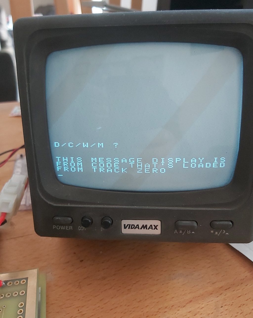

On the Gotek, your single track, tzonly.hfe image boots perfectly.
However, neither the 5¼" or 3.5" disk boots with this .hfe image, or ANY image for that matter :(

It BOOTS, every time!
Edit: I read the same disk with 1 revolution per track, and the resulting .hfe file ALSO boots in WinOSI!
