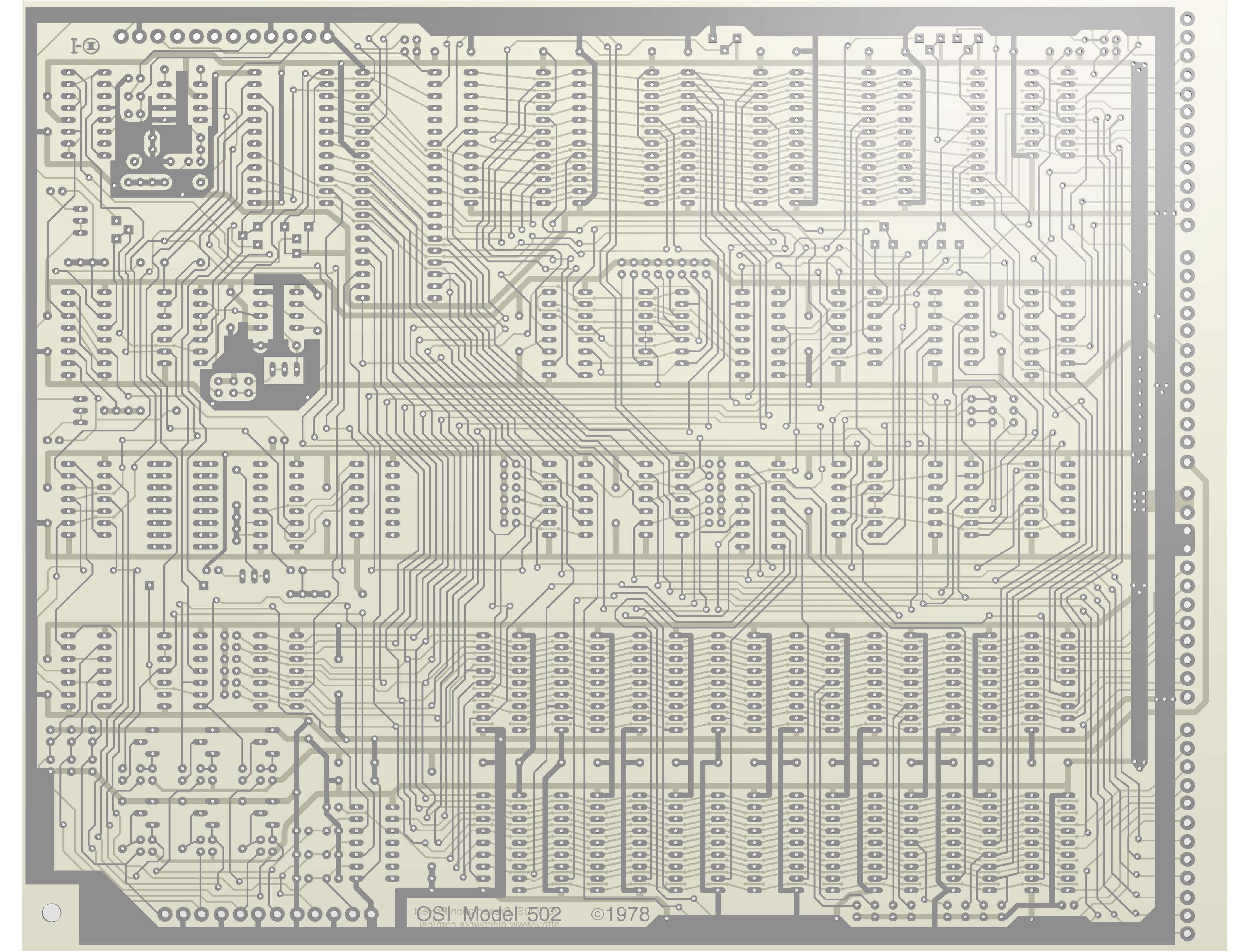

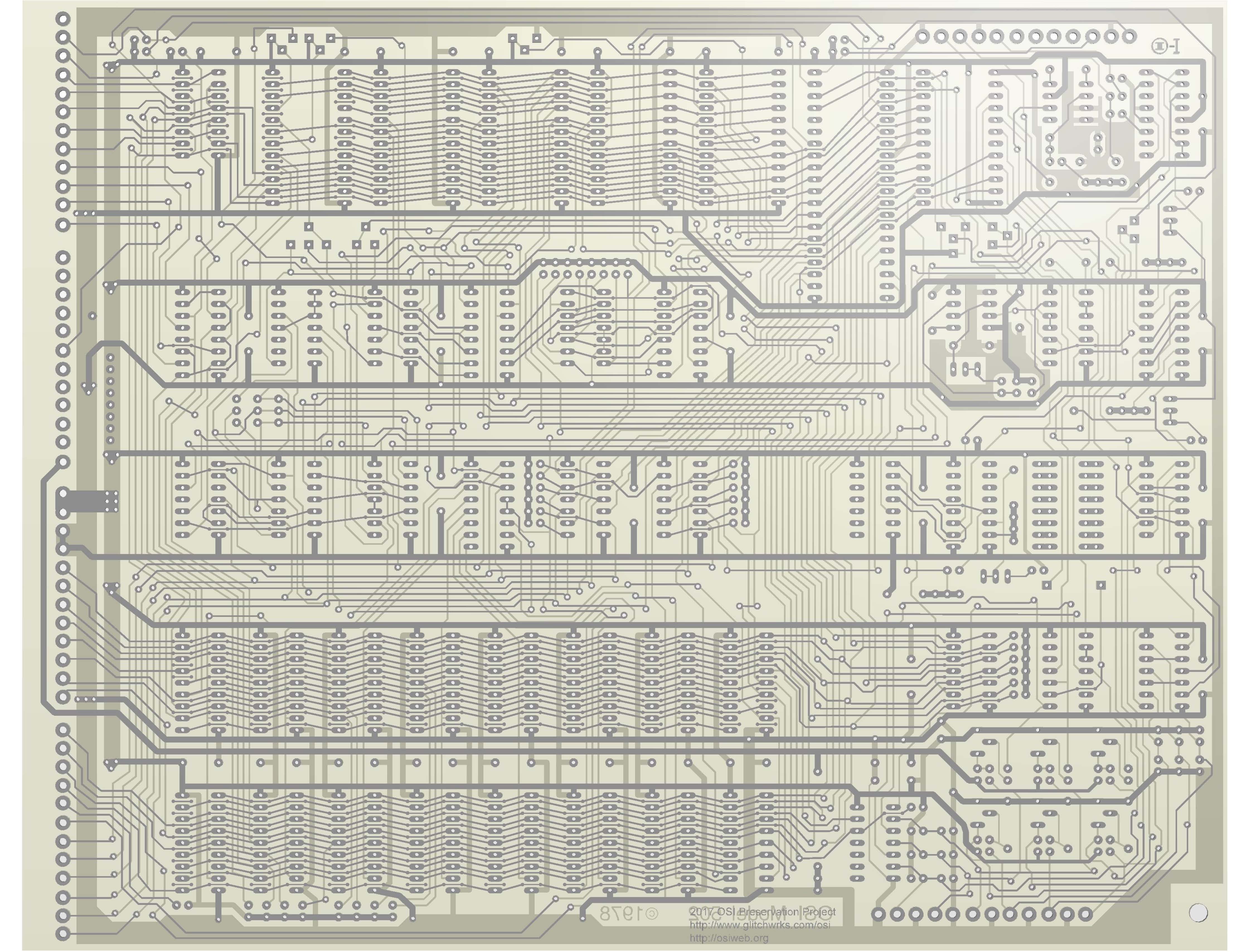

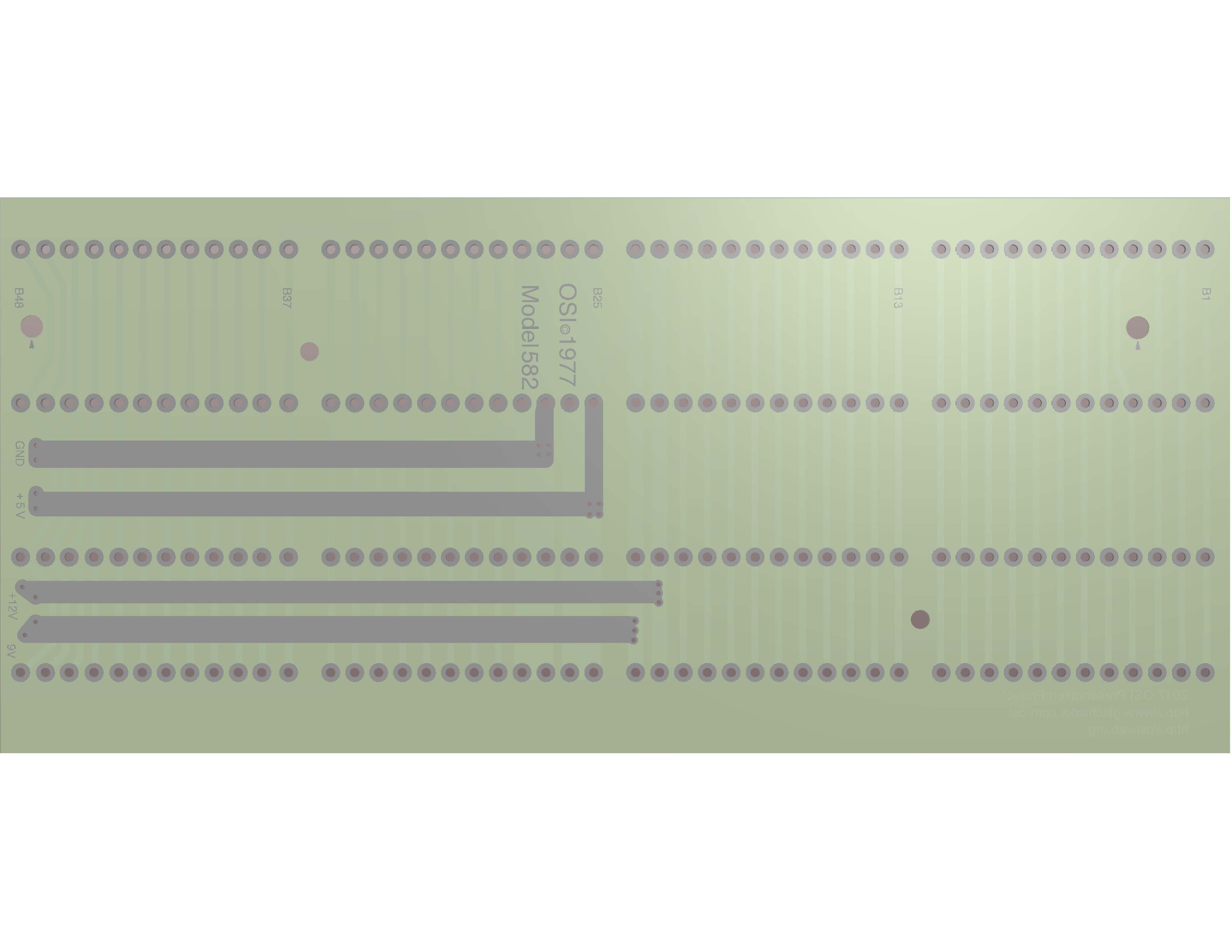

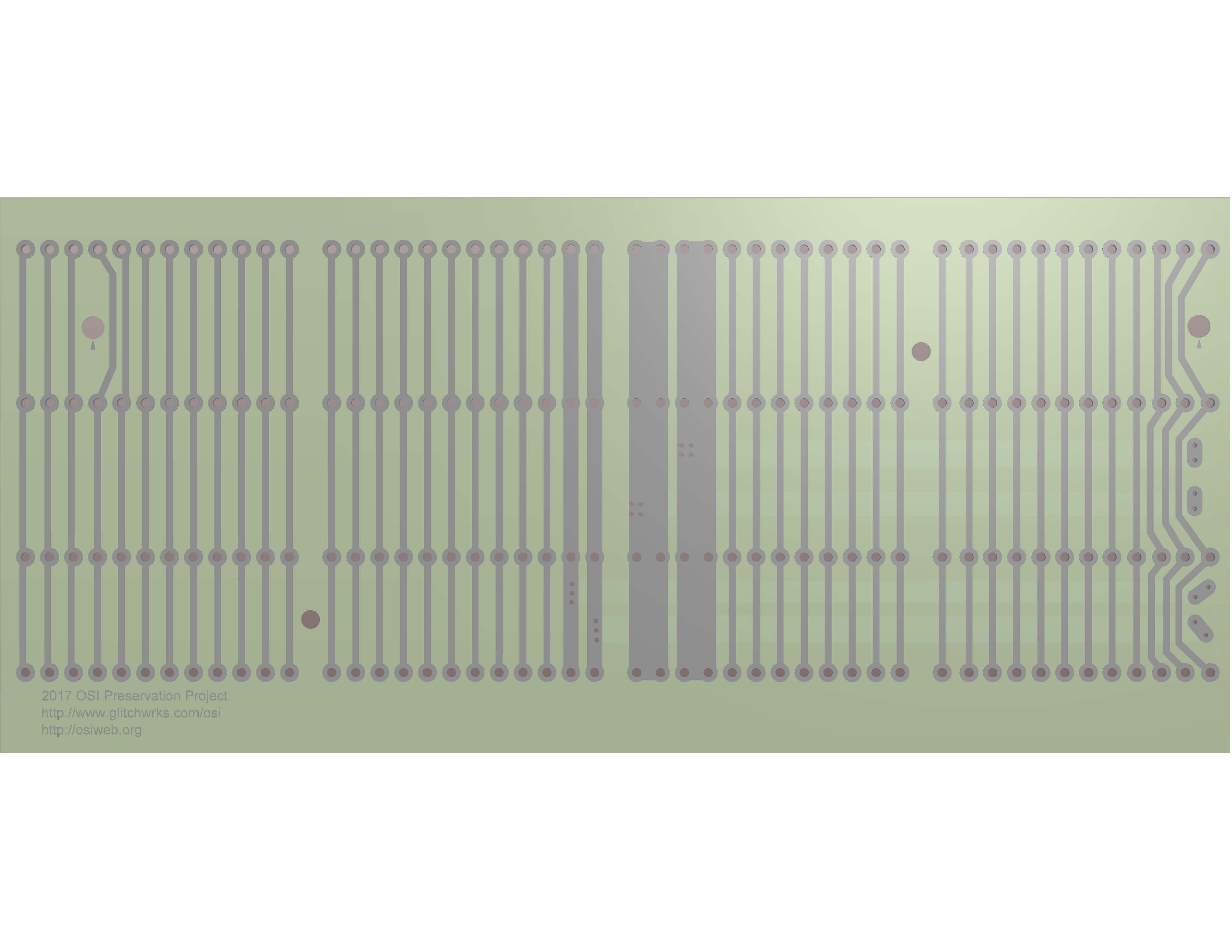

Just processed the scans of the 502 and 582 boards as well. 3D renderings of the resulting PCBs below:
Also, I've gone through all the other scans and done some more font fixes (Thanks to Phil), cleaned up some solid shapes to improve performance and improve rendering accuracy, and as part of the process, restored some manufacturing marks that I originally deleted due to their processing times.
