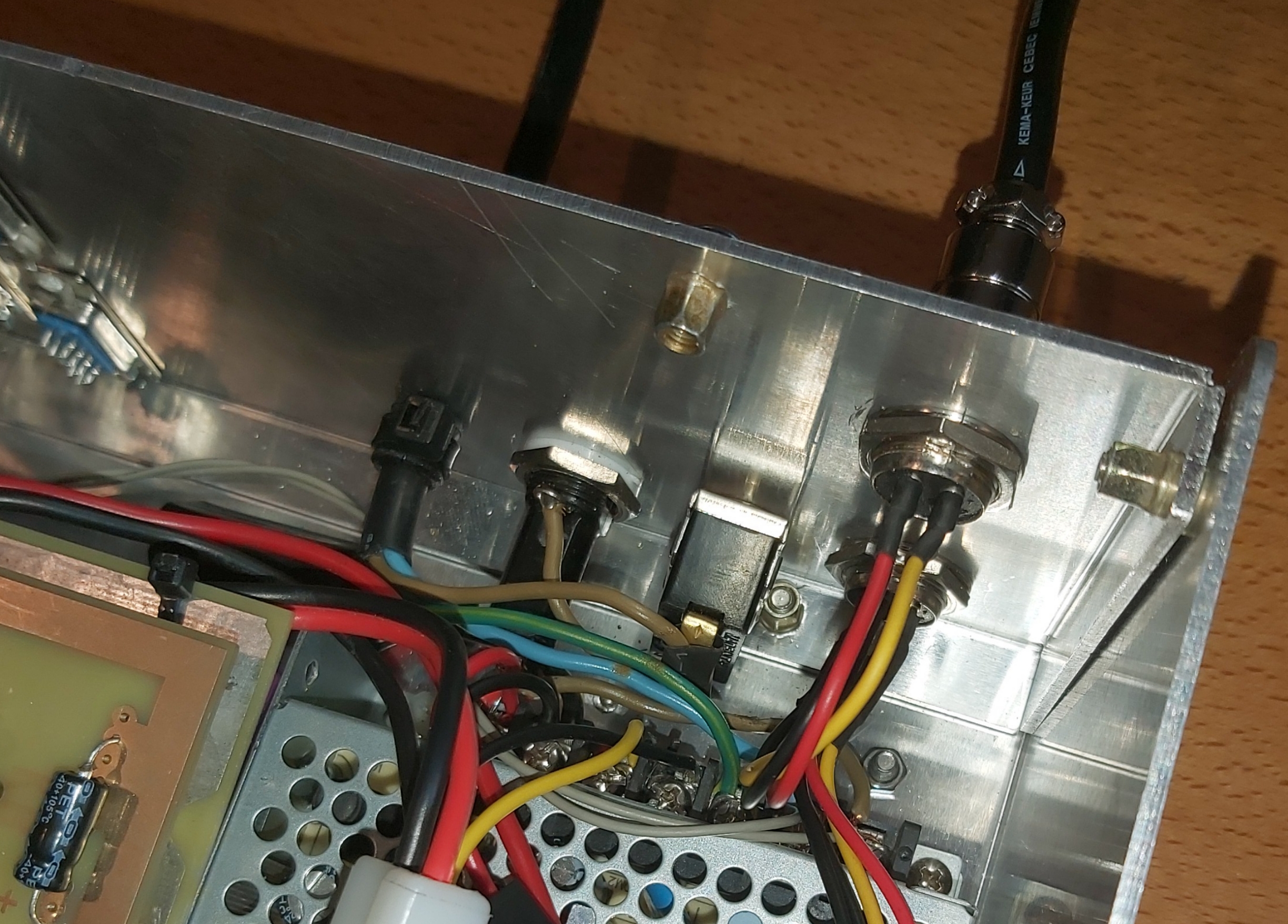

Today, I tidied up the power wiring and added two 4-pin sockets on the rear right... (CB radio microphone plug/sockets )
12v and 5v DC in each socket, for periferals.
Pin1 12v, pin2 0v, pin3 0v, pin4 5v

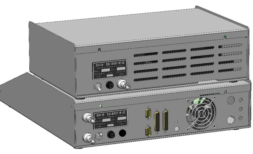

And, I started designing the enclosure for the MPI 51 floppy disk drive. For visual design ques, I searched and searched for a picture:
I only found ONE advert for the C1P-MF...
C1P-MF advert.jpg (72.95 KiB) Viewed 8072 times
Thinking about how to incorporate the Gotek into the enclosure:
Maybe a 2nd "dummy" 3D printed MPI 51 facia, next to the actual drive, with the Gotek mounted in it, recessed behind a psuedo disk door / flap....

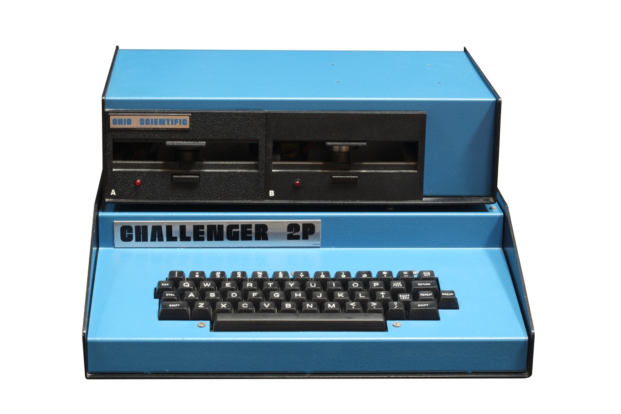

It would look like this dual floppy drive unit...

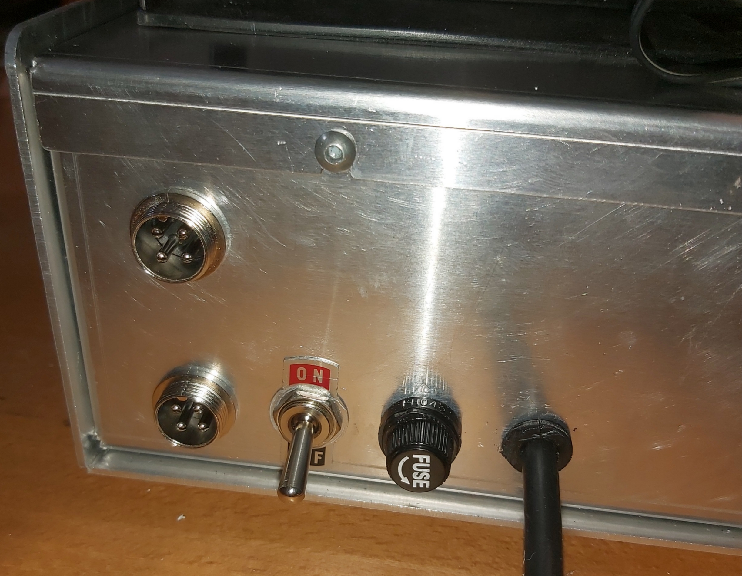

that's a pretty hefty aluminium housing. You probably never will experience any grounding or shielding issues ;)
A Faraday cage it is!

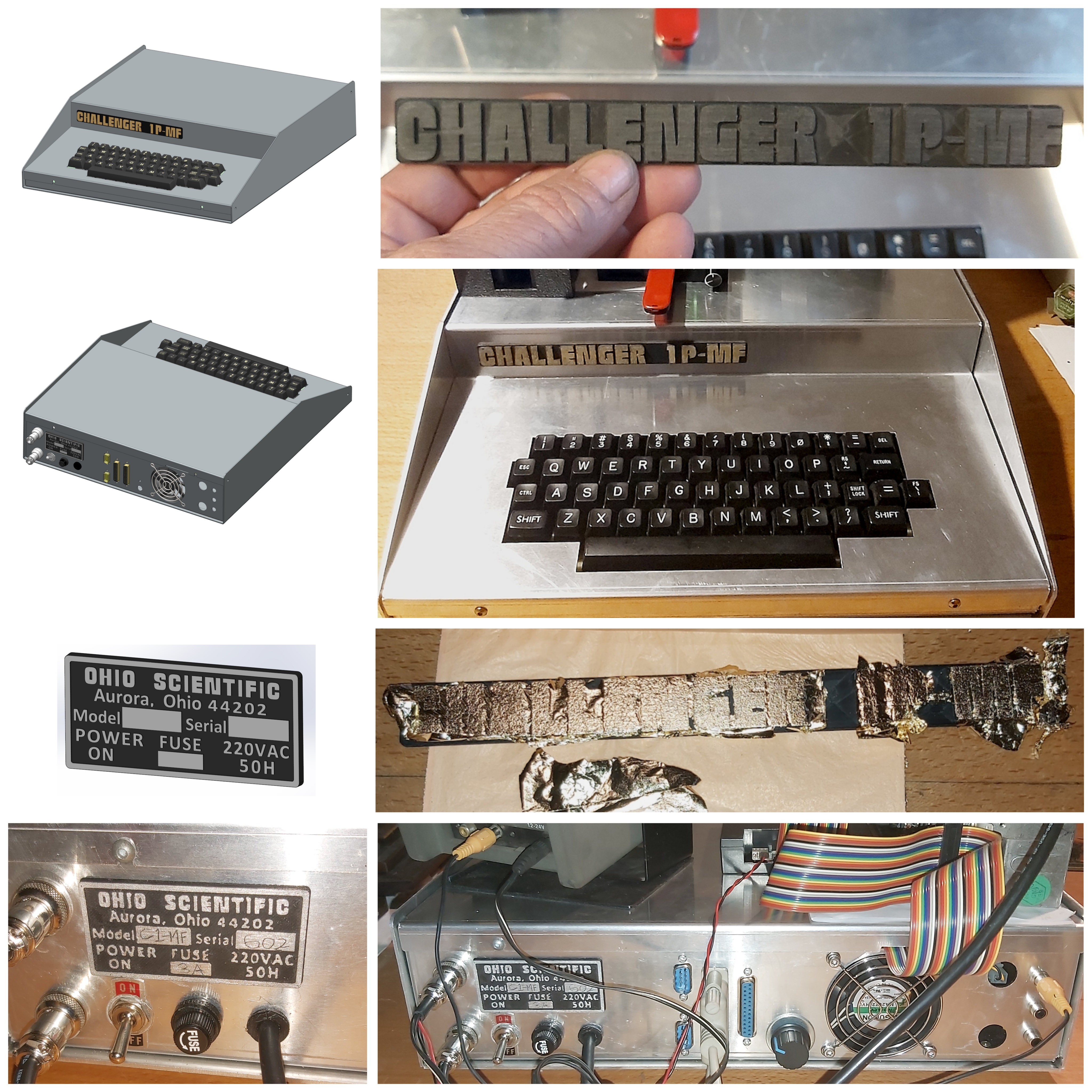

Today, just for fun, I decided to put the finishig touches on the case. (it's raining so I can't play outside :roll: )
I made some "badges" (3D printed), that "almost" replicate the original.
Seeing that I don't plan on painting the case, it will stay "silver", but a silver badge on the front would not be ideal... Why not GOLD?
So, by carefull application of some gold leaf on the front badge... Voila!
The rear "power" badge, was quite challenging, as it is small, so it tested the limits of the resolution of my printer...(if you look closely, little 'z' in the Hz unit at bottom right, did not print)...
The bage is printed from black plastic, and it received some silver highlights, which contrasts nicely...
The original were cast in Zinc, I think...
Slapping some 21st Centrury, 3D PRINTED bages on a 40+ year old, 20th Century design, tickles me :lol:

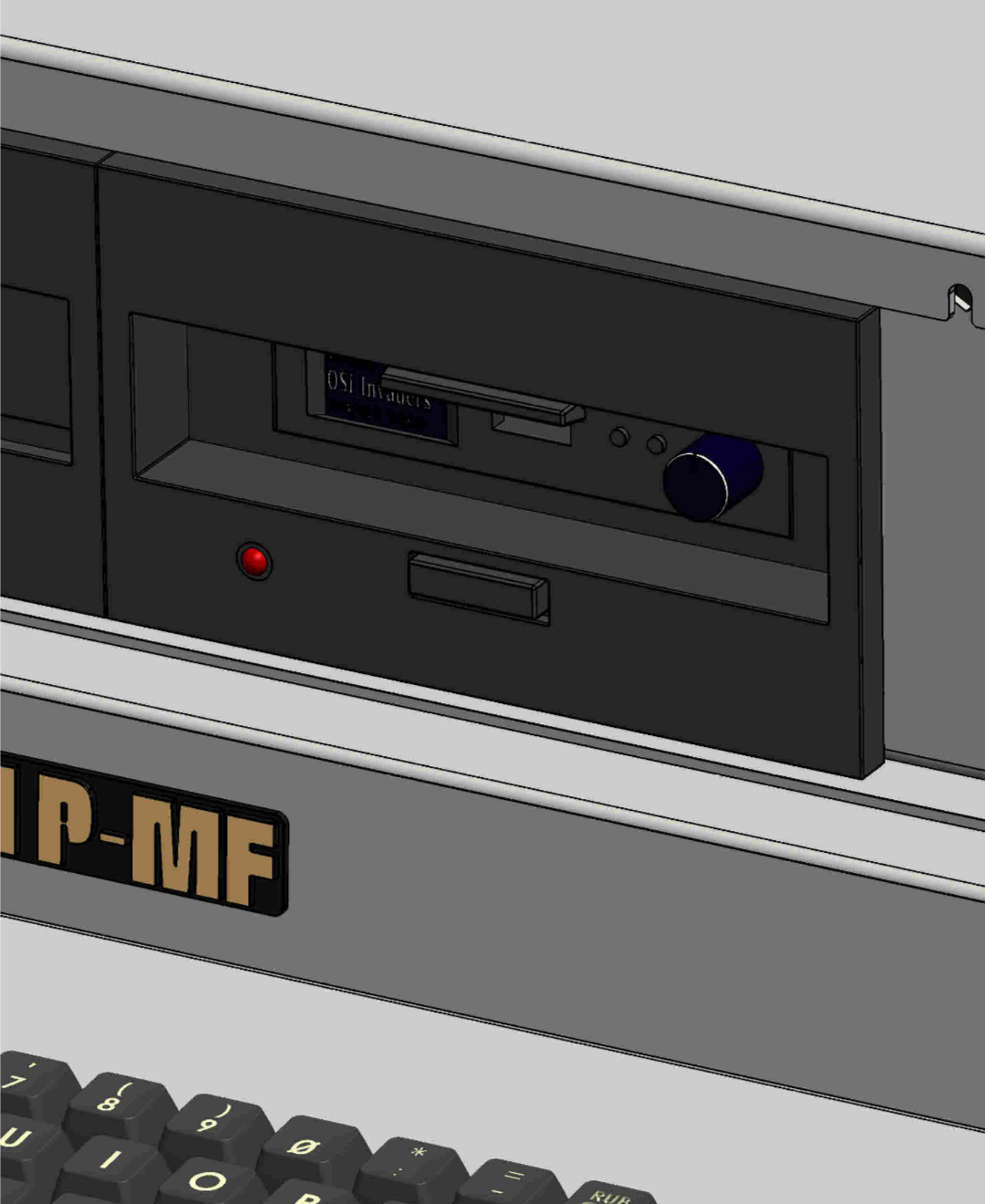

Here is the disk drive enclosure design...
The Gotek fits nicely behind the door of the 3D printable MPI51 facia...
C1P-MF GOTEK.png (360.5 KiB) Viewed 8004 times
