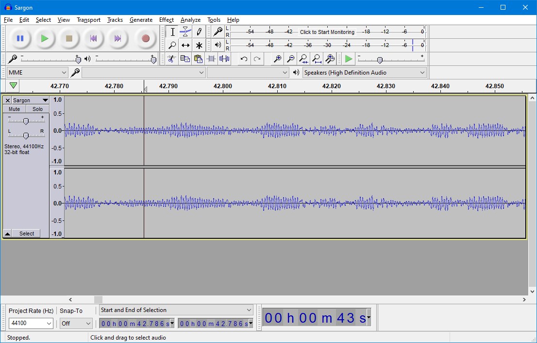

The leader sounds good, but when the actual data arrives, it sounds like the tape head alignment is not quite centered or there is an automatic gain control that cuts in & reduces volume? Or it's a microphone capture of the original?
Anyway the audio levels are about half of what they could be, but too low for OSIKCS... it really likes things with a large swing from the zero crossing just below the point were there is a lot of clipping.
It's strange that the 1200Hz signal is so much lower in volume than the 2400Hz signal.
Audacity is a good program to use to view & manipulate the audio, but the signal levels are a bit too low to process for OSIKCS.
Audacity
Audacity
See if you can get a sample with more amplitude.
