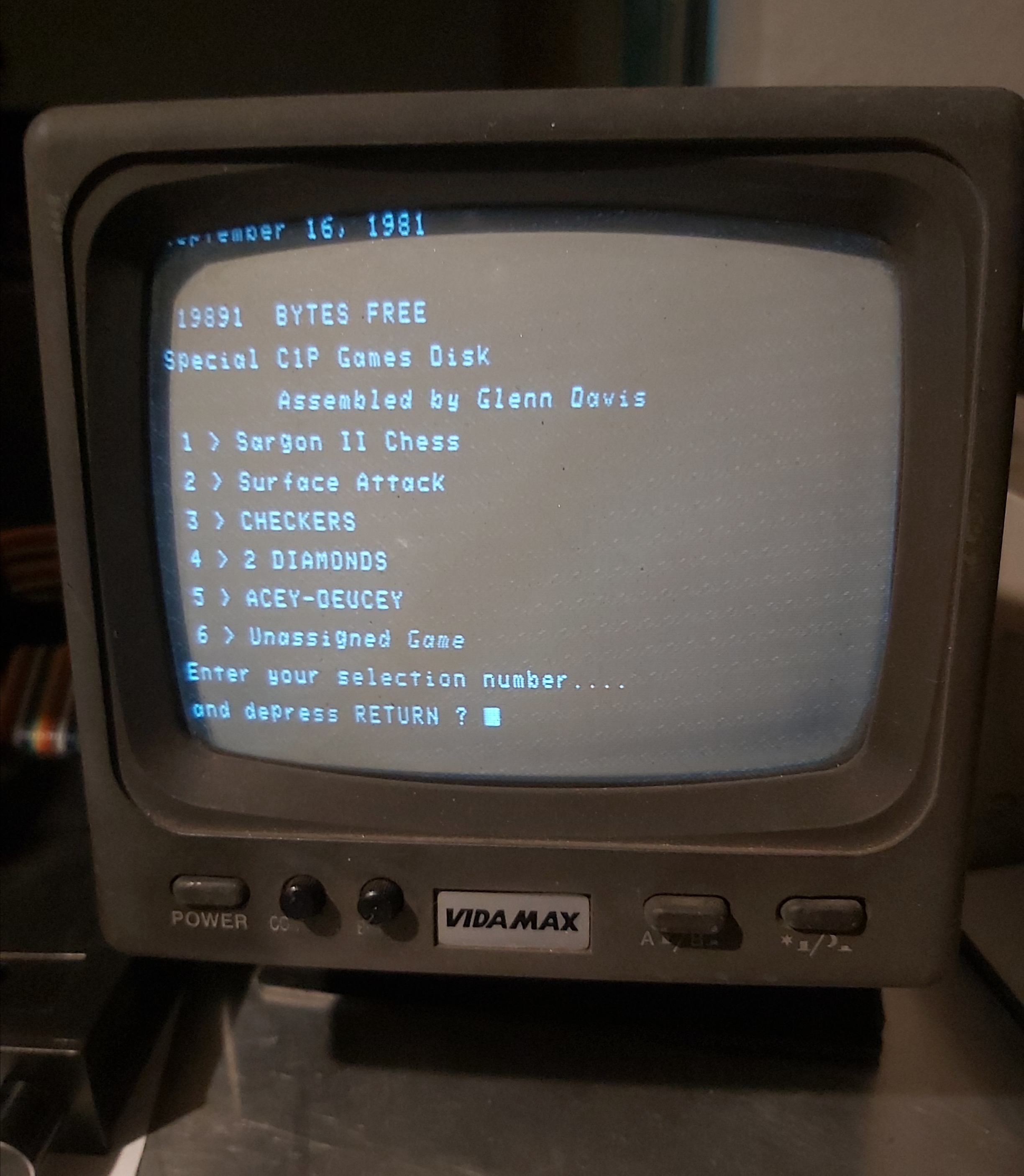

davisgw wrote: Wed Mar 26, 2025 6:20 pm As promised, here is the OS65D games disk I promised, both the diskette and Gotek images. I have verified the Gotek image boots on my 600D and that the games run. But I have not verified they are fun ;-) Enjoy them anyway!
Well, I copied your game disk .hfe file to my Gotek and it booted just fine :D
I then made a physical 5¼ disk by copying it from the Gotek to my MPI drive...
It boots and runs all the games perfectly!
Thank-you!

Do you like the games?
Definately !
Surface Attack brought back some fond, 45 year old, memories of similar Atari 2600 games :lol:

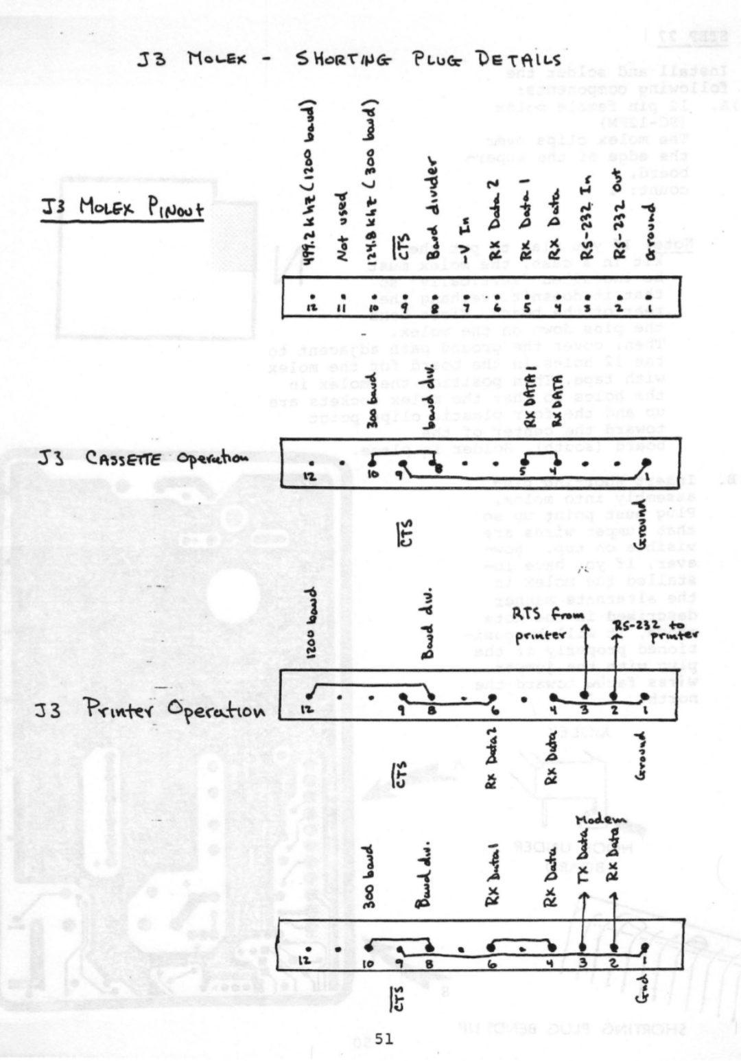

I tried my idea on one of my 600D boards to get switchable 300 or 4800 baud by adding a switch to J3-8, J3-10, J3-12 and connecting U30-14 to J3-12. But nothing I've tried seems to work at 4800 baud. First I tried cutting the board land at U29-12 and connecting it to U30-14. Then I cut both ends of the board land to J3-12 and ran a coax from U30-14 to J3-12 and tried the switch again...I get only garbage on the PC side. On my 600B board direct connecting U30-14 to U57-2 works just fine but it's not switchable. So I'm missing some other detail.
Is there something different between the 600B and 600D boards that I'm missing? Any suggestions/ideas please.
I haven't (yet) tried cassette / printer baud rate higher than 300.
However, the assembly manual only eaxplainsa how to wire and jumper the rear connectors.

Well, as I suspected, there IS a difference in the clocking between the 600B and 600D boards. After much head scratching and reviewing my changes to the 600D board I discovered that connecting U57-2 to U30-14 (C0) yields a serial port speed of 9600 baud, not 4800 baud as it does on the 600B board. The correct change for the 600D board is to connect I57-2 to U30-13 (C1). So my change to add a switch to J3-8, J3-10, J3-12 and connecting U30-13 to J3-12 for the switch selection for 4800 baud works perfectly! Thanks to all who helped even if the help was misleading ;-)
On the plus side I've become an expert disassembling and reassembling this 600D system....
