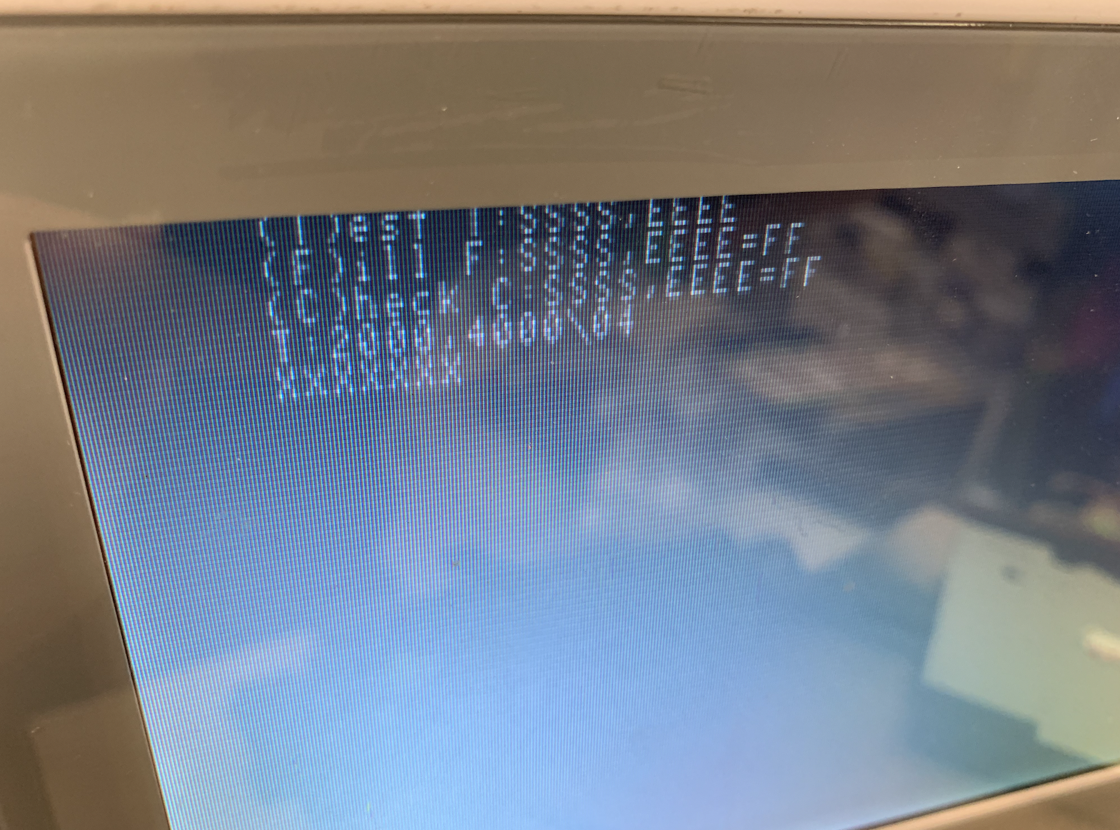

I ran t, 2000, 4000. it has been running for about half an hour. X means successful test of that entire range? no errors there?
- Screenshot 2023-03-07 at 12.04.44 PM.png (4.03 MiB) Viewed 29710 times
Re: Challenger C4P estate sale find project
Yeah, it prints an X when it loops through all possible RAM test values in the specified range. Otherwise an error would cause it to stop & print the address with the read & write values.
Try T:0400,2000 too
To see what it does you can try T:D600,D700 & watch the data shift by on your screen.

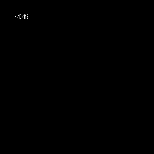

Whelp, I had some time to look at the C4P again today. And another problem. it will not reset with the break key. Garbage stays on the screen. The break key seems to simply ground the reset pin on the 6502.
Clock is present, and there is a probe signal on all address lines, so I'm hoping it is still basically functioning. I've poked around on the other chips and I do see activity.
Any tips for how to diagnose why this thing will no longer reset to the D/M/? prompt?
