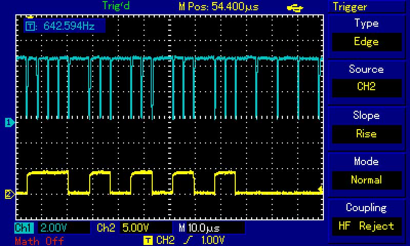

Hi Folks,
Trying to figure out why I can only write $24 to a disk.
In this scope image, the yellow trace is the inverted data coming from the floppy ACIA as I write $AA to it. The blue trace is pin-9 going to the D-13. Does this look correct?
Re: Building the KLyball D-13
At a glance, it looks correct. 1 start bit, 10101010, 1 stop bit.
The blue trace looks like clock + data pulse for 1, clock only for 0, providing the frequency modulation. Each pulse in the blue trace should be close to 400 ns.
