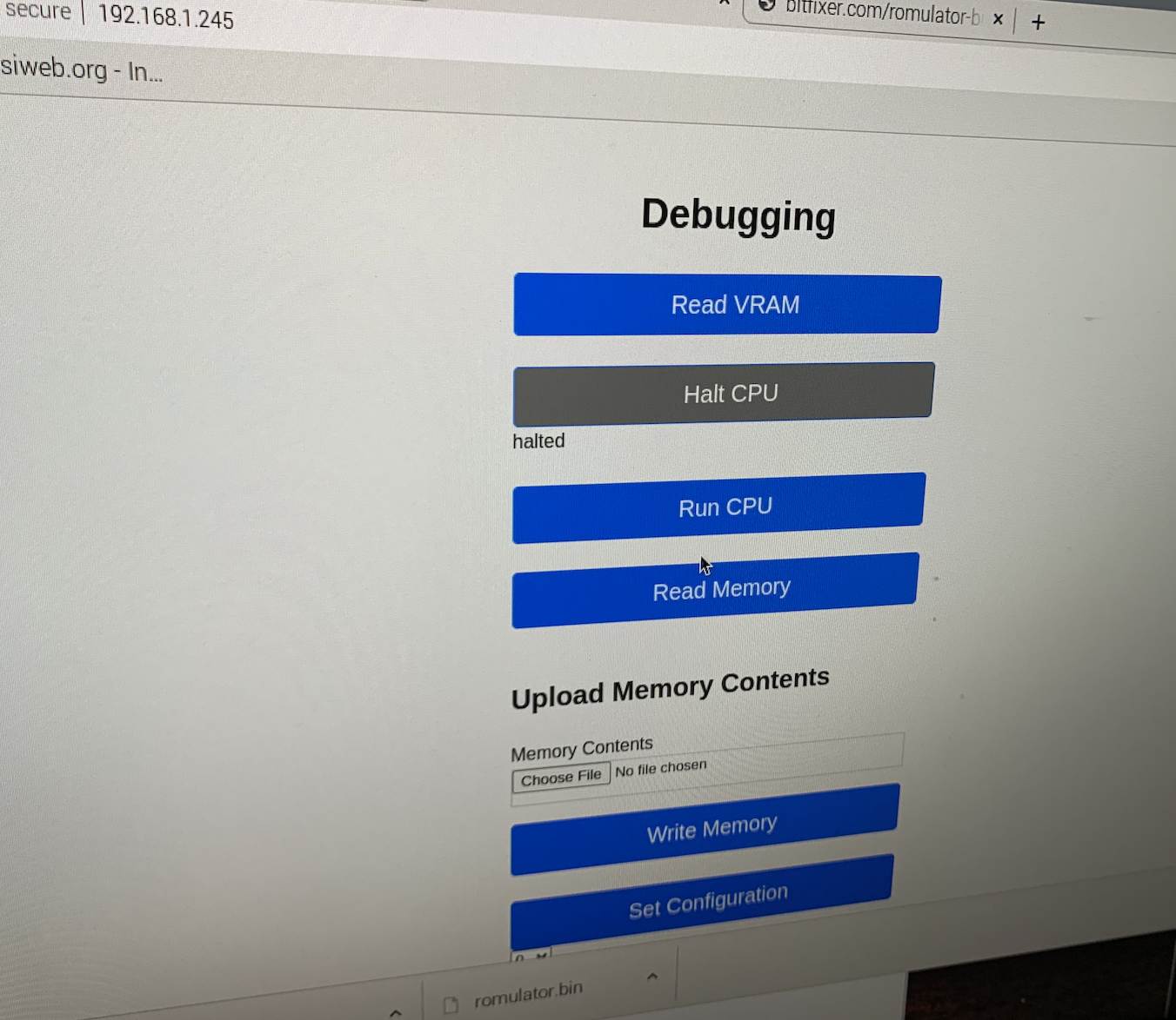

Romulator update:
I built up the 2nd romulator 6502, the pi hat, and the direct (non-pi) cable. fully installed the bs-romulator files on the pi using the setup.sh.
I created the 2 config files and used the make program command using the pi's command line/terminal. it went through several things but kept giving me a couple of build errors due to missing files that I have not figured out yet.
so I plugged in the direct RPI ROMulator programming board. it creates a web server for the romulator. bit fixer's site has an upload facility to create the programming bin by uploading the two csv config files and the rom bin. this seemed to work and gave me back a single bin to program with.
I downloaded the memory of the romulator after a power cycle. I get the garbage screen, and a pin 40 reset or web reset does not change the screen.
do I have the memory ranges configured properly in the memory_set file?
I do see the H/D/M prompt in the last image. do I need to be viewing with a hex editor?

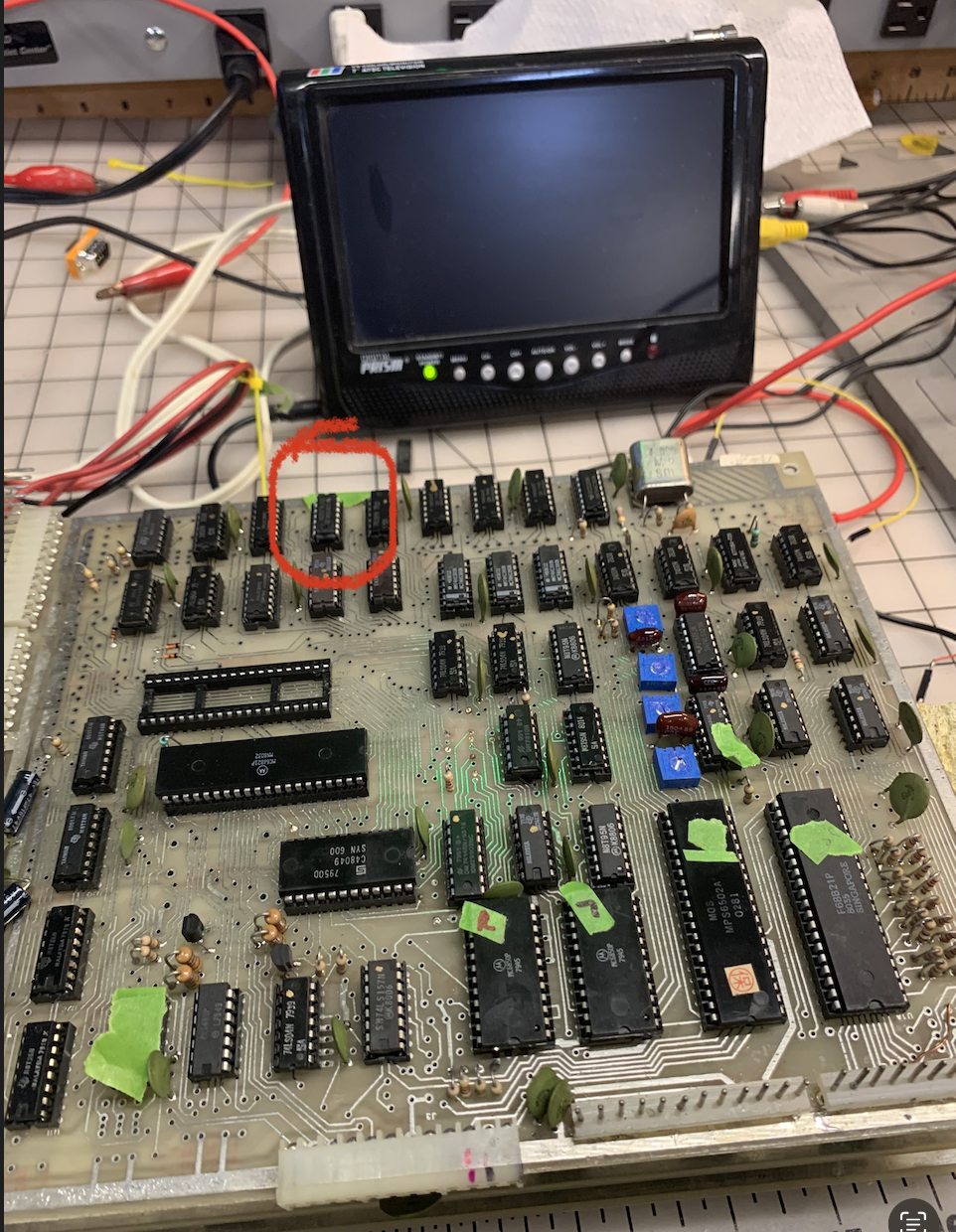

Summer project (deck rebuild) is finished and my head has cleared somewhat. It's been about a year since I picked up this C4P. it worked except for some bad RAM and bad floppy, I had a data separator and gotek partially working, then it stopped working and would not reset to the prompt.
The 7402 in red circle was bad. Replaced it and I AM BACK IN BUSINESS as it BOOTS AND COMPUTES (sorta).
I get the prompt now, so hopefully I can finish this by this time next year! YEEEHAAAWWW!!!
