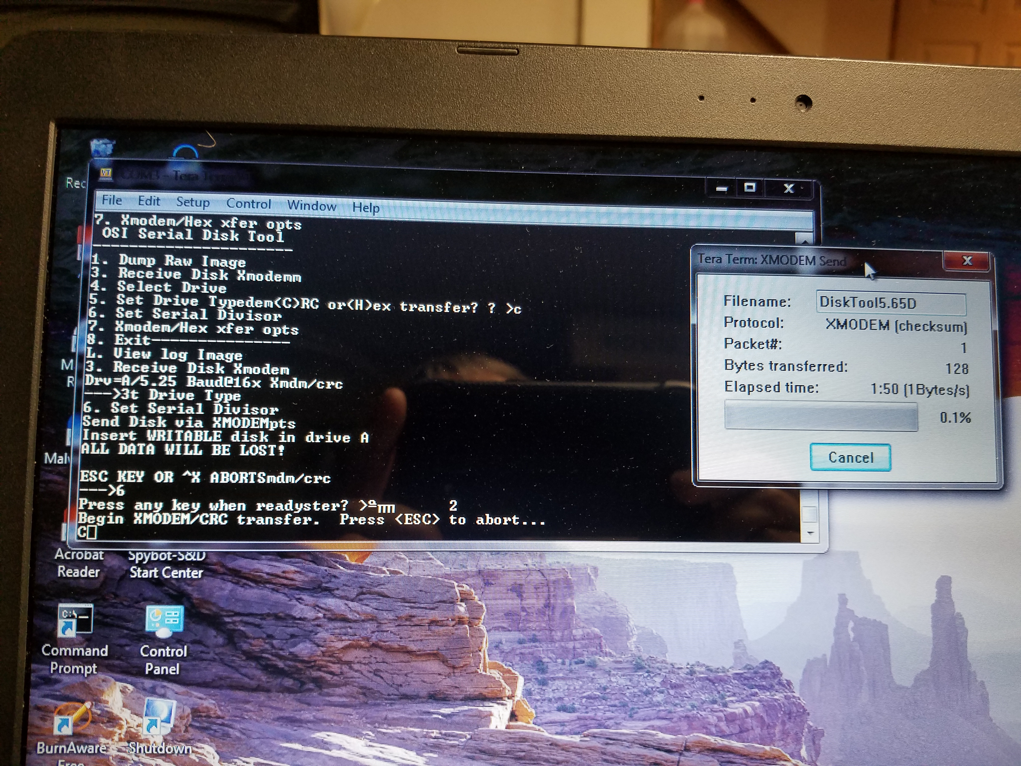

I get the menu at 300 baud and when I change to 4800 baud it is not re-displayed, even after typing something other than a menu selection or doing a reset terminal. But I get the expected query when I type option 7 to set xmodem/crc mode. Then I type option 3, type "Return" for the "Any key" prompt, and the floppy drive seeks to track 0. At that point I start the transfer and only ever see 128 bytes transferred. See the picture of the terminal screen. The same happens if I leave it at 300 baud.
The bottom "press any key" prompt wrote over the prompt for "changing serial divisor" prompt and the garbage after was the response to "F". Then I changed the terminal port to 4800 baud.
Of possible relevance is that my version of TeraTerm is 4.105

I noticed the only difference between your instructions and my experience is the "Spacebar" response to begin the transfer instead of "Return". I tried that at 300 baud and it started OK so I tried it again at 4800 baud and only got the usual 128 bytes transferred. So I started again at 300 baud and the transfer and disk writing completed!! Apparently typing "Return" is not an expected response. Then I booted the disk and got the "OSI...." message....
I did not try anything more.
Is the menu supposed to display on the terminal?
And how do I change the port to 4800 before transferring the contents of a floppy?

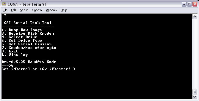

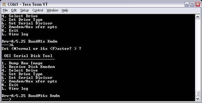

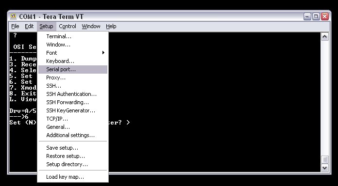

Re: Superboard Expanded on S-100 motherboard
I'm glad you were able to write a floppy! I just retried this procedure again with real hardware but did not experience any glitched screens or communications problems.
On reset the OSI computer initializes the ACIA with an input clock divide by 16 setting. On cassette based systems this yields a baud rate of 300bps although it can be wired for other speeds depending on the specific hardware (C3-OEM systems may use 9600 by default for example). We can alter the ACIA clock divisor setting for divide by 1, thus instantly changing the speed to 16x faster. This gives you 4800 baud on a normally 300 baud system.
To do this:
After booting DiskTool and seeing the menu, select option 6 "Set Serial Divisor"
OSI Serial Disk Tool
1. Dump Raw Image
3. Receive Disk Xmodem
4. Select Drive
5. Set Drive Type
6. Set Serial Divisor
7. Xmodem/Hex xfer opts
8. Exit
L. View log
Drv=A/5.25 Baud@1x Xmdm
--->6
Set (N)ormal or 16x (F)aster? >
The enter 'F' or 'f'
The OSI immediately changes the baud rate from whatever it started with to 16x that speed and redisplays the menu.
You will not see that menu because your terminal is still talking at the slower speed. At this time you need to change your terminal communications rate.
If you were using 300baud, you must now change to 4800 baud. If you are using 9600 baud, you need to go to 153.6K! (which is too fast for a 1Mhz 6502 most likely.) If you were using 2400 baud, you need to switch to 38400 baud. Having just pressed 'f' I can no longer communicate at 300 baud. So I change the terminal speed in TeraTerm The DiskTool menu will only redraw when it receives a printable character (space to ~) it ignores carriage return, line feed, null etc.
So I press <space> (or any other character) and the menu is displayed again.
The menu status like will show Baud@16x At this point all communication should be done at 16x. You should not change speeds when starting a transfer.
When prompted to press Any Key, you can literally enter any character. It is just waiting for the next input from the ACIA. Space works fine as does Carriage Return. Not sure why you are experiencing different behavior.
What PC serial port hardware are you using? I understand some USB to RS-232 adapters have problems and bad or even intentionally sabotaged drivers!
