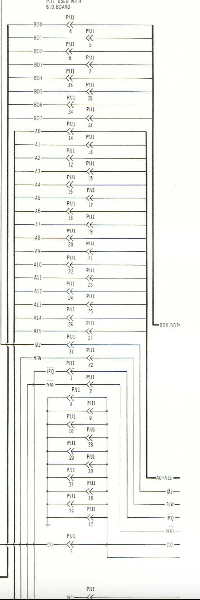

Just to help out with the troubleshooting, I made a diagram of J2 on the 610.
Screenshot 2025-04-27 at 09.35.31.png (163.45 KiB) Viewed 64 times
Cross checking this with J1 on the 600, and it doesn't seem to match, am I missing something here? I thought the connector was 1 for 1 straight through.
Screenshot 2025-04-27 at 09.53.58.png (1.38 MiB) Viewed 64 times
Ot have I made a rookie error?

I think I have made a rookie error, whilst J2 is correct, it isn't where the main 600 board plugs in, so I need to go back and make diags for J1 on both the 600 and 610.
I obviously got an idea in my head that J1 on the 600 plugged into J2 on the 610 and the other socket on the 610 was J3. Not sure why I thought that, but I have it correct now.
J2 should be a good point for probing signals though :)

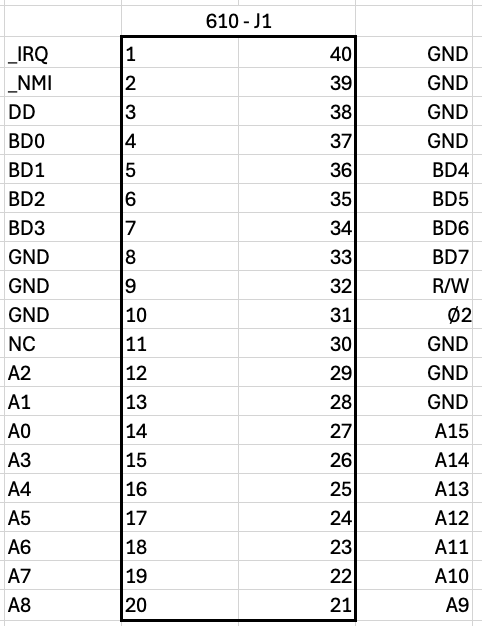

OK, head successfully straightened:
600 board J1:
Screenshot 2025-04-27 at 14.42.48.png (58.3 KiB) Viewed 58 times
610 board J1:
Screenshot 2025-04-27 at 14.43.31.png (58.6 KiB) Viewed 58 times
And 610 board J2:
Screenshot 2025-04-27 at 14.43.48.png (59.39 KiB) Viewed 58 times
Not sure it'll help anyone other than me, but I at least know that is is straight through pin connection from the 600 to the 610 now (I thought it was but nice to confirm) and I can start to trace the signals to see what's what.
