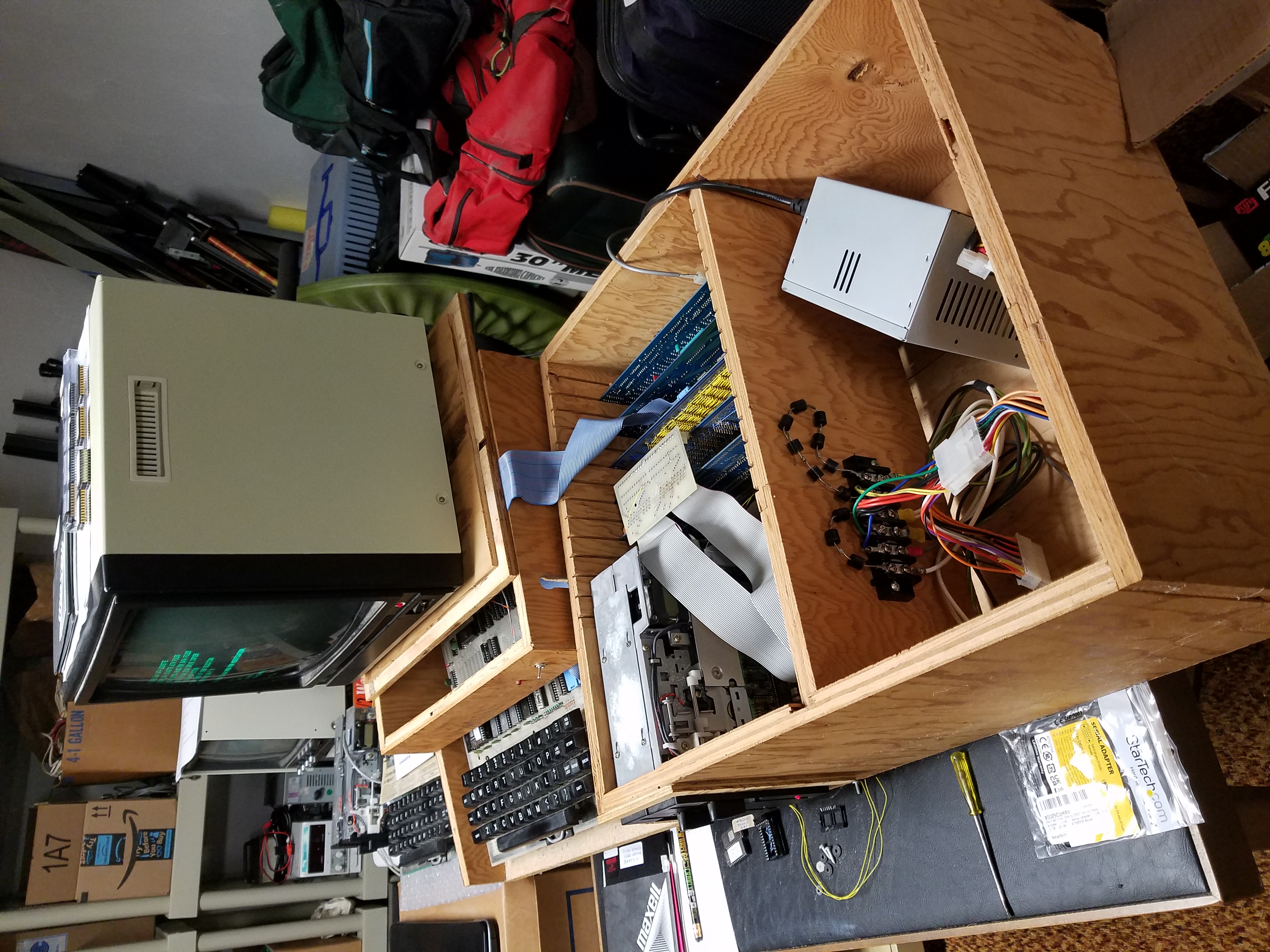

I'm attaching a couple pics of my systems for your viewing pleasure....
Once again my thanks. I started to modify track 0 on a copy of my WP6502 floppy only to realize at some point I had based it on 65D 3.3. So after verifying that running BEXEC* after booting from disk 2 successfully loaded WP6502 I tried a new approach to creating a working disk....I copied 65D from disk 2 to a blank disk, modified track 0 to point to my video driver, then created and copied the BEXEC* and program files for WP6502. I worked like a charm. Then I created a 600D disk from disk 2, track 0 modified with your 48 x 13 driver, and created and copied the program files. It also works as
expected.
I only copied BEXEC*, WP6502, WP6503, AND TODWO to each disk. Did I miss anything?
