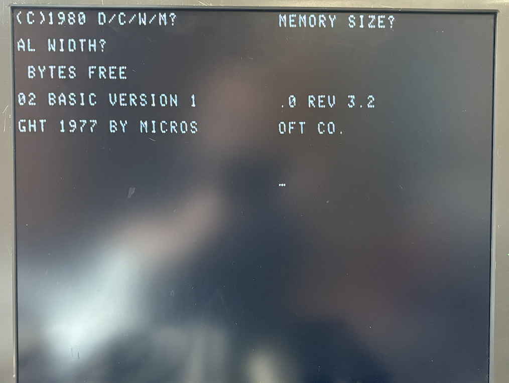

Sorry for the late reply...finally got time to try this out. Is this what it's supposed to look like?
- Posts: 204
- Joined: Sat Aug 27, 2022 4:52 pm
Re: OSI + Gotek (youtube video)
Yes and no. It looks like Hexdos booted but the 48 character video program in track 0 did not execute. Try booting again and type "LOAD/" and then "LIST" to see the directory. The last entry should be "VIDFIX". Then type RUN"VIDFIX" and see if the 48 character mode is activated.
