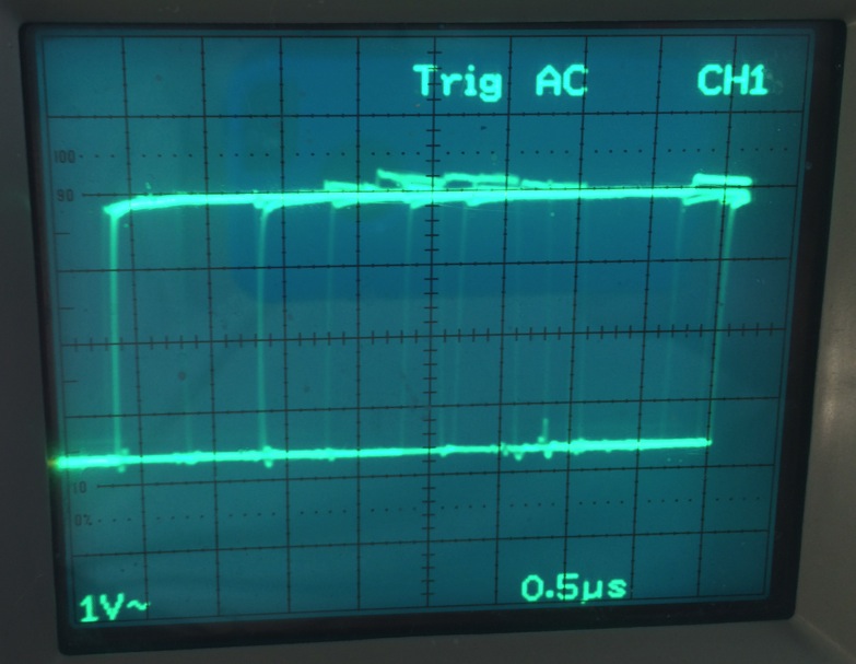

I have spent a whole lot of time investigating the 8T26's and the data bus in general. I first started by removing all the 8T26's from all the boards, essentially isolating the data bus to the 505 board only. All data lines pulsed nicely on the 505 board and the connected circuitry... the 6502, both 6821's, SYNMON, and both the 6850's. I then added back the two 8T26's to the 505 and noted that the backplane side of the data lines pulsed nicely. I then added back the two 8T26's on the 540 board that correspond to the keyboard circuitry. Again all pulsed fine, on both sides (board and backplane). Next I re-inserted the 8T28's that correspond to the video ram (not the colour one). Things read fine on the backplane side, but the video side seemed to read stronger.
This is what I read on the backplane side of the 8T26's:
Video RAM side of 8T26
Screen Shot 2014-04-03 at 9.58.26 AM.JPG (99.6 KiB) Viewed 21594 times
And this is what I read on the 540 side of the 8T26's that buffer the video RAM:
Backplane side of 8T26
Screen Shot 2014-04-03 at 10.00.38 AM.JPG (133.29 KiB) Viewed 21594 times
