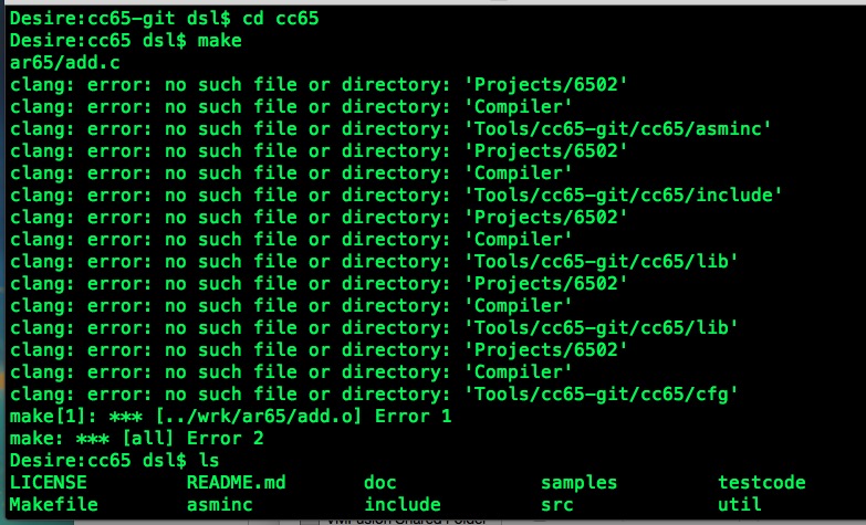

I found the instructions on how to make the package on OS X, but I get an error when I run the make.
Screen Shot 2015-07-05 at 4.39.47 PM.jpg (175.96 KiB) Viewed 12704 times
It seems that someone left hard-coded directory structures in the make file.
Re: OSI Disk Re-creation Project
So. I added the directories in my user folder, and the package compiled. I think that the powers-that-be need to remove that requirement.
