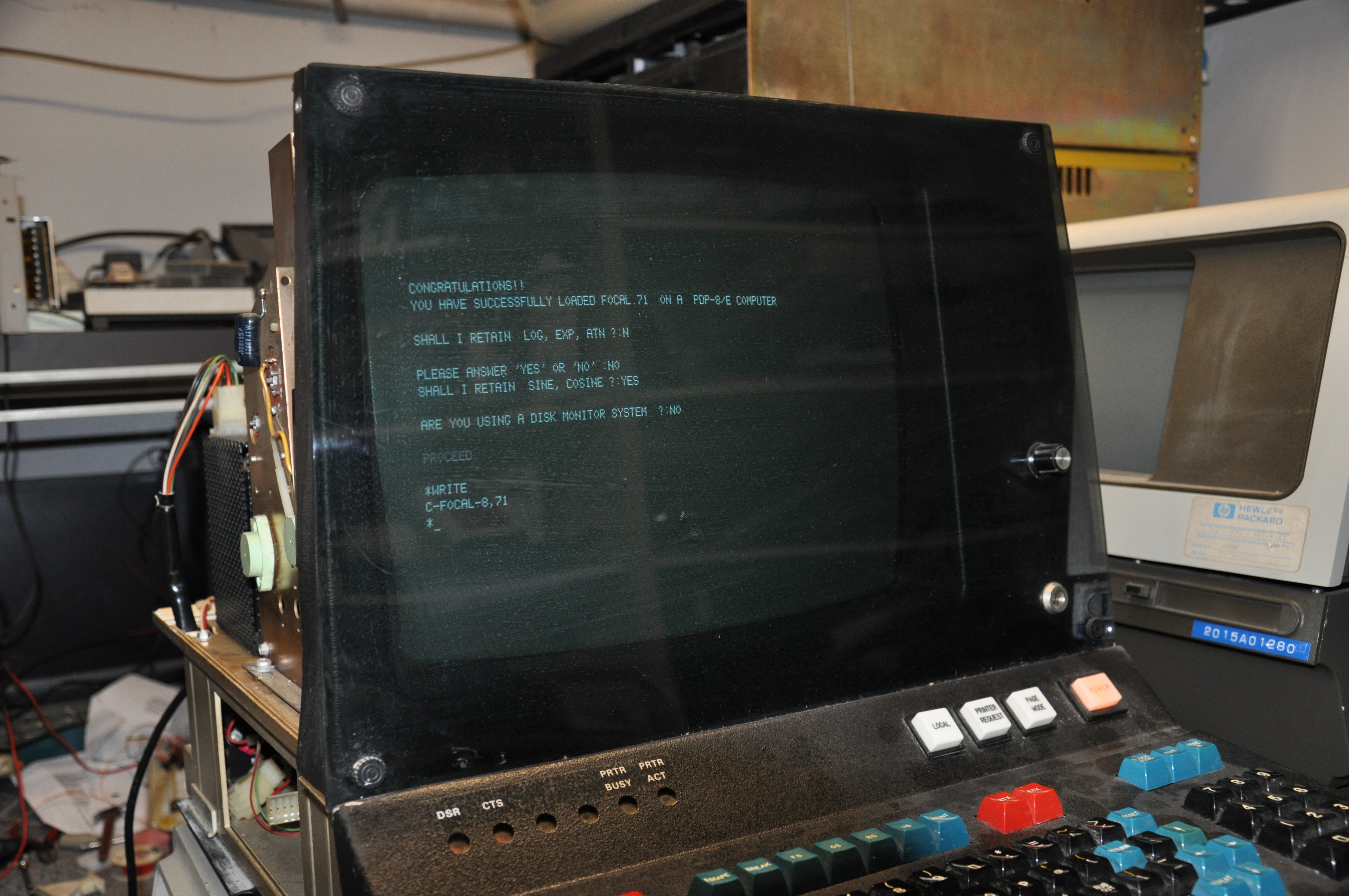

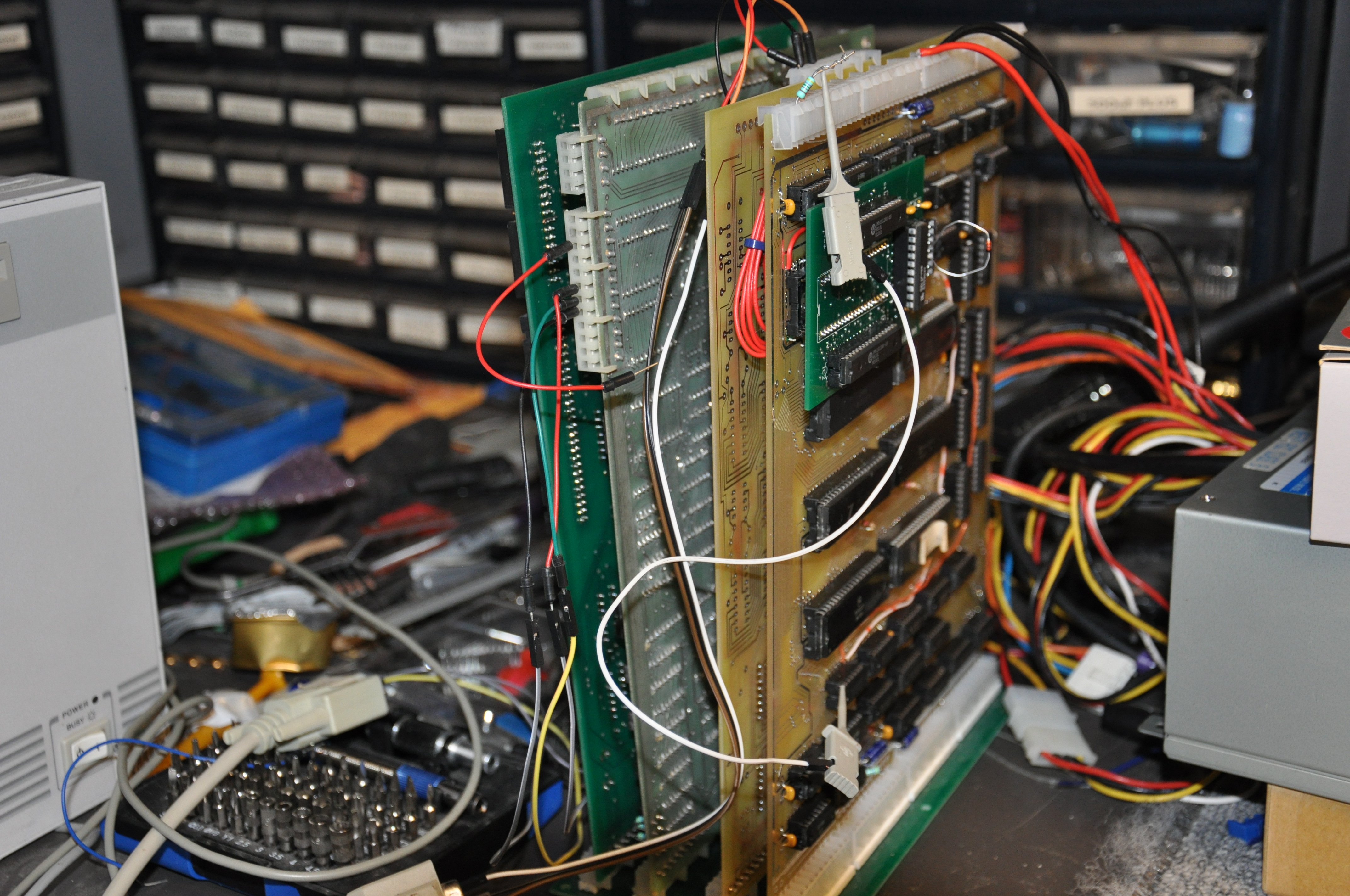

Posts: 237
Re: 560Z Build thread
Working 560z ,drivers tested and working with 430b for pdp or z-80 terminal
Binary loader patched to load pdp papertape images from OSI terminal side.
There is no memory mangement in the pdp iot handler so it will need to be microcoded in (i have been trying to wrap my head around it) to use more then 4k.
My master plan is to interface a heathkit h-8 front panel i have kicking around to the z-80 side
for 6100 side i wonder if this would work should only need a extra serial port and memory management microcoded in
https://github.com/drovak/os8diskserver
here is a good starting point for the IOT's
http://homepage.cs.uiowa.edu/~jones/pdp8/man/index.html
