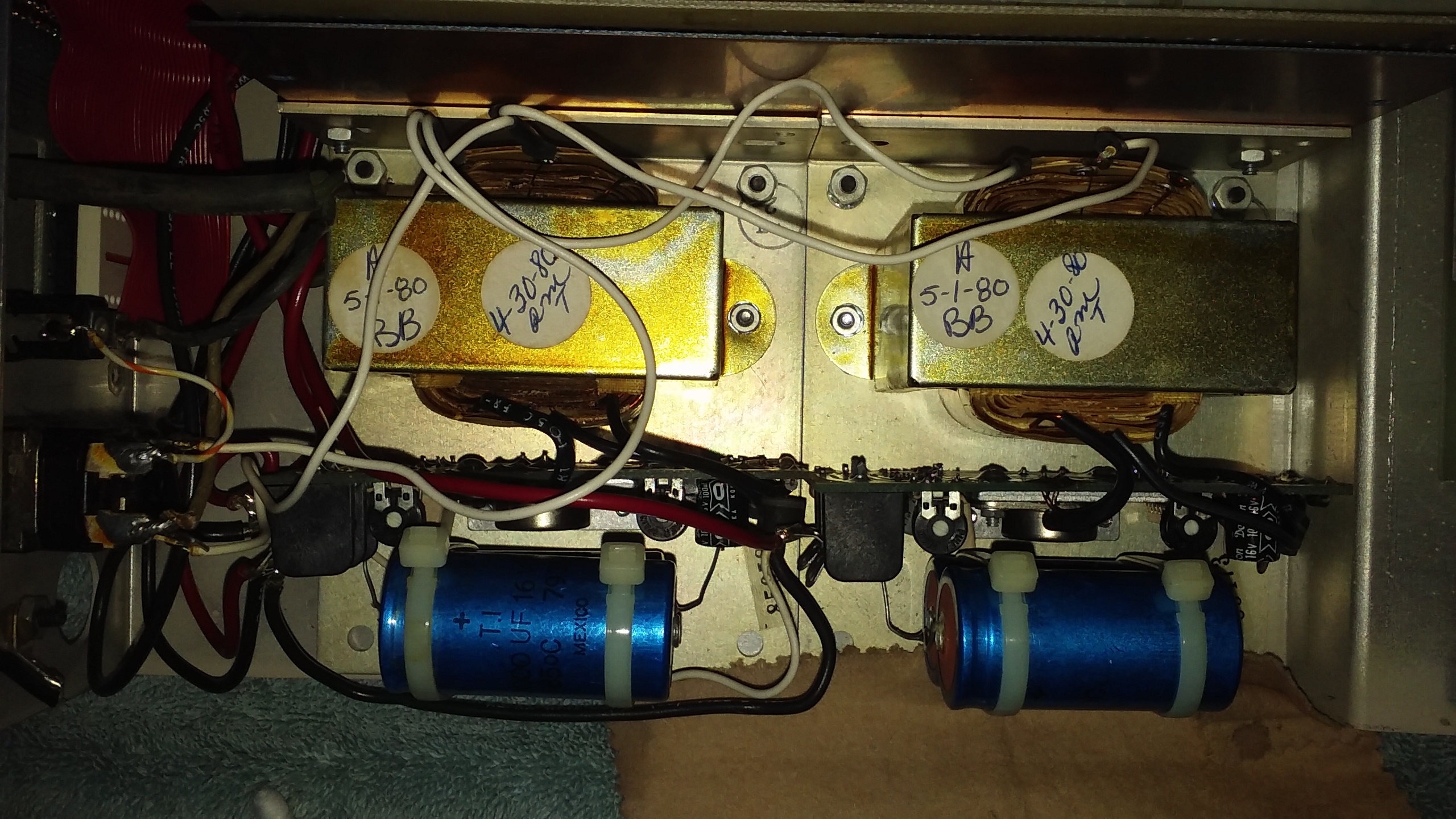

Hey guys, thanks for the responses. It will take me a period of time to do everything suggested, a few hours a week I'm guessing. I did reset one 48 pin connector (didn't clean) and that seemed to be a major help in getting it going... I don't have a scope and over the years I've even lost my soldering iron, but I'll get back into it. I do have a voltmeter/multimeter...
Just a few photos to get started... will take more as I proceed.. and check in once or twice a week.
The overview of the power side...
top side of what i assume are big capacitors, 527 mem one to the the right. Didn't notice until i took these closeup photos but the 527 cap seems to look much better, if that's any indication

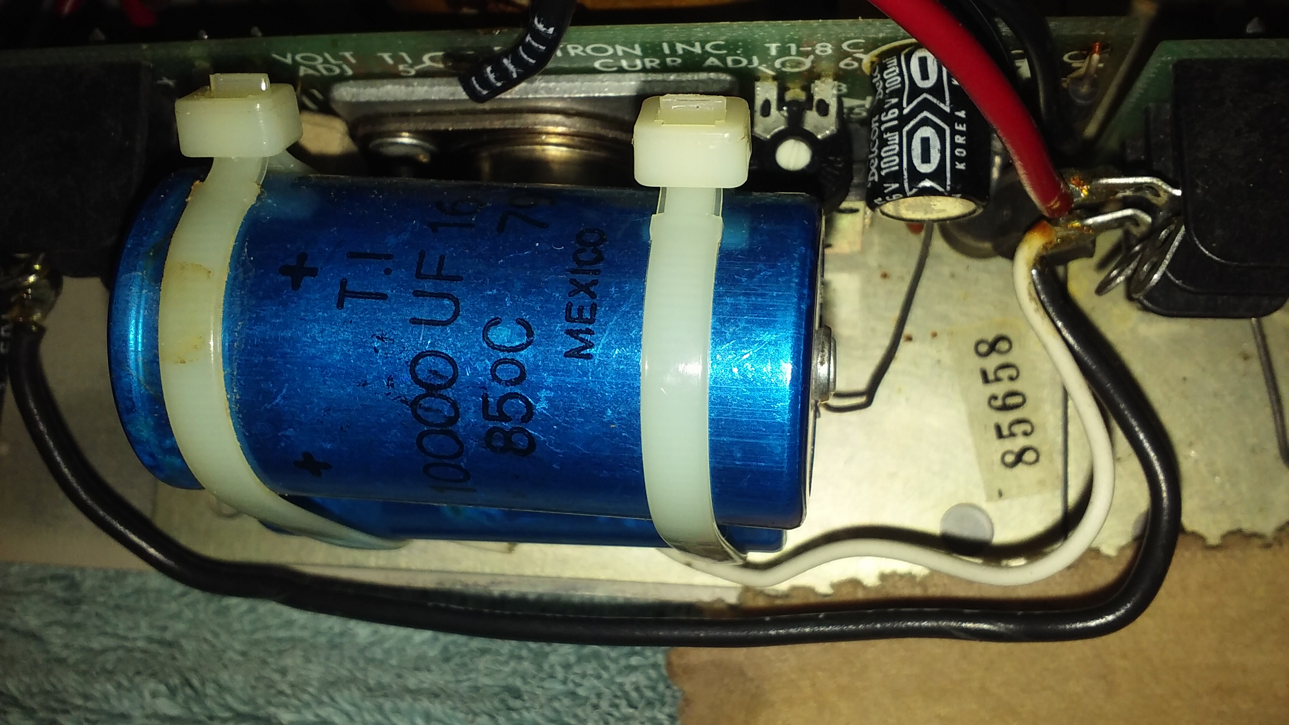

Closeup up of one of the main capacitors

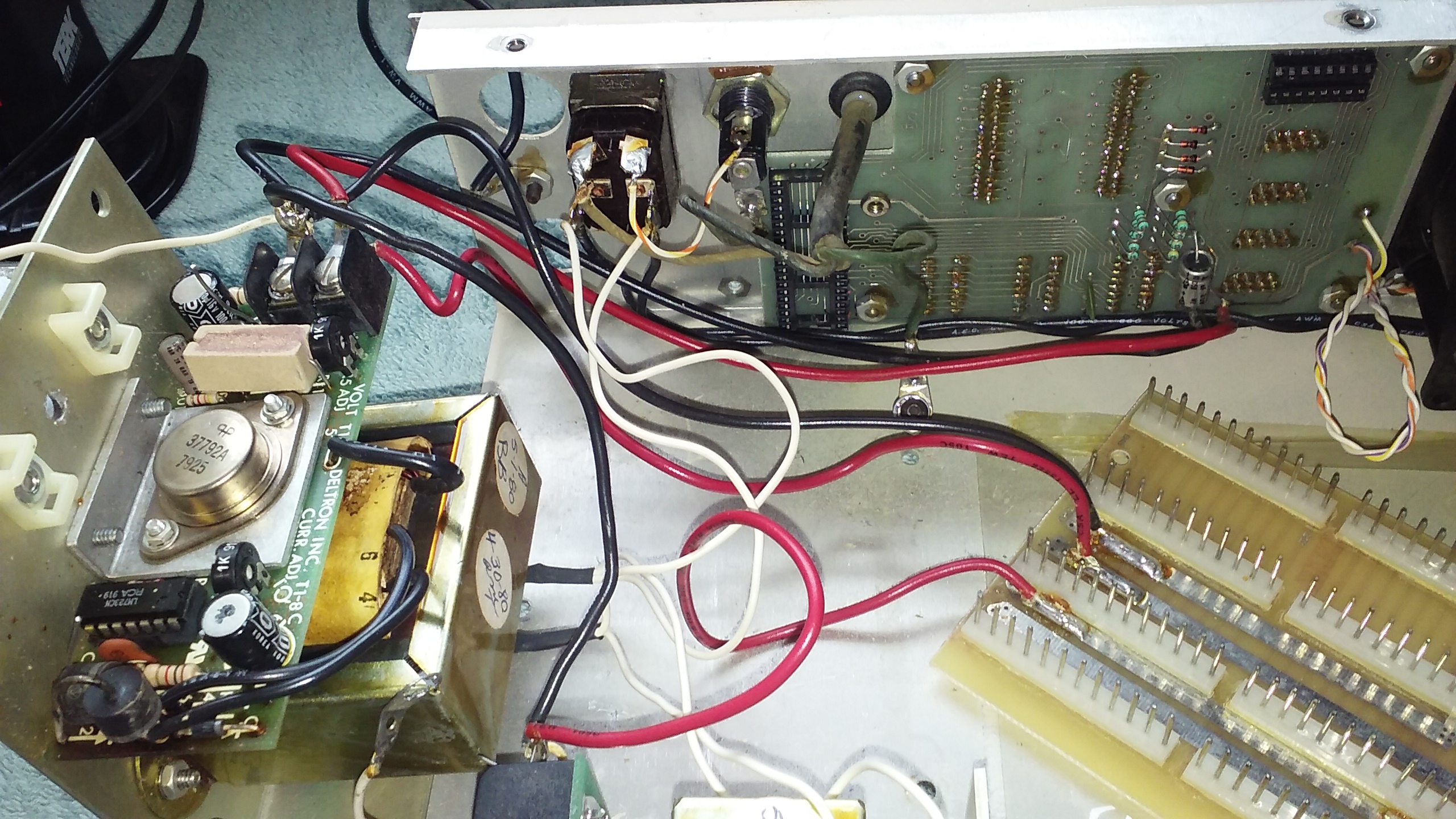

Closeup of the 527 mem , not sure, transformer? I don't have any schematics for the power side at all and couldn't find any...

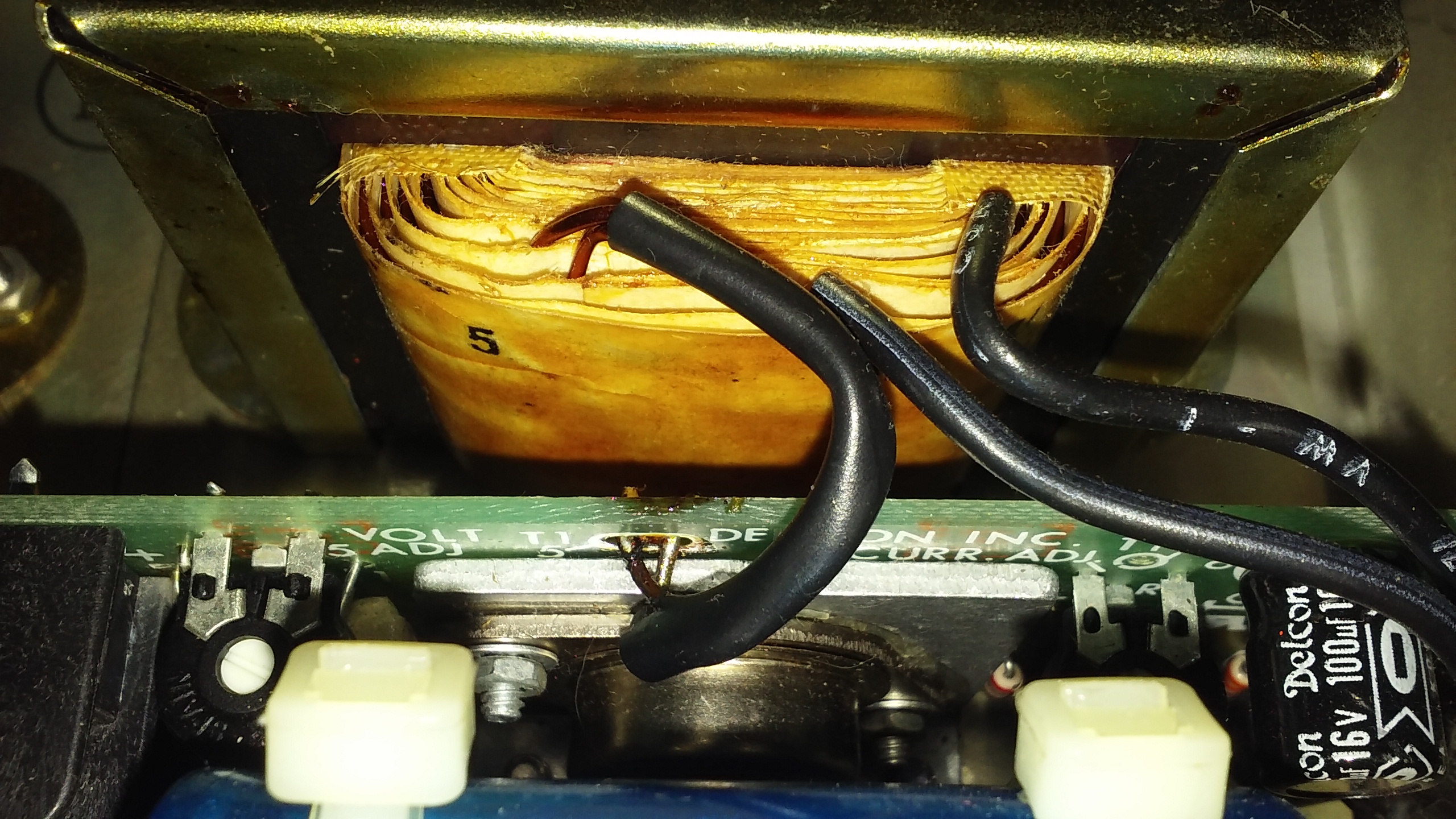

Closeup of the main transformer? This also looks worse than the 527 mem transformer

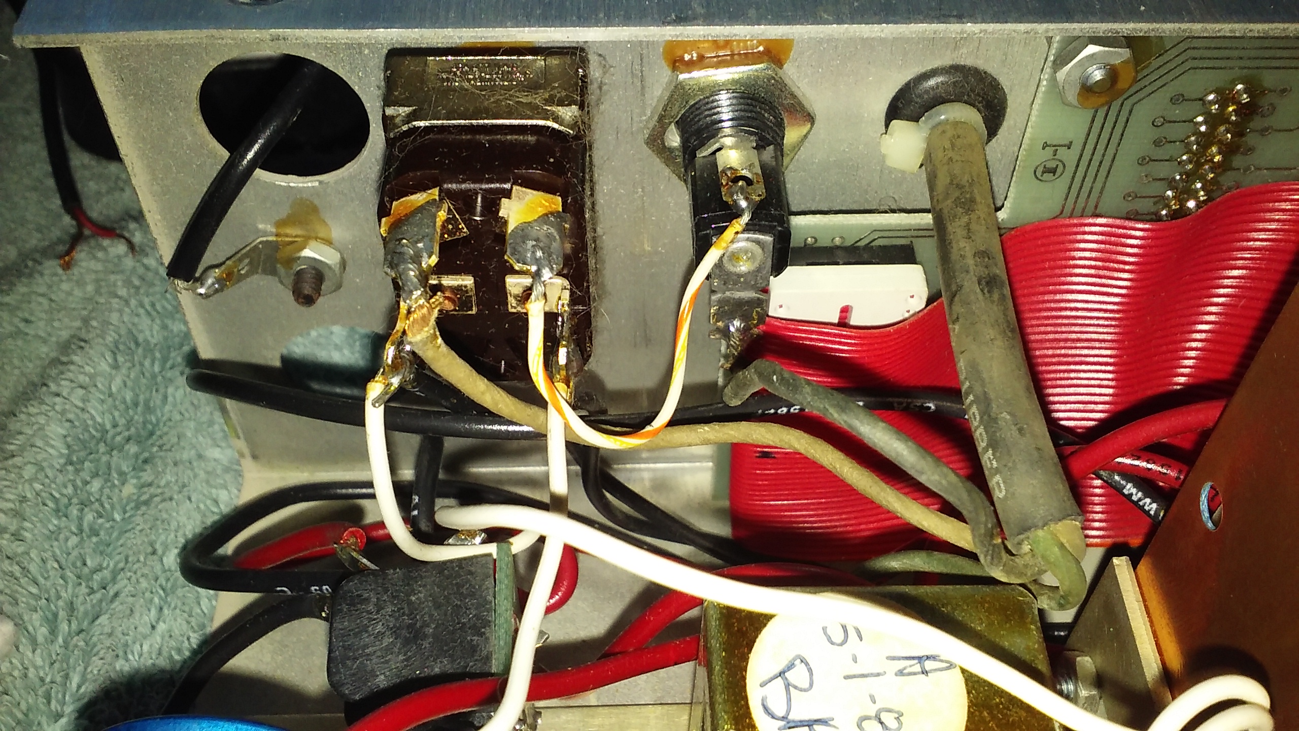

and finally, just the backside of the power switch and fuse wiring. The black wire going out of the top of the whole is a ground that was attached to the bottom of my floppy disk (back in those days, my house didn't have 3 prong plugs and I had a 30 ft ground going to a cold water pipe also). To the right of that is the back of the power switch. Interestingly, it appears the fan runs on 120V from following the wires.

Filter caps on the left power supply look like they are history. I'd replace all electrolytics in the power supplies while you are working on them, then re calibrate the potentiometer for 5v. I'd be suspicious that that is the reason for your fuse issue.

I agree with the above post about the caps--they look like they've had it. As already suggested, replace all caps, and check the voltages with all the boards removed. The LM723 regulators have been known to fail as well, so if the voltage is way off with the caps replace and no visibly burned parts, that's what I'd look at next.

Now I am stuck with lack of knowledge on the caps... Aside from being 10000uf and 16VDC (and at least tolerate 85C temps) , Are they Aluminum Electrolytic Capacitors ? Also, I can't find anymore that are configured the way the old ones are, that is, more like a D cell battery with + on one end and - on the other. I've filtered on axial, radial, snap-in and more. I don't expect to find an exact replacement, but i can't seem to find anything that at least would look "old style". If I have to, It looks like I could just get a Snap-In and run some extra wiring while soldering. Any Capacitor Replacement suggestions Dave, or anyone else of course?

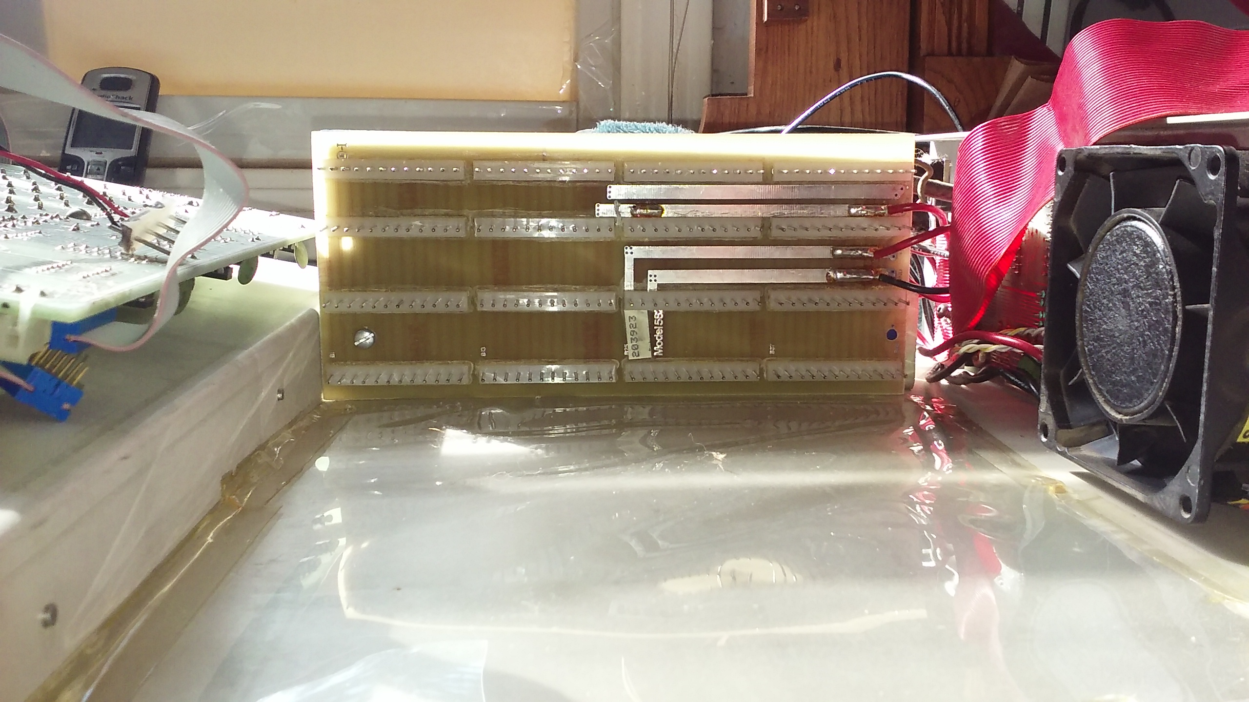

As promised, starting on a few shots of the system boards and I/O.

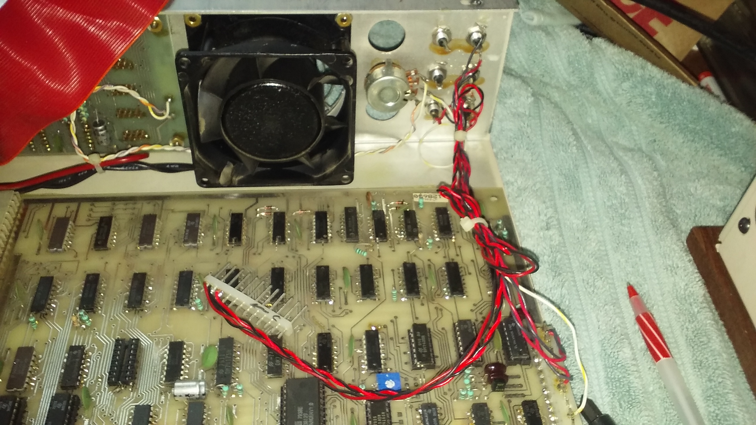

Shot of the video/audio/DAC/cassette (unused) hookups, the Color Adjustment, and the Fan. I will edit this text later to clarify what is what later. Does anybody want me to unbundle the wires going from the hookups to the Molex connecters and take another photo for clarity?

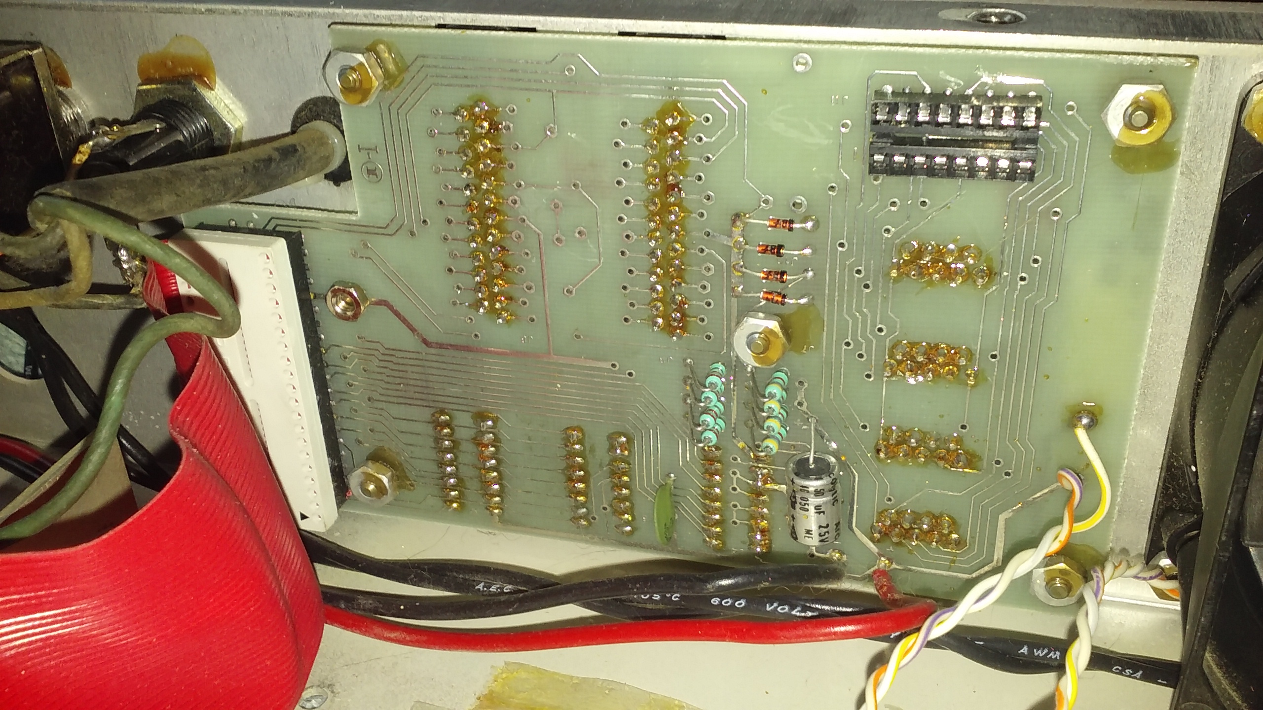

Shot of IO Board, serial ports, etc. Ditto on editing text to clarify later. Computer is upside down (applies to all photos shown in this post)
Outside shot of the ports corresponding to the C4P IO Circuit Board shown above. NOTE: the photo has been mirrored (see placard text) so that this photo can easily be compared to the above circuit board photo.
C4P-MF BackPlane (board 582)
UPDATED PHOTO. Much better shot that shows the hookup of the Backplane power rails to the PSUs. Just a bit of the 527 mem PSU is visible at bottom of the photo. Note the 2 black wires coming off the power switch on the back of the computer that run near the bottom of the IO Board to the fan.
I'll get to the PSU circuit board shots later. Just don't want to snip off the Caps until I know for sure that I'm trying to stay "stock". If I decide to go with a new mini PSU, I'll leave the PSUs as they are (for now).
