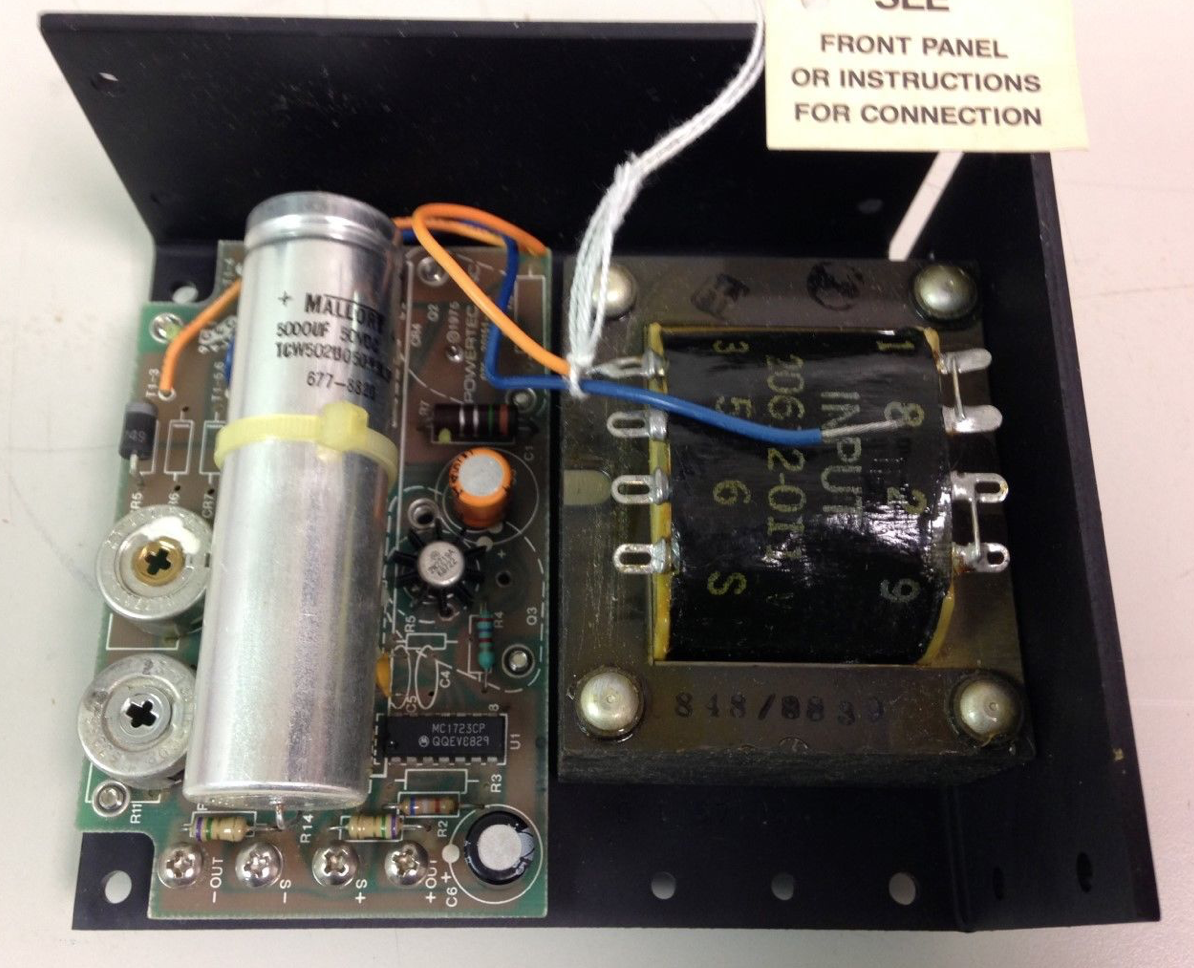

After disconnecting all power feeds to the drives and testing PSU outputs with multimeter, it looks as if the Powertec OEM II 2C24-2.3b is the problem. It is supposed to feed 24VDC to the drives but is now outputting 40.7VDC. Adjusting the VDC pot has no effect on the output voltage.

I’m good with soldering when I have step-by-step instructions but am a novice at diagnosing bas electronic components. Any thoughts on what component would fail such that the power supply continues to operate but with VDC well above spec?

I just pulled my 8" drive box down from the shelf and opened it up, and it has a different power supply, suppying both 5V and 24V.
I can't find the schematic for your Powertec supply, but I did find some pictures on the web showing a large transformer. Based on that, let's assume that this is a simple linear supply, without any current limiting, etc.
The 40VDC reading suggests the unregulated DC section is OK. A 28VAC transformer would produce peaks of 28*sqrt(2) = about 40V. For you to read 40VDC, the bridge rectifier circuit (either 4 hefty diodes or a thick black package with 4 pins) is OK, and probably the big filter cap as well. However, for power supply work, a scope is much more informative if you have one available, since you can see what the actual waveform looks like. If the caps are good, you will see a pretty steady DC voltage around 40V with only a bit of ripple.
A pass element will sit between the unregulated DC and the output. For supplies of that era, this would typically be a beefy NPN transistor in a TO-3 package. The pass element will be controlled by a regulator circuit, which could be a voltage reference and an op-amp, or a dedicated voltage controller IC with reference and op-amp in the same package.
Because the unregulated DC is showing up on the output, either the pass element failed (short-circuit), or the regulator failed. In the absence of misuse, it would be more common for the op-amp (or regulator) to fail first. So try replacing the op amp/voltage reg. If you see a single IC in the circuit, that would be it.
To tell which is the culprit, check the output of the regulator IC. For example:
- If you have an NPN pass element, and the output is high, then the regulator (op amp) failed, since it should be pulling the control voltage down to try to lower the output voltage.
- Again, for NPN pass element, if the output is low, then the pass transistor is shorted, and the regulator is working and trying (in vain) to reduce the output.

Thanks Dave for the in-depth explanation. I attached some pics. The power supply does use a TO-3 NPN (8828) and a voltage controller IC: MC1723CP. T

OK, the MC1723 is the same as the LM723 from national semiconductor, and others. Check pin 10 with your DMM, with the Ground lead at pin 7. This will give you the control voltage.
If pin 10 is near 0V, the transistor is failed in the short position. If the regulator failed with output at 0V, then you'd have 0V output from the supply.
If pin 10 is greater than 1V, then the LM723 has failed (since again, if the NPN failed open, which is quite rare, you'd read 0V at the output of the supply.)
Re: Power problems with C8P DF drives
The transistor is actually a 10-19655-2. You may have trouble finding an exact replacement. The NTE284 is listed as a replacement, and it's stocked at Newark and Allied Electronics, but it's kind of pricey, about $14 + shipping.
You could substitute another TO-3 NPN transistor with VCEmax of 100v or greater, Current rating of 10A or greater (for margin), and lower hFE (at least 30 min), and save a few bucks. If I had one in my junk bin, or found one at my local surplus shop, I'd use it. But if I had to buy new and pay shipping, I'd just spend the $10 extra and get the NTE284.
The LM723, MC1723, or equivalent, you can get from just about anywhere.

I took a reading at pin 10 (ground pin 7) and got 32.5VDC. I triple-checked that I was touching the right pins but will try again tomorrow when I've liberated the PSU from the OSI 8" DF case and can get a better angle. So far, here's what I'm finding:
120VAC going into the transformer (coil). 31VAC coming out of the coil. Regulator IC shows 32.5VDC. Ultimate voltage out is 40.7VDC when it should be 24VDC.
