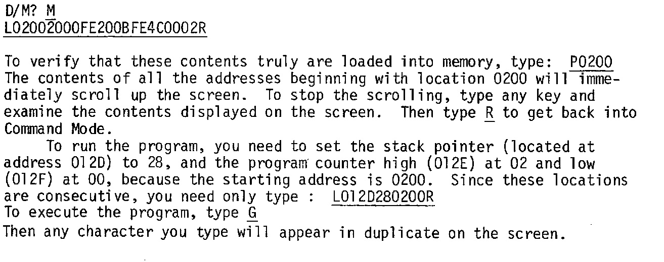

The c3 monitor 65a is very limited commands if you have D/H/M it probably working
L = load address
R = return
P = list memory content
G = Run
also to use go the stack pointer and program counter need to be set, here is a example .
CAPS LOCK ON
Let us know how it goes

The problem is that i cant write any letters from the terminal. So i cant write M to get into the machinecode monitor. When i write M the osi system makes a CR and no M. I can fix a video that explain the problem... :D
Posts: 237
Re: Starting up a C3 oem. Problems...
Did you try P000 after the return, we know the tx is working ,Do you have a pc with a serial port to try and use a terminal program,
What type of terminal are you using, be sure caps lock is on
