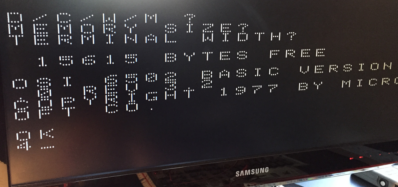

I thnik I have an issue with my output video signal
I attach a photo I think you can see the problem.
Is it normal the gaps between pixels?
Thanks in advance!

Double checking the 600 Rev D schematics in the repository, it's supposed to be that way. The output of the video shift register is ANDed with a pulse derived from the system clock, called "Dot Shape" on the 540 boards, and "DB" (dot blank?) on the 600 board. It's derived from the crystal oscillator, so it's a fraction (1/4 or 1/2) the duration of the dot (depending on 32- or 64-char mode) and appears to be the same regardless of 32- or 64- column mode, so it might look more pronounced in 32-column mode.
I remember first seeing this when I converted a GoldStar 12-inch TV for a friend. I hadn't noticed it on my converted Boshei TV because the video amp of the Goldstart had a higher bandwidth. Modern LCD monitors have a much higher bandwidth, so you'll see the blanking very crisply. If you want to stretch the pulse, you could replace the U62 inverter with a 74ls123, or similar. Or, you could hang a small capacitor across the video out to smear the dots a bit. Or, switch to an old fashioned CRT monitor. . .

Re: Bad video output? But why?
By that, I mean route the signal to a 74ls123 one shot, and use the /Q output for the DB signal, instead of routing the signal through the inverter gate in U62.
Cheers,
Or, try cutting the trace between pin 8 of the U18 inverter and pin 18 input of the NAND at U56, and tie pin 18 of U56 high (with a 10k pullup). I'm not sure what artifacts the dot blanking signal is suppressing, but it may be worth a try.
