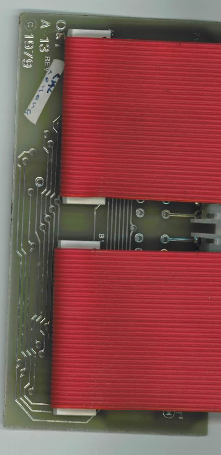

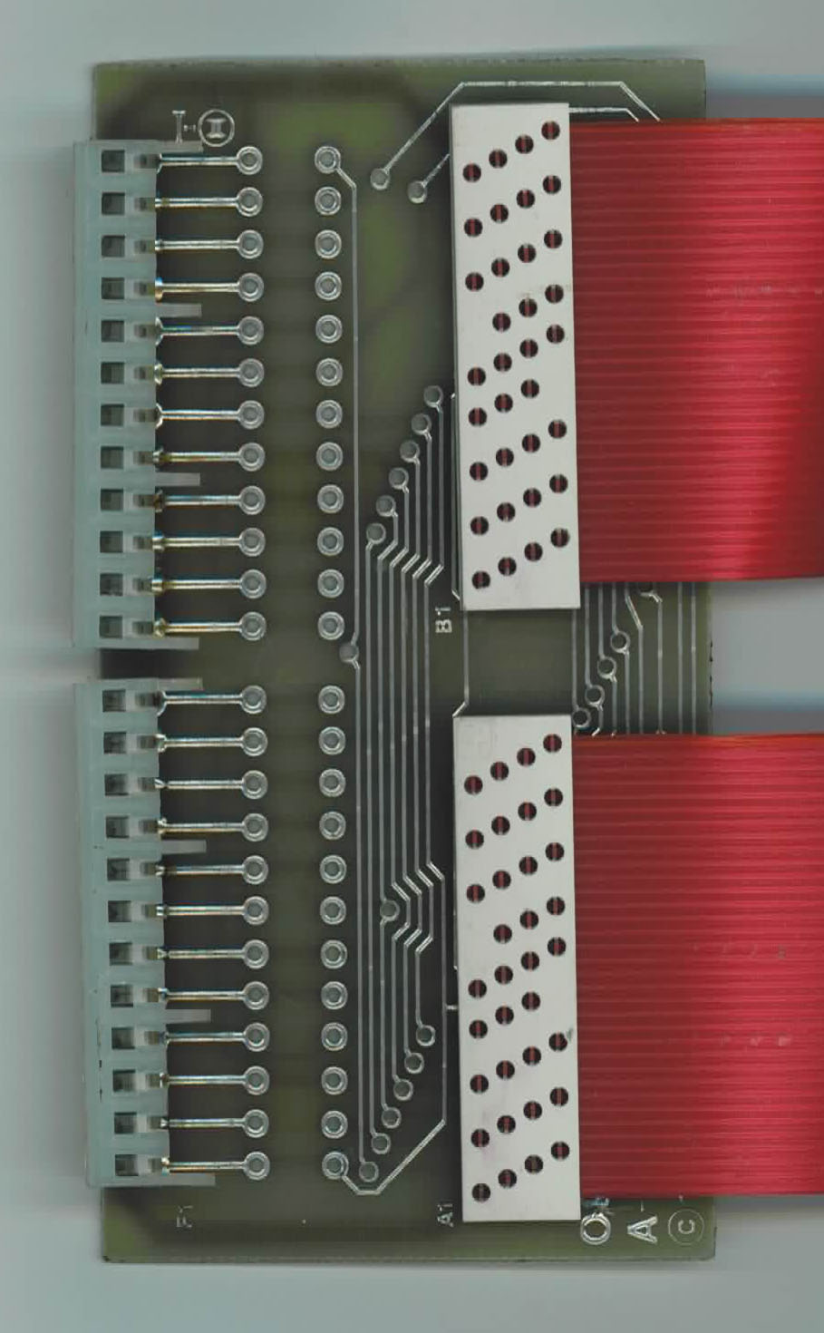

Hi Philip,
Since my floppy is not currently plugged in to my C2, I was able to scan the A13 board for you. Also, you can check out the bare-board image on Mark's web site
The A13 board looks pretty much like the home-made floppy connector you got with your unit, except that the cables are terminated with the 34-pin edge-card connectors for the shugart standard 5.25" floppy drives. If you have to make an adapter board, I'd suggest plunking down a couple of the 12-pin molex connectors to match your 505 card, and a couple of 34-pin headers to match the standard drive pinout, then match pins and route. That would probably be easier than trying to follow the scans. While you are at it, you could probably throw a data separator right onto the board, and not have to wire one up separately. I was planning on doing the same thing myself, since my OSI floppy needs repair or replacement, but will have to wait until my current project is off to the fab house. Of course, if you do it first, that would be awesome.

- A13-3.jpg (119.87 KiB) Viewed 14014 times
- A13-2.jpg (146.07 KiB) Viewed 14014 times
- A13-1.jpg (154.41 KiB) Viewed 14014 times

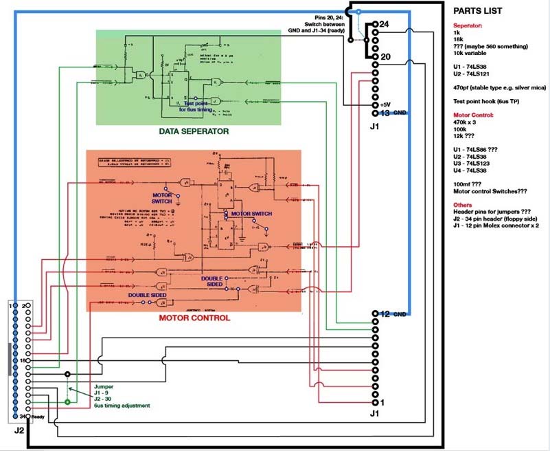

I'm in the same boat... I recently bought a 505 board with no a13 board. I could use a couple boards with data sep circuit and standard connector. I do have some basic eagle cad skills so I could help out if needed.
Re: WTD: A13 card or detailed pictures/schematics etc.
Hi Steve,
If I could draw up a rough (very rough hand drawn) schematic will all the right connections, switches and jumpers, would you be able to transfer this to Eagle and layout a board design that we could get fabricated?

Sure, I'm willing to give it a shot. I've been reading the PEEK65 articles and it would be great to get some high density drives connected.nama wrote:Hi Steve,
Unfortunately thats all I can offer considering my lack of PCB layout skill.

As promised here is the first pass at a schematic for the floppy adaptor:
I told you it was going too be rough.
Some questions still remain:
- Why are there two motor control switches?
- Some component names can't be read because the text in the PEEK65 article is too distorted/small.
- The article says to connect pin 22 and 24 to GND or the READY line (I made it jumper selectable). However the schematic shows PIN 20 and 24!!!.
- Not sure what to do with the 'double sided' areas on the motor control. Should they be user definable jumpers, or hard wired for double sided?
- And the biggest question of all is. Have I done it right or am I way off???
Note:
Motor control section it mirrored so that it fits in my schematic easier.
+5V and GND on the motor control section are not shown hooked up to J1-14 to make the illustration less complex.
