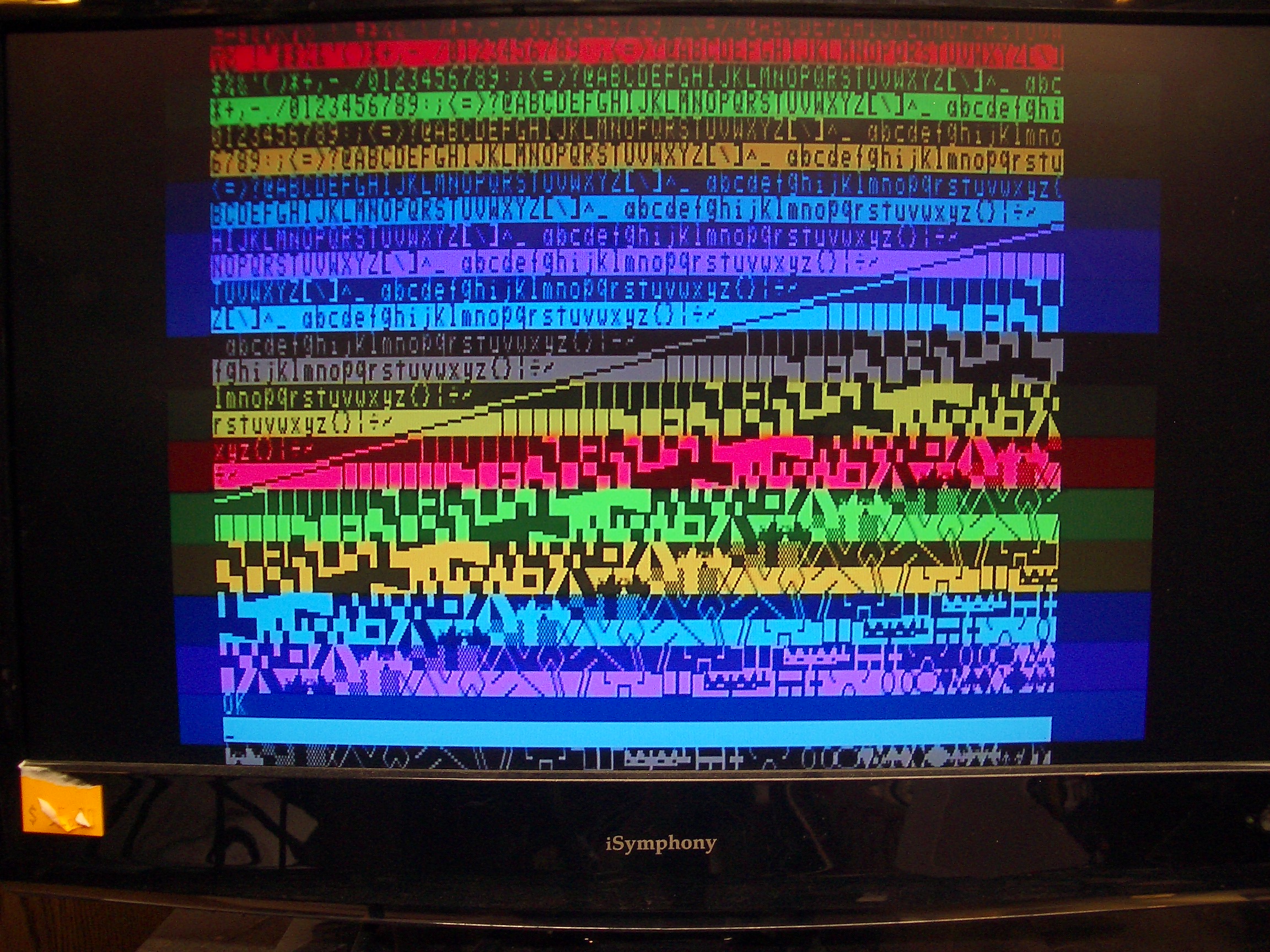

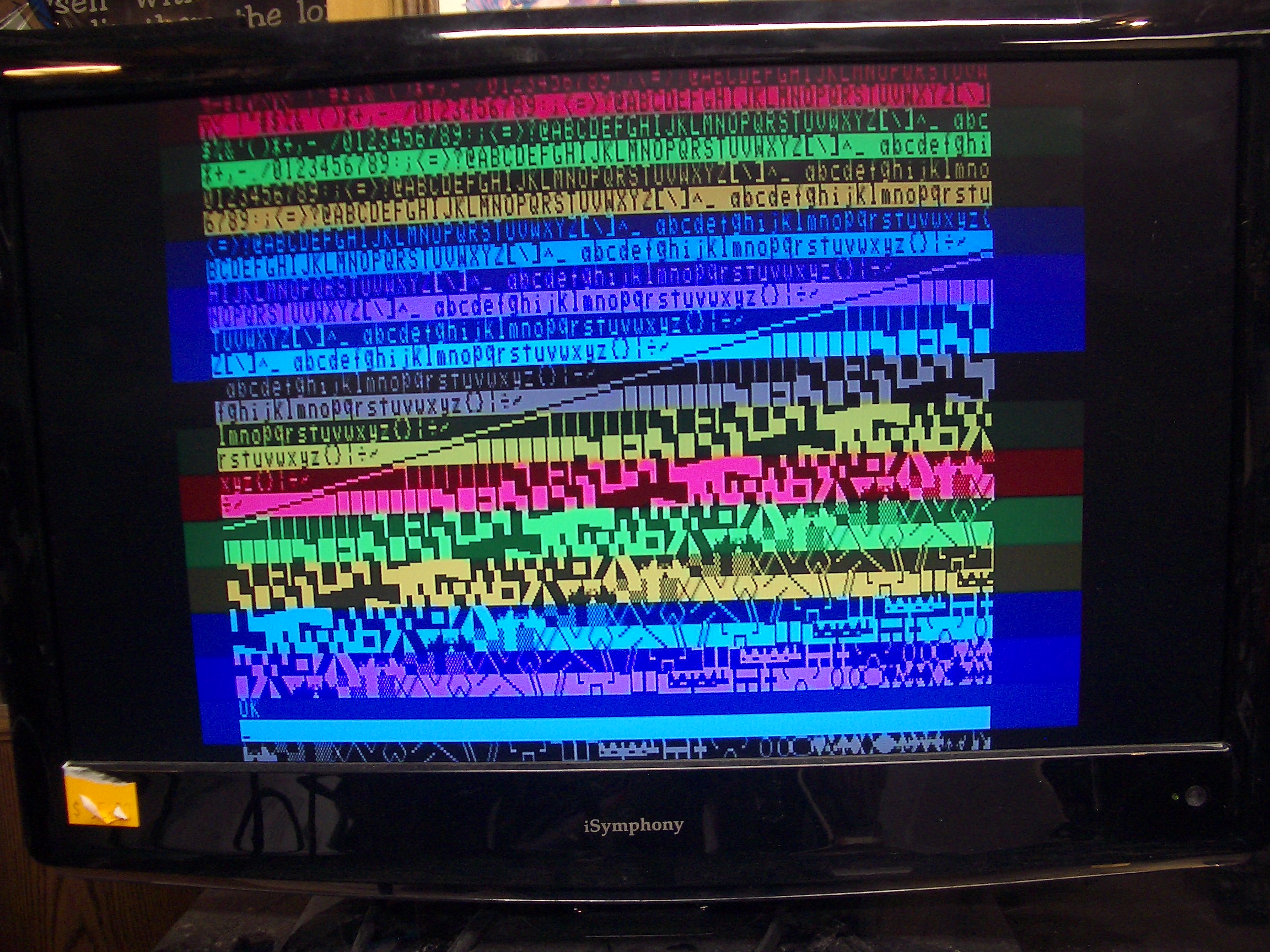

Re: Crystal for 540B Display board
As a test I swapped in a 12.09MHz crystal for an original OSI 12.083915MHZ crystal on an original OSI 540B with no appreciable difference in display. The slight differences in the pictures are due to my ancient digital camera trying to adjust color balance and autofocus. The display is a "modern" digital LCD TV which works fine with OSI color output on or off. Generally I use a 9" B&W security monitor for the display.
In case you want the BASIC program that made this display:
fillcolor.bas
OSI BASIC program
540B Color display test
(233 Bytes) Downloaded 572 times
