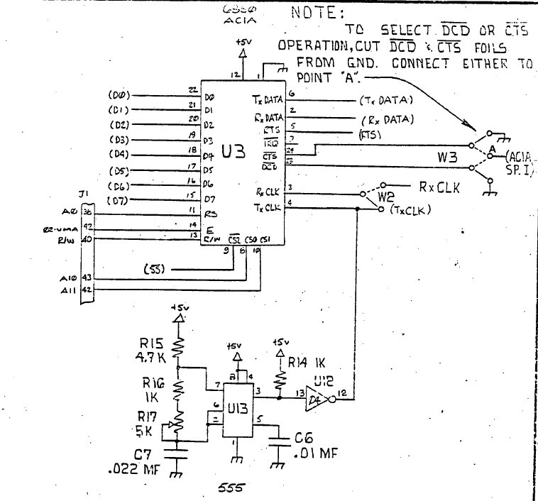

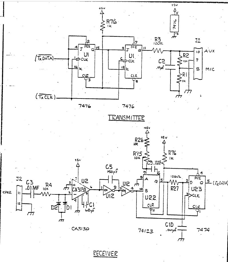

OSI used the circuit seen in the OSI 502 schematics:
They used a 555 timer running at ~4800hz as the clock to the ACIA. The ACIA internally is set to divide the clock by 16, giving you a 300bps data rate. I'm not an EE, but from what I understand:
For transmit, the 4800hz clock is sent to a pair of 7476 J-K flip flops to divide the 4800hz clock by 2 or 4 depending on the state of the TxD bit giving you the 2400hz or 1200hz tones.
For receive, after reducing, ac coupling, and clamping input, a CA3130 op-amp is used to boost the signal. 2 inverters are used to filter the input, a 74123 is set up as a frequency detector along with a flip flop which decodes the incoming signal as 1 for 2400hz, 0 for 1200hz sent to RxD, which is asynchronously looking for the start bit at 300bps

I never even noticed that there was a 555 in my C1P. So it looks like the 7476 created a square wave and there's a simple low pass filter to get it something close to a sine wave. I don't quite understand how the 74123 and does the decoding for the flip flop to flip flop. Did you have to tune R75 to the right frequency (range)? Is the CA3130 doing any filtering of the audio?

Re: How did the cassette interface work?
Scott-
Short Answer: R75 has to be adjusted for the correct pulse width output of U22.
Long Winded Answer:
Bear with me, it's been a long time since I experimented with this in college.
As Mark said, D1 & D2 clip the AC sine wave to the CA3130.
The rising and falling edges of this pulse are not "clean". It is a sine wave clipped off at approx. 0.7 volts, so the rise and fall times are sloped.
Since there is no feedback on the CA3130, it goes from ground to +5v and back, and has that same slope as the input signal.
The 7404s clean up the rise and fall times of the 5v signal.
Now the 74123 comes into play. It is one-shot monostable multi-vibrator. It generates a output pulse on the rising edge at the B input. The width of that pulse is determined by R75, R26 and C9.
That output pulse is low-pass filtered by R27 and C10, and fed to the flip-flop (U23). Since the flip-flop is clocked by the same trigger as U22, the RxData line will turn on whenever there is an edge at pin B. The width of this pulse is effectively determined by R75.
Long Winded Answer:
