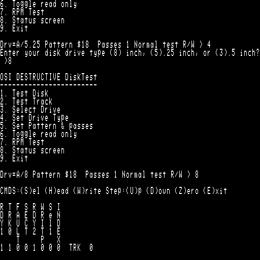

Upon 'D' from the boot prompt, the OSI will step the head up one and then down repeatedly until track 0 signal is active. Since you can boot with the head moved to track 0 it's likely the problem lies with the stepper circuitry since TRK0 must be active to boot. Also when the head is not over track 0 the 'D' command will continuously send step down signals until TRK0 is active.
David Gesswein's floppy disk test program has a "Status" command that lets you manipulate head position manually up & down & view port bits which may aid you in solving the problem. (S)elect the drive & Step (U)p or (D)own.
There is a bootable disk image include in the archive on my OSI Tools page which you could convert to HFE, or you can load it from serial port.
After booting you can interact with it on the OSI or via serial.
One of my 8" drives had 1 output pin of the LSI chip spontaneously die (part of the select logic) which I was fortunate to fix with a couple TTL gates in its place.

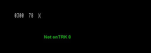

Or you can use the attached code to view the status of disk PIA PORT-A. It just initializes the disk PIA, selects the drive & shows the port status TRK0 bit as a graphics character on the screen near the monitor HEX line. (Reset the OSI, Press M, Press L & send the DispPortA.lod file via serial, or enter bytes manually perhaps).
My guess is if trk 0 is always active, you will see the "racecar" / graphics character 0 no matter where the head is located. The )( character shows the Trk 0 signal is inactive. (Floppy signals are inverted/active low).

I finally got around to checking the track zero test points and the status of the PIA Port-A signal using the piece of code you wrote back in November. Here's what I find:
-Regardless of the position of the R/W head on the 8" drive, TPA-2 shows 5V.
-Regardless of the position of the R/W head, TPA-4 shows 0.6-0.7V
-Whatever the position of the R/W head the PIA monitoring code reports that head is on track zero (track zero active)
-Once 65D is loaded (after manually positioning the R/W head at the track zero stops), I can exit into the kernal and use the DIR TT command to move the R/W head up and down tracks. This suggests Q10-Q12 are okay
-If I use the HO command, the R/W head moves up a track (from whatever current position it is in) and then there is no further drive activity
Is this definitive evidence that the issue is the track zero sensor or could there be something going on with the LSI chip?
I have a spare track zero sensor and a spare LSI chip but don't know if either is working.
Tom
