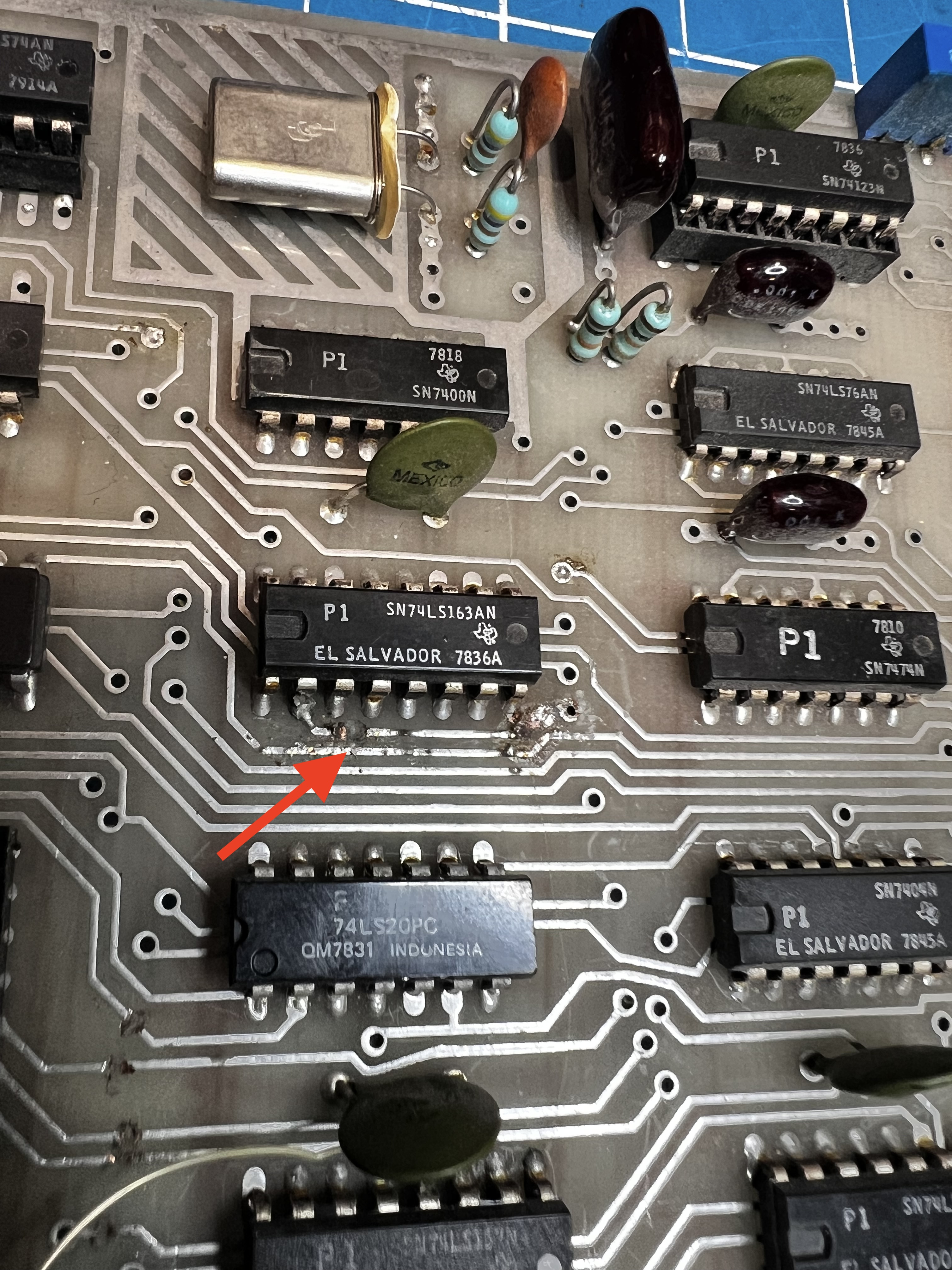

I just had a look at the board and sure enough, the trace is cut at U57 pin 2 and jumping over to U30 pin 11. Is that 600 baud?
And yes it looks like that cut trace is going to U53 pin 6 / U59 pin 14
- IMG_7553.jpeg (2.72 MiB) Viewed 4293 times
- IMG_7554.jpeg (3.2 MiB) Viewed 4293 times
