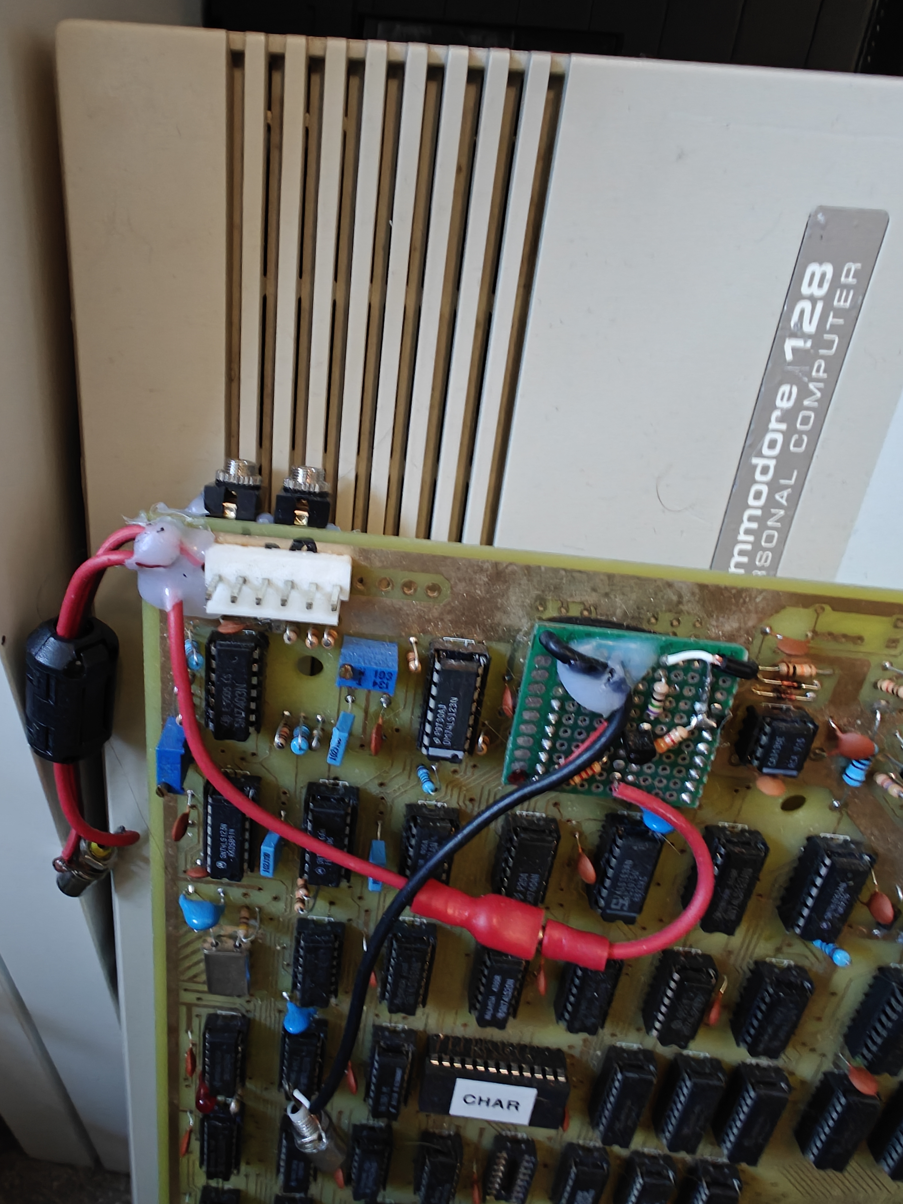

I did have a few sync issues with mine, plus a few other video and other weird problems, my build thread is here: viewtopic.php?t=845
I don't know if it'll help, but it may be worth a read.
I added a single transistor buffer to mine so I have both standard and buffered composite.
I do find that some screens work fine and others are tetchy, I only have one CRT with composite, a 5 inch B&W display and that seems OK, but for some of my other composite displays the sync isn't great, though it may be because my displays are mostly PAL and IIRC the Klyball replica uses NTSC composite. Someone please correct me if I have that wrong.
Adjustment of R58 did help me quite a bit.
