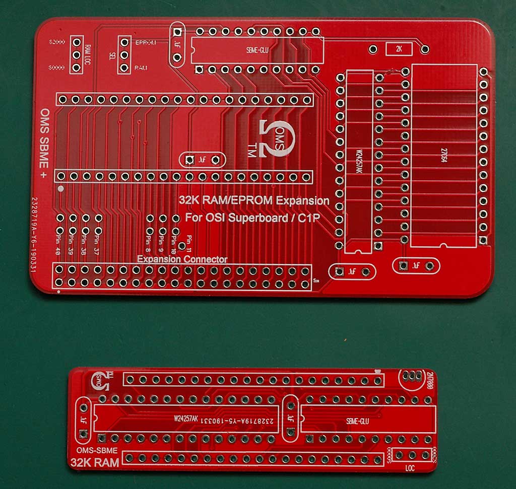

The new red boards. Same deal as before (see first post in this topic). For now, if you want one, just contact me through the PM system on this site. I will eventually out them up on my web store, but it may take a day or two.

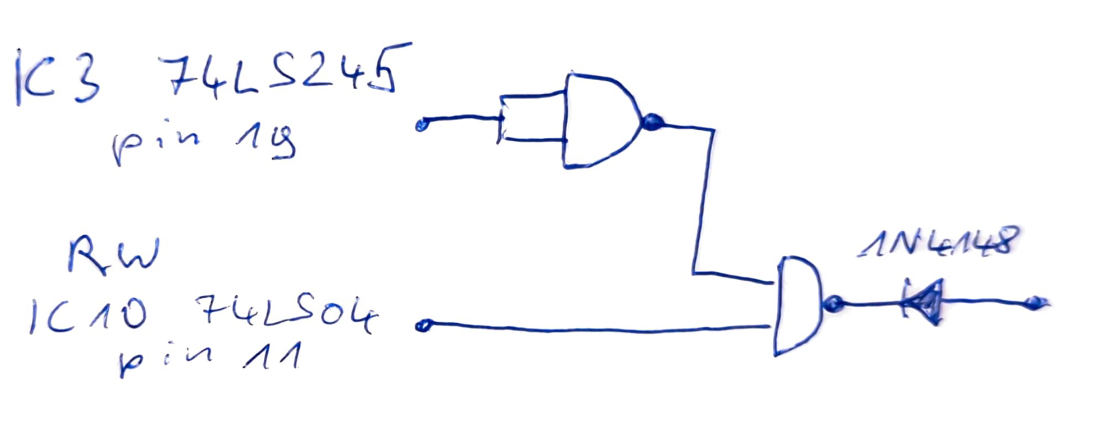

Re: Sunday with my SuperBoard II
This is the sketch for the circuit that I built:
The anode of the diode is supposed to be the DD signal. The IC names and pins refer to the circuit drawing from http://bartvoip.co.uk//floppy.htm linked below.
IC 3 pin 19 is low when the address range of the controller board is addressed.
IC 10 pin 11 is directly the R/W line from the C1P expansion port.
The two NAND gates in my sketch are from a 7400 chip.
That actually looks fine.
You could also try to get Phi2 involved. Bring pin 19 of IC3 to one input of that first NAND gate and bring pin 5 of IC 10 (Phi2) to the other. The rest of the circuit is fine. But it should not really be required in this case.
So you are using the smaller of the two RAM boards, the one without the ROM?
Thanks, I will try that next, but probably not before next weekend.
Yes, I'm using the smaller board without ROM.
That one actually just passes the DD line straight through.
