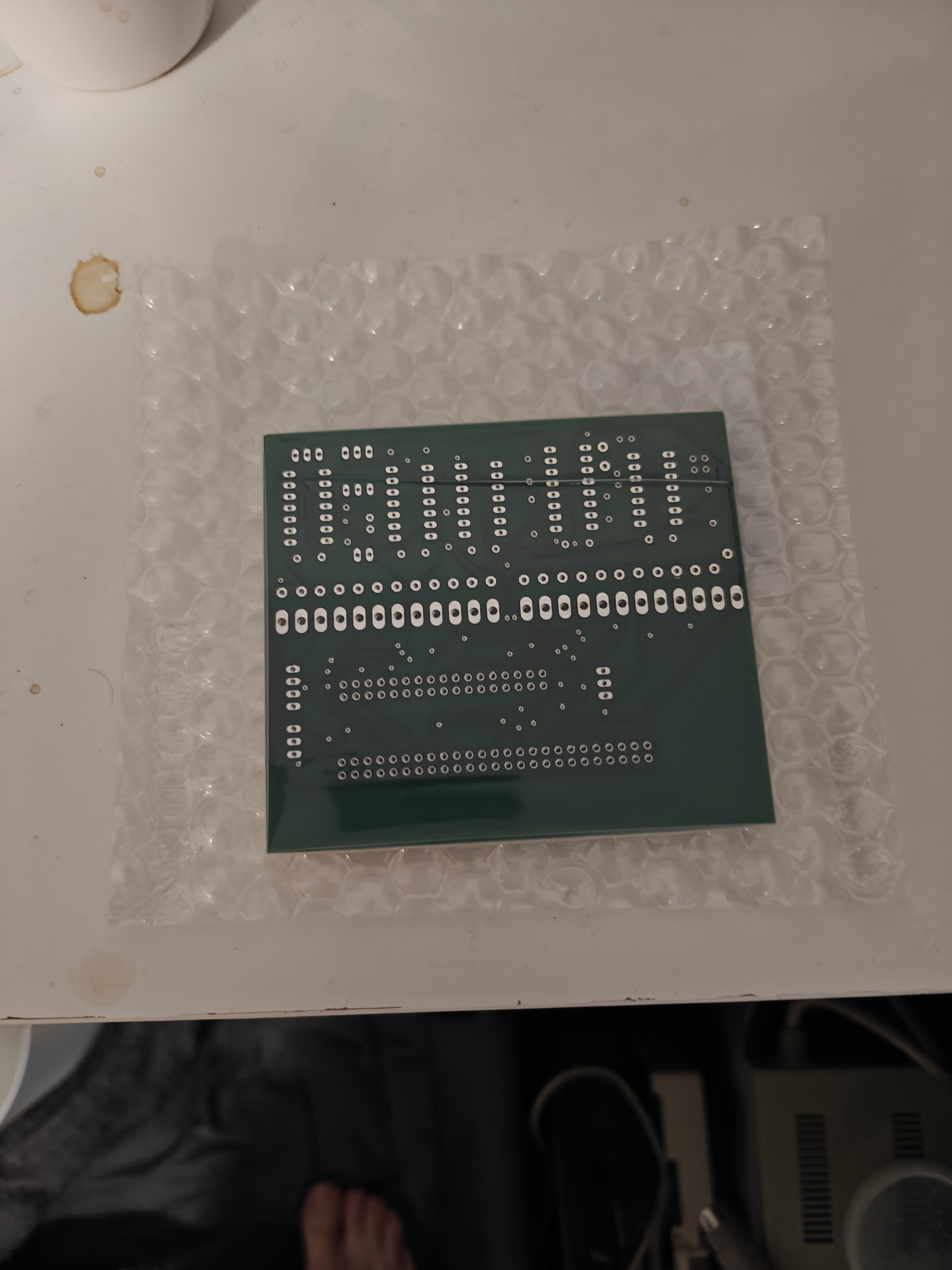

Well, my data separator boards are on the way :)
Great!

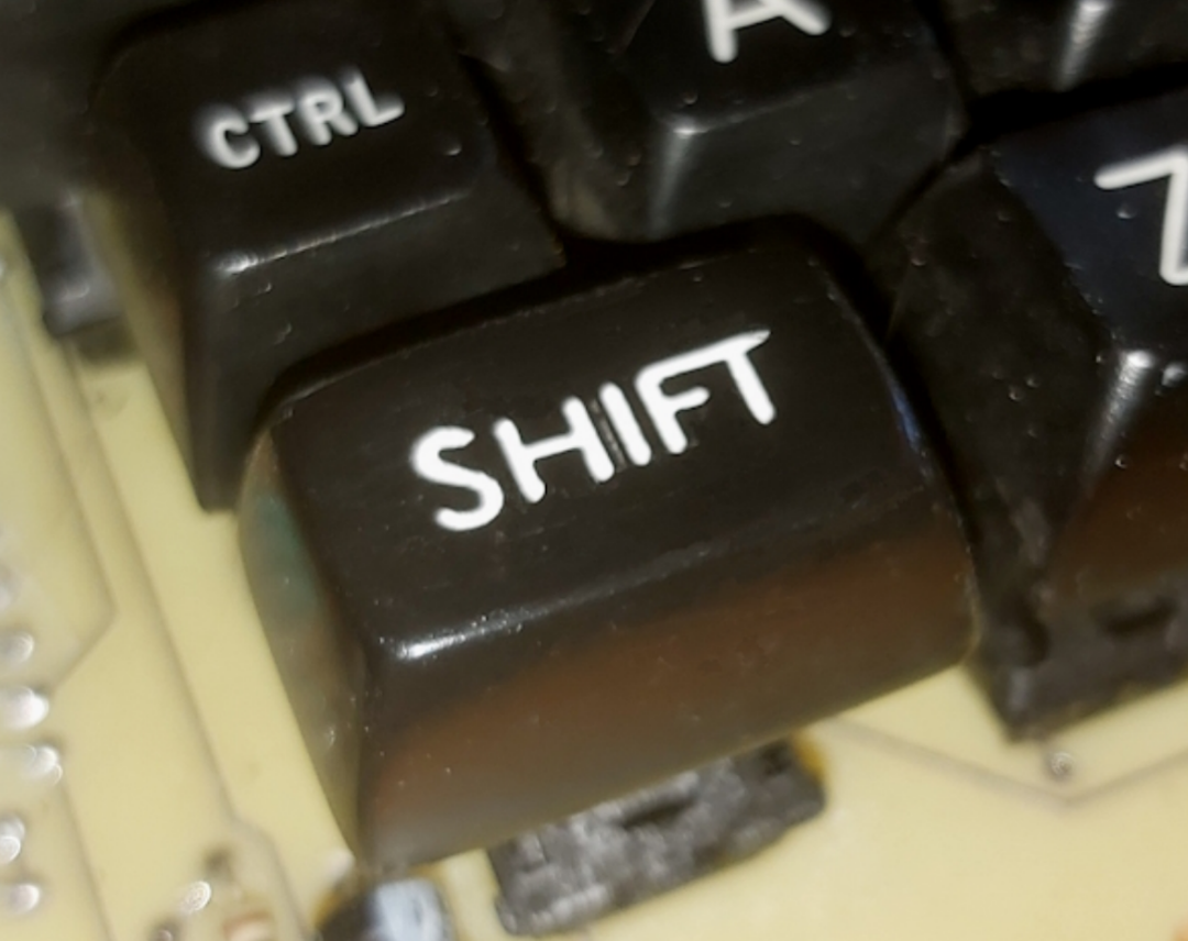

Finishing up the design of my C1P MF case, I remembered that my keyboard needs "double" sized shift keys....
(the keyboard that I harvested the key-caps from had "single" sized shift keys...)
I designed the key-cap in Solidworks, the "SHIFT" letters are about 1/32" deep...
Then, out with the 3D printer...
Some light sanding with 800grit water paper...
followed by a light coat of Rustoleum "rattle can" gloss black paint.
But how to get the "SHIFT" characters white???
TALCUM POWDER! (then a coat of clear) :mrgreen:
Look what arrived today :
Looks like I'm running out of excuses to build the 610...
That was fast !

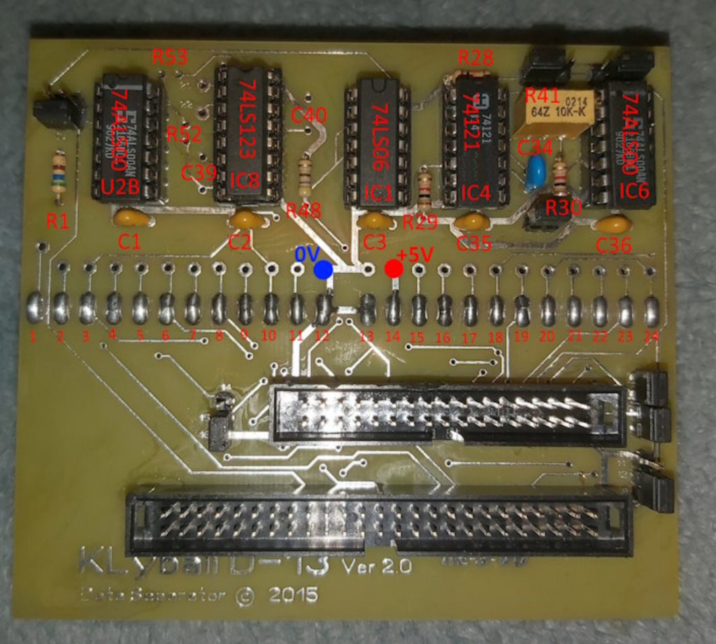

Here is the component layout....
D-13 Components.png (1.22 MiB) Viewed 23084 times
The red elipses in the picture below are the jumper settings that work for me...
Do this to set the one-shot timer to 6uS. (with jumpers in place)
In the above photo, the jumper on the bottom right was incorrect, it should be 11 to 12 (as shown below)
SETTING one-shot to 6uS.jpg (807.64 KiB) Viewed 23100 times

HOWARDHB wrote: Tue Dec 03, 2024 6:31 am That was fast !
In the above photo, the jumper on the bottom right was incorrect, it should be 11 to 12, as shown below)
That's awesome, thank you sir :)
