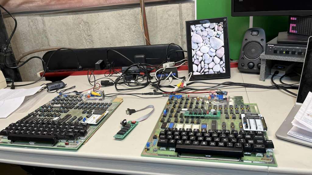

Wow, long time. Seems covid put a lot of plans on hold including my 600D colour board. Walter and I built a board and tried to get it working but had some difficulty. Shortly after I had a mishap and suffered a detached retina in one eye, followed by surgery, then my mom passed away, and then Covid hit. Since then I have just not been able to get back to the project until now. Yesterday Walter and I worked on it again and got some results. The board works! I did get the labelling of the DIP switch colours wrong which caused some initial confusion but we finally figured it out. So we connected the board output to a VGA connector and then to my Dell monitor that supports 15kHz. Walter's machine had a version of my customized CEGMON ROM which we used to test. I found that the 330ohm resistors seemed to make the video a bit dim so they may need to be adjusted, or it could be my monitor (more testing is needed). Below are some photos:
