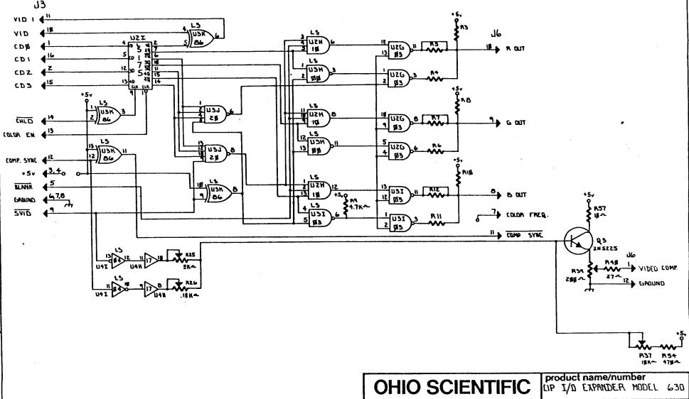

I am thinking of building this RGB colour and composite video interface for the SeriesII RevD 600 board. 9 Chips are required plus 2114 ram in free socket on the RevD. Plugs to existing socket on RevD.
How much of this could be done in PALs ?. Am I right the open collector gates would have to be separate LS03's. Can the LS157 logic be done with a PAL and are they OK at video frequencies ? The composite output should give better video than existing Superboard gate output.Bonus.

RevD board requires 8T28 and additional 2114 RAM. Colour IF connects to J75.
But what's going on at R5,R7 and R12. I suspect they should be variable ? 220R ? 5K ?
R3,R8,R10 perhaps 4K7
It's also going to need separate HS and VS to drive PC type DVI with a differential analog chip O/P maybe. Its getting complicated.

630 Colour 600RevD
Kicad me please. RevD in colour.
I'm a little confused here. Does 0/1 not give yellow char on black and black on yellow. 14/15 white on black and black on white. Giving you a white ?

The Superboard Rev D only has RGB and Invert. It seems the 630 board tries to emulate the 540B but has no NTSC clock so I'm not sure how accurately it emulates it.
As far as I can tell both systems use the invert bit to invert the pixel colour. It appears that in normal mode you have a bright pixels for "1" bits and darker pixels of the same colour for "0" bits. When the invert bit is "1" you get dark pixels on a bright background.
On 540B composite , when colour bits are "0000" you get yellow on dark yellow (or very close to black). There is no "white". There is a "black" and also a "no colour" (according to the manual):
As for the 630 the circuit is a bit convoluted but it seems to have circuitry to detect "0000" and change it to yellow. There are resistors to modify the output levels. I don't pretend to be able to follow it right now and I've never seen a 630 board or it's output, so it's hard to know for sure how things work.
Here is my current circuit. I tried to give the option to simulate the OSI way, or normal RGB way. It currently does not support monochrome-only output (ie: when colour is NOT enabled via the control register):

Also, correct me if I'm wrong but won't the 630 composite output also be in monochrome? I don't see how it could be colour. It does seem to handle the inverse line so it's still a bit of improvement over the 600 composite.
Re: Superboard Colour RGB and composite interface
Yes the composite output is NOT ! colour on 630D. Are you going to add to your design ?

I have an updated schematic that fixes some things, adds the monochrome-only display to the RGB output, and has some extra info. The circuit is now 4 chips...
Once we get to RGB we can then add an MC1377 chip to generate colour composite. Walter and I will try to breadboard that too.
Here is the latest version: Steve

I've been looking at what additions would be required to make your design work with a RevB and 540 mono. Maybe add 1*2114 and plug into one existing 2114 VRAM socket and a link to address decode...
RevB:
8T28
2114
VID U70-2 existing
CHLD decode *
COLEN decode *
CSYNC U70-11 existing
BLANK U62-10 (DB) existing
SVID U70-3 existing
540 mono:
8T28
2 * 2114
LS00
LS86
VID existing
CHLD decode *
COLEN decode *
CSYNC U4D-6 existing
BLANK U3G-12 existing
SVID non existing
540 mono looks like would need own dedicated pcb but I think RevB would be doable with additions to your evolving design?
