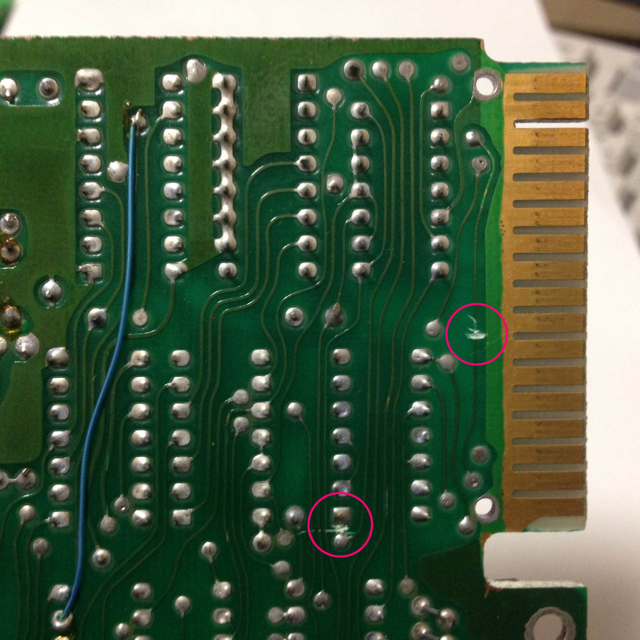

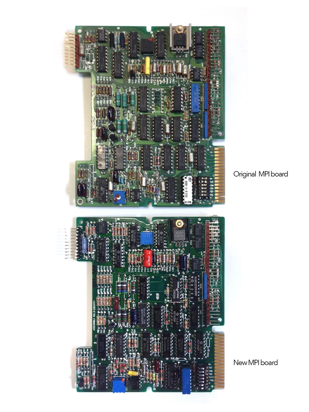

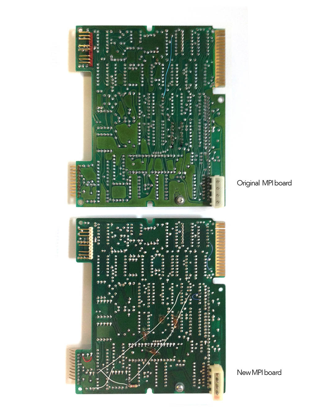

Firstly I compared the boards from both my MPI drives boards. There are very small differences, but not much and there are some jumper wires placed on the back of both that are different between boards. So I went ahead and cut the trace that Dave mentioned. The board from my non working MPI drive had this trace cut. However plugging the new drive back into the OSI still resulted in a no boot.
Apart from the differences with the jumper wires between the two boards, another place where there was an obvious difference is a cut trace from pin 32 of the floppy connector. I have indicated it on the attached photo (this one of the original board). Both boards had this line cut, but the new board then had a jumper installed taking the line to another part of the board. I believe this maybe the side select line, so maybe it's not important.
Well, thats where I am at. Not sure how to proceed, Maybe it is easiest to try to find the issue with the old MPI motherboard, or try to get the new MPI drive working with the OSI, both directions are valid…but which has the best chance of success.

- Old board cuts.jpg (225.39 KiB) Viewed 7748 times
- Solder side.jpg (167.68 KiB) Viewed 7748 times
- Component side.jpg (191.15 KiB) Viewed 7748 times

Finally got this drive working with my OSI. Basically I left all the new MPI board jumpers intact, except I matched the area around J1 to the old board with jumpers and a cut trace. The drive however doesn't seem quite as reliable as the original, but I think thats probably just a very slight alignment issue.
