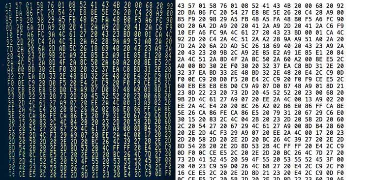

After literally 4 years working on getting my 4P disk system running, I believe I'm almost there.
Today I was able to compare track 1 of a downloaded disk image (OS65D32.img) from the net, with the contents dumped from track 1 of my corrupt OS65D disk (track 0 is corrupted on this floppy unfortunately). Please see image. The left side shows the dump from the 4P and MPI drive, and the right shows the downloaded disk image. Perfect match.
Now I can be fairly confident that my MPI drive and data splitter are working. This is a huge step forward for me considering how many parts (mechanical and electronic) I've had to repair and replace on this drive.
So, now all I need is a working OS65D 5.25" boot floppy for a C2 or C4 system. Is there anyone on this planet who has a working system that could make me a floppy or two?

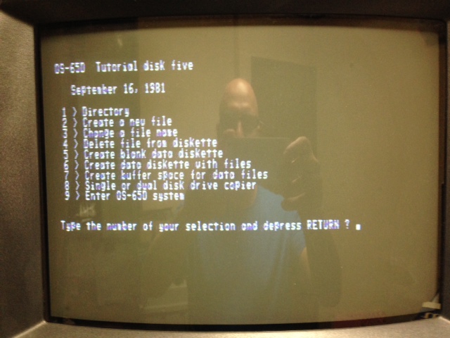

I gave up on the D&N board in my C2 for the time being. It definitely has some WRITE issues. Instead I moved over to my C4 and now, with Mikes help, I was finally able to patch in a new track 0 on my corrupt OS65D floppy...the results:
It's only taken 4+ years to get to this stage...If I knew it was going to be so difficult, I probably wouldn't have even started.
Much thanks to all those who have helped and added support over this time, especially to Dave and Mike.
